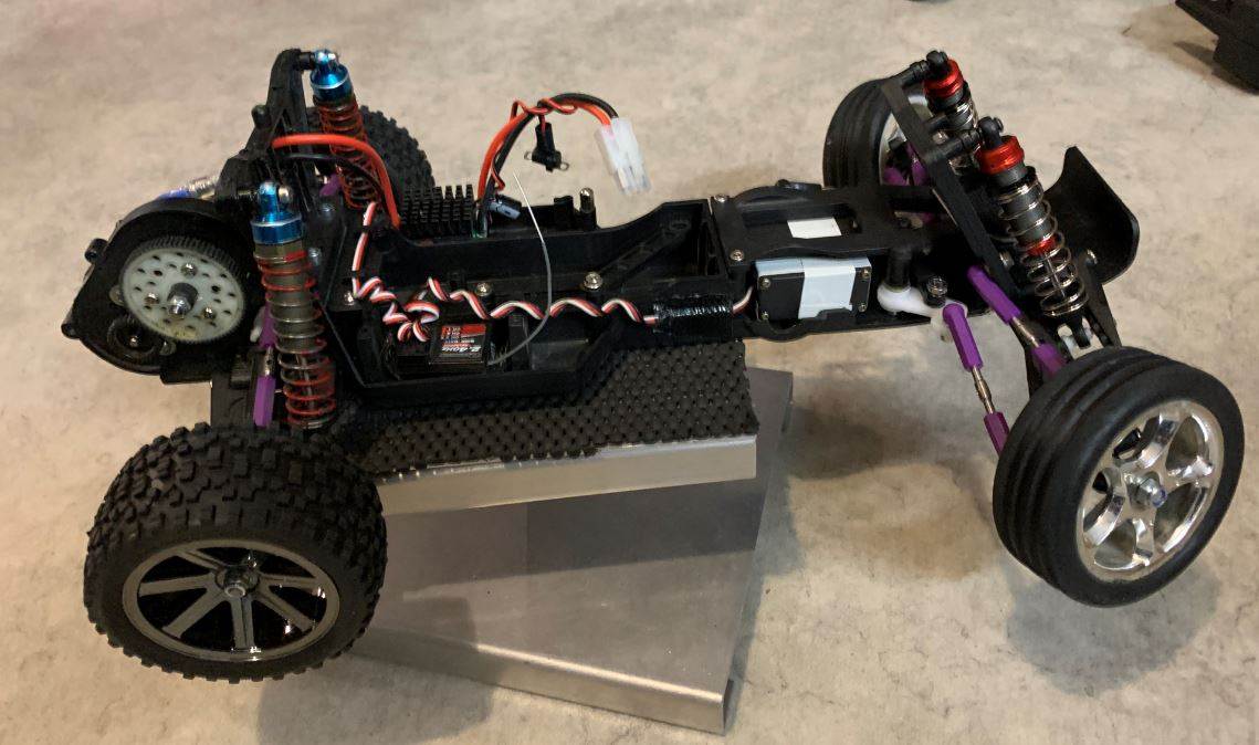

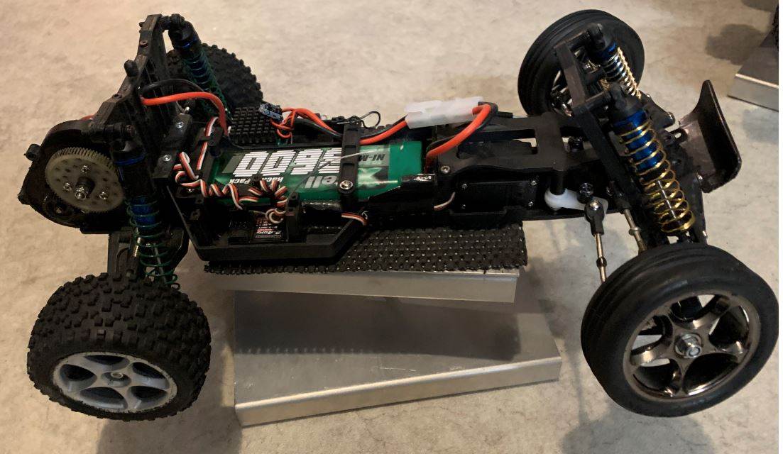

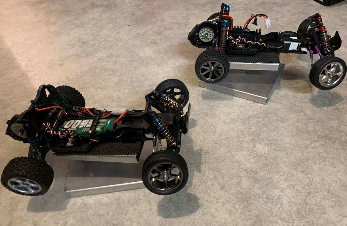

Re: Graupner Radicator Experts
OKAY OKAY,
you got me.
Here are my kids 2 Radicator 2s.
I also have 2 Radicator (1) Experts both currently not in presentable condition.
Big pinion small spur... they must be really fast!
You need to cover up those gears though; for your kids fingers sake and for the sake of the spurs. They are harder and harder to get (the spurs of course, kids are not as hard to get obviously
- Posts: 620
- Has thanked: 51 times
- Been thanked: 108 times
Thanks for the concern.
These cars are running with 55T Brushed motors. The smaller pinion was too small.
So they are not that fast.
I chose those motors specifically to get the kids on a learning curve.
Next step are the 45T Motors.
The standard cover does not fit over those giant pinions.
The RPM Bandit / Rustler covers are in an online shopping cart.
