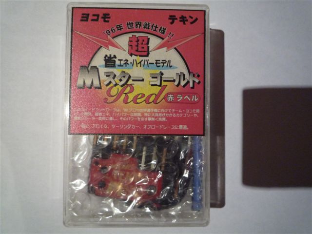

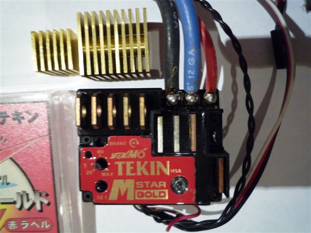

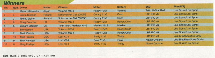

Jirka
Posts: 797
Location: Europe
Has thanked: 33 times
Been thanked: 24 times
Re: Masami 1997 IFMAR World's B3 by slotcarrod
Post by Jirka »

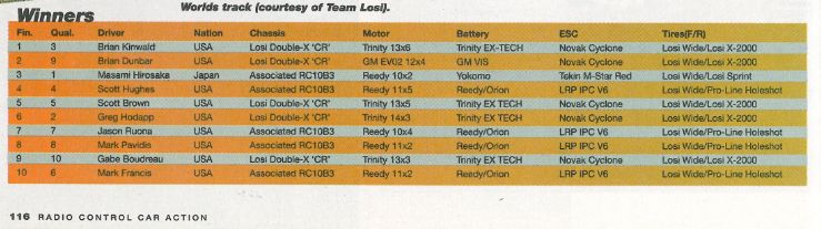

About that Tekin ESC.
Accoring to RCCA Masami used "Tekin M-Star Red" in 2wd and also in 4wd.

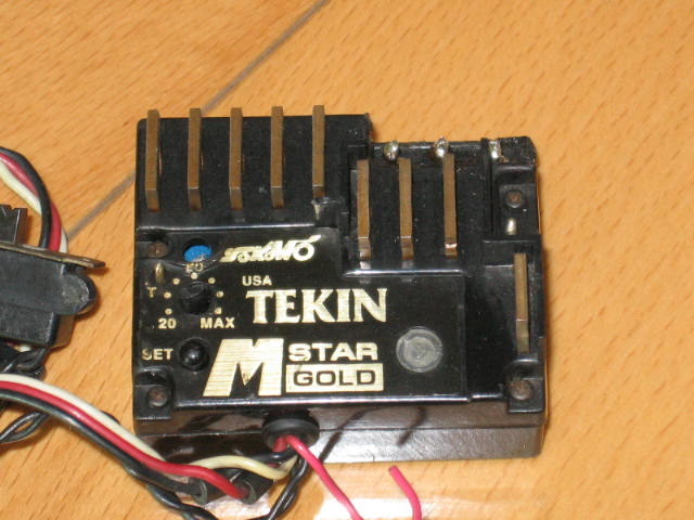

There are a at least 3 different version on "Tekin M-Star":

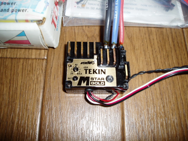

Gold label, see scr8p's post. This version has (from bottom to top) "Set"-button and torque limiter knob.
Black label. This version has (from bottom to top) "Set"-button, torque limiter knob and something blue.
Red label. This version has (from bottom to top) "Set"-button, torque limiter knob and break adjustment knob.
I have maybe a bit bigger resolution picture from RCCA about Masamis RC10B3, this ESC seems to me have something between torque limiter knob and FETs like there is in black label and red label ESCs. Those, maybe 9 pixels (dots in printed magazine) are darker where the break knob is than the pixels next to it. So the ESC that Masami used is red label or something else.

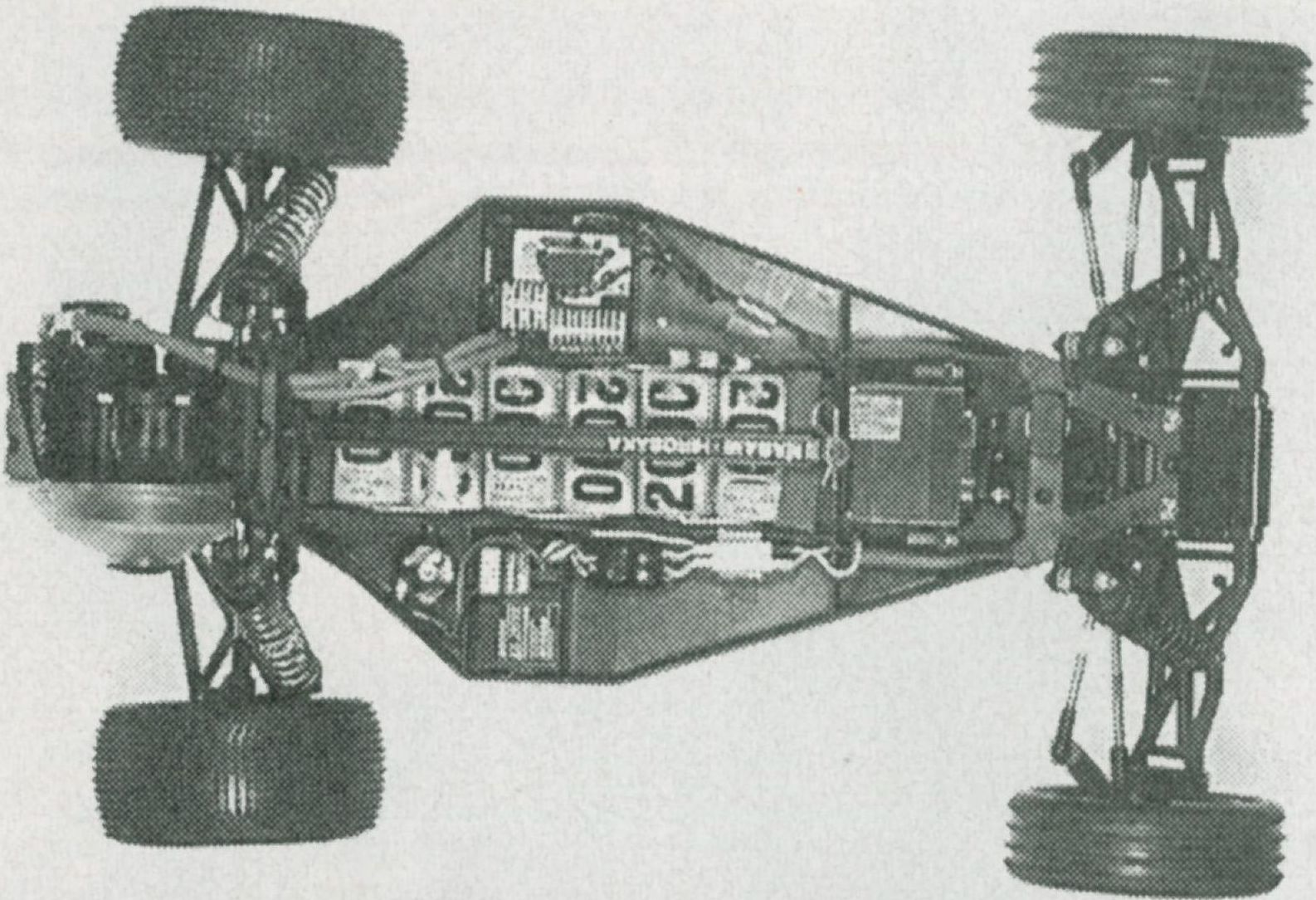

In that chassis scan, what KO RX is that and what is the switch in front of the RX? I assume behind the RX is a stutter stopper or some type of cap?
JK Racing
Posts: 4619
Location: Placentia, CA
Has thanked: 139 times
Been thanked: 246 times
Post by JK Racing »
slotcarrod wrote:what is the switch in front of the RX?
Would that be an FET booster?

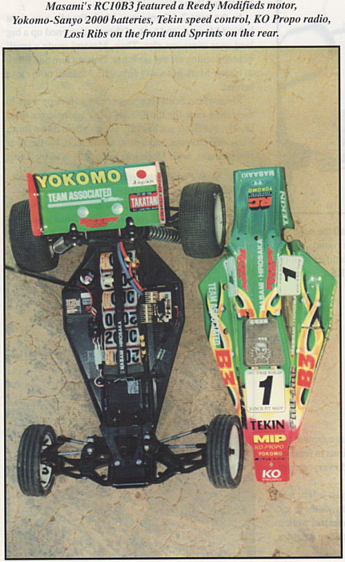

I have been working on this car lately and have noticed a few things. The ball cups Masami used at the race were B2 type, the ad and art car had the NEW B3 type ball cups (Not sure what to build now, race or the ad car?). The Tekin stickers were deleted from the ad and art. (Not sure what the beef was with AE and Tekin? I don't think they were selling LRP at the time.) Another cool thing is the name Masaaki on the tail end of the body. Looks like only the blue motor plate was used. Also, the standard front tower, not the FT carbon fiber tower. I think the Factory Team line of parts did not exist at the time, as I can't find any Factory Team documents or parts listed in my B2 and early B3 kits. I think FT was just about to be created at this time. Please correct me if I'm wrong.
