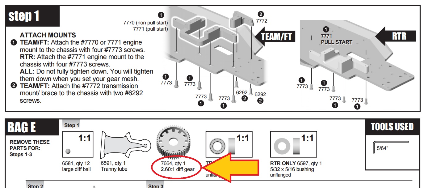

So with all the talk about the new laydown gearboxes, I got to thinking.........Associated made one way back decades ago, in the RC10GT. Soooo, that's what I assembled, and will be using in this car. I have it built up already, and drilled/tapped a B4 motor plate to work. It has an Avid slipper currently, but I still have the stock B4 slipper if I want to go that route.
I did notice the GT has a larger diff gear, so it may take some trial and error to find the right spur and pinion combo. Right now it's something like 26/84 with a 48p. The B4 gear cover fits nicely.

If I remember correctly, the GT and the B4 have the same final drive (2.6), so you could gear it the same as a B4 and go from there.

Even with the noticably larger diff gear on the GT? I'm using a B4 top shaft in the tranny. Hmmm........

yellowdatsun wrote:Even with the noticably larger diff gear on the GT? I'm using a B4 top shaft in the tranny. Hmmm........
