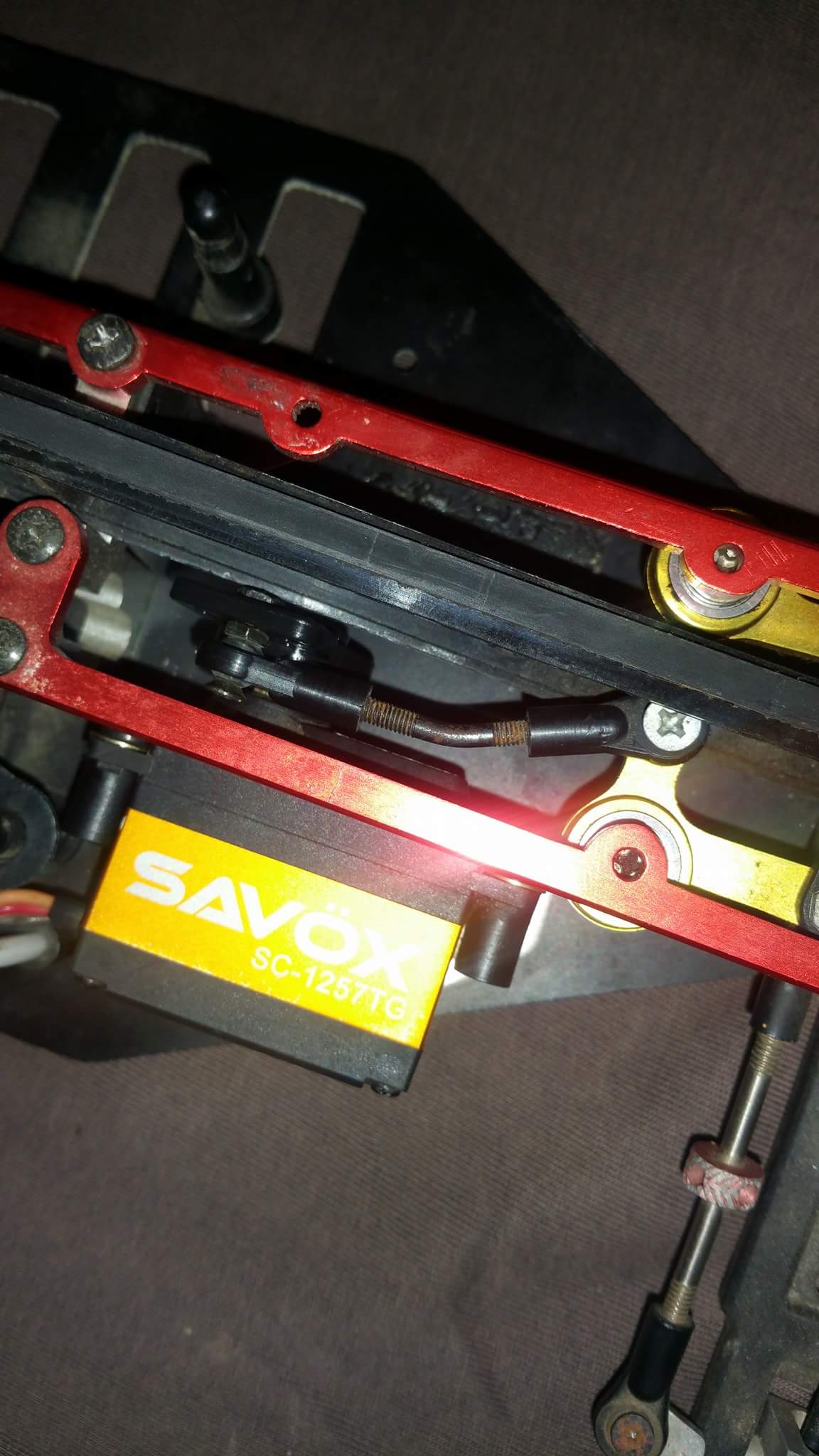

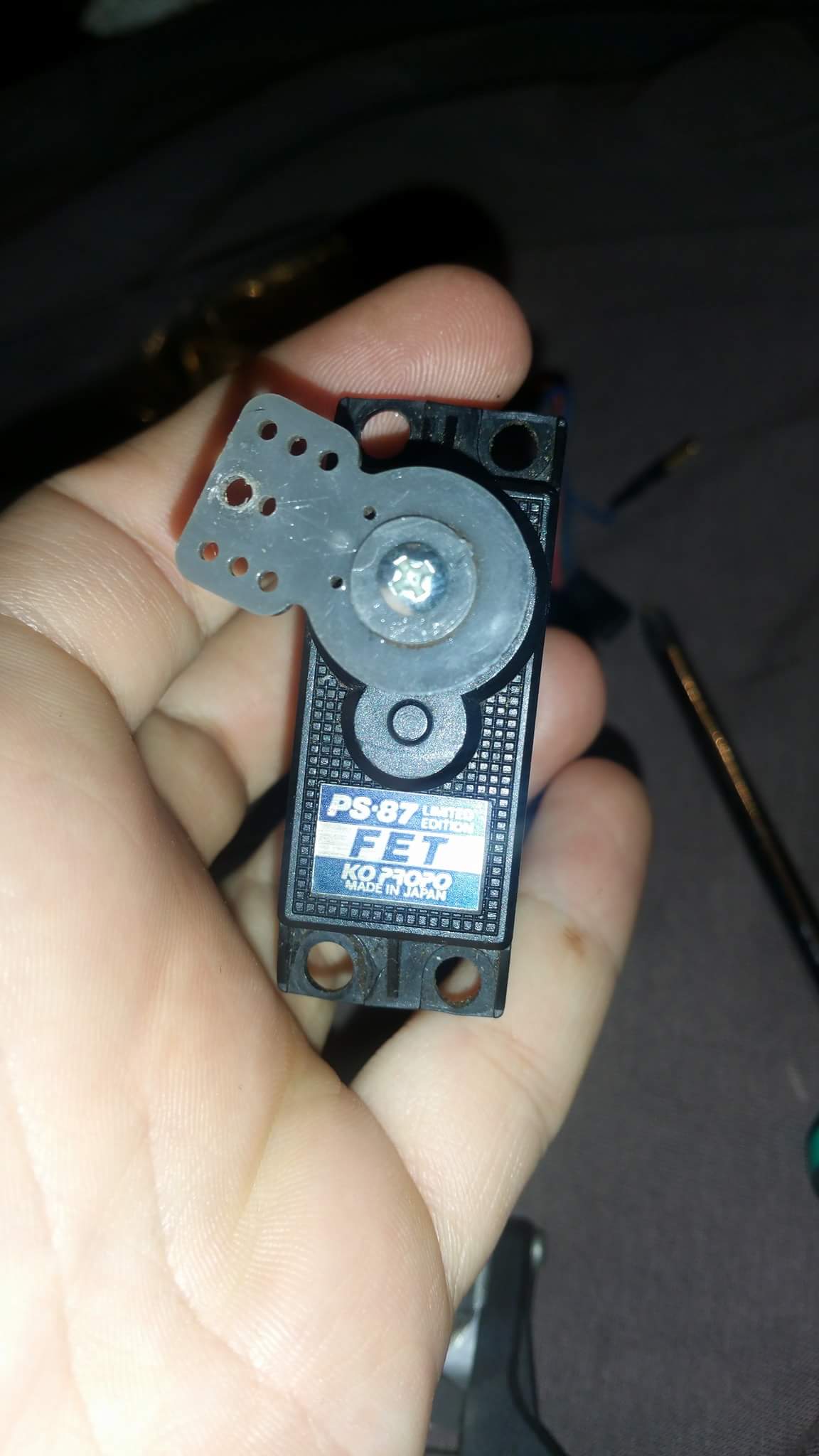

Might need to look into the diffs eventually. Everything seems daunting to me because its not a b2 or b3.
Playing with electrics anyways. Savox and new servo saver to replace the old vintage kopropo.

That old KO Propo FET servo might be stronger and faster than your Savox servo...probably eats batteries though. :lol:

I use akimbrough servo saver and a futaba s9551 using a b4 servo posts with the extra mm spacer to move the servo closer to the belt but ive added 20g ontop sothat servo your using should be ok for balance.

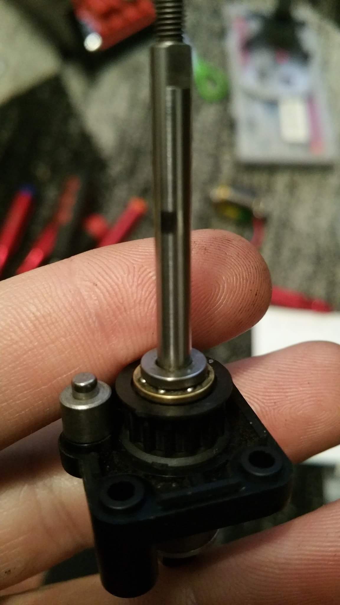

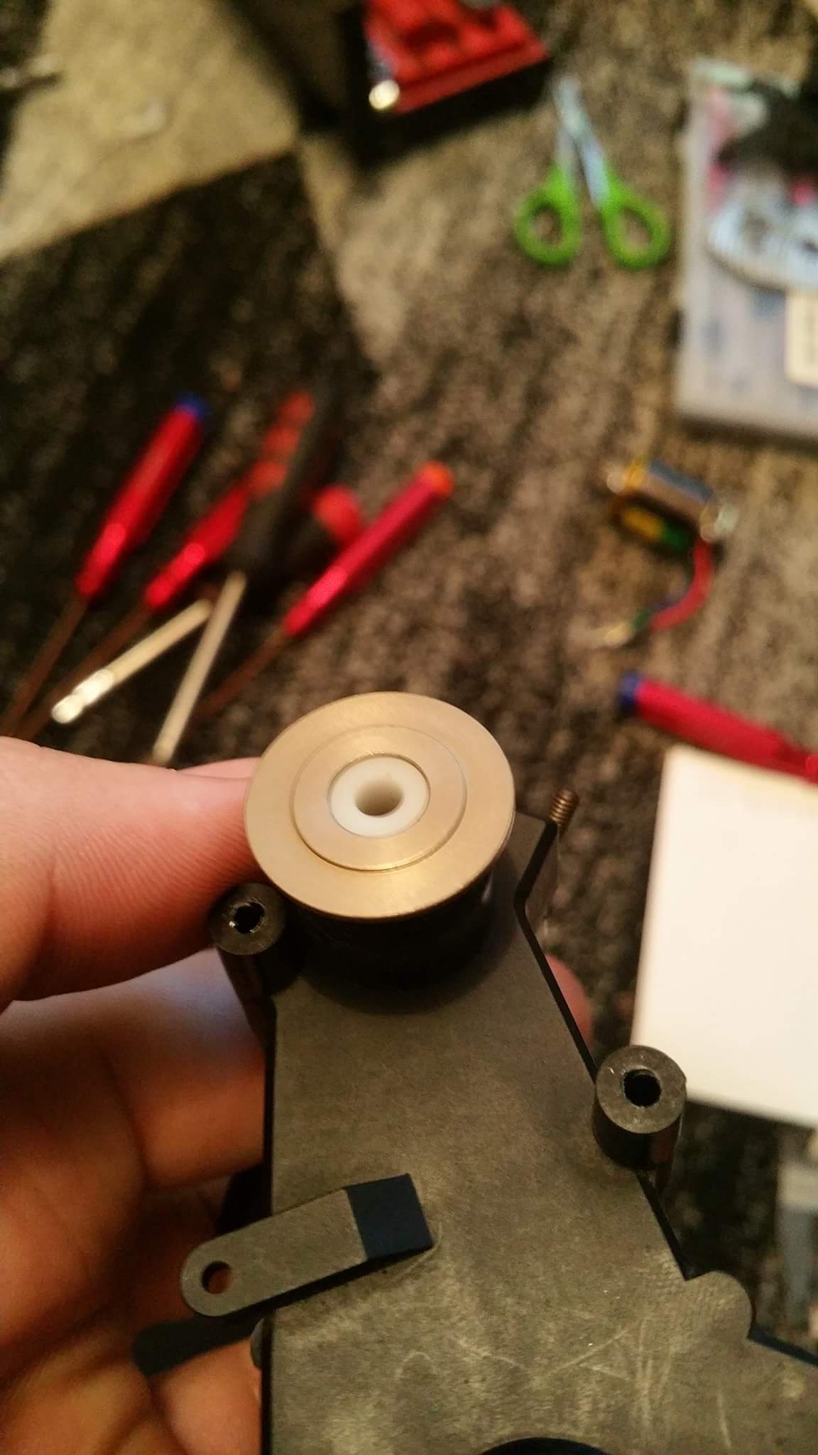

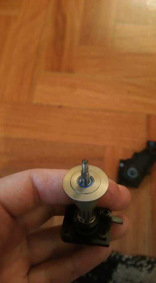

Rear gearbox bushings?
Only one i see is in the inner hub (white plastic)
Welshy40
Posts: 304
Joined: Tue Aug 09, 2011 1:55 am
Location: Surrey, England
Re: Lazer zx
Post by Welshy40 »
That plastic bit is part of the slipper but within the gearbox casing you have two brass bushing hole sections and maybe still with them attached, bushings are ok but bearings do free it up a fraction. Daunting it may look but if you take it all apart for a major clean and rebuild its relatively simple, me I changed the screws in the process to a more suitable hex headed screw for most of the car as it made maintenance a lot easier as you only needed one driver.

The only thing i see that are bushes are the belt rollers?
EvolutionRevolution
Posts: 1494
Location: Netherlands
Has thanked: 17 times
Been thanked: 34 times
Re: Lazer zx
Post by EvolutionRevolution »
Waz wrote: Wed May 24, 2017 5:54 pm The only thing i see that are bushes are the belt rollers?
If you open up the gearbox and remove the shaft, there should be either bushings or bearings inserted into the gearbox halves.

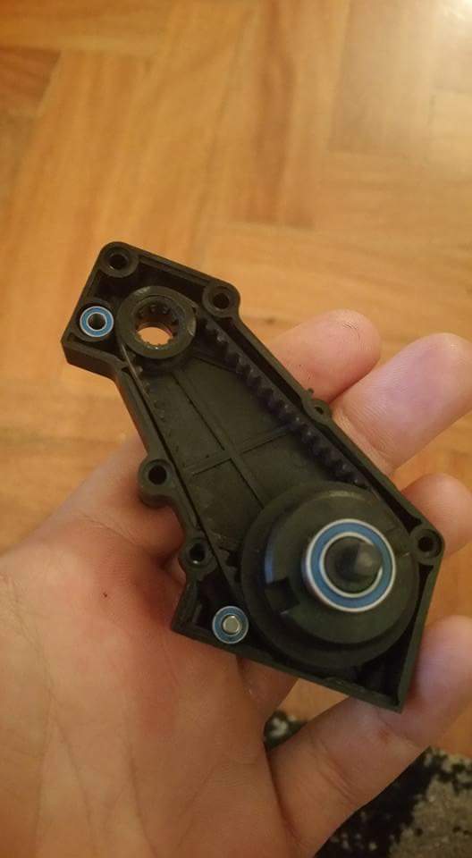

Already has crunchy bearings, hence the confusion.
I've ordered them plus bearings to replace the rollers and that plastic bush.
Yes thats the two brass bushings on a shaft, i put two bearings in their place

Welshy40 wrote: Fri May 26, 2017 5:11 am
Like so :)
Welshy40
Posts: 304
Re: Lazer zx
Post by Welshy40 »
Very nice, yes like that
