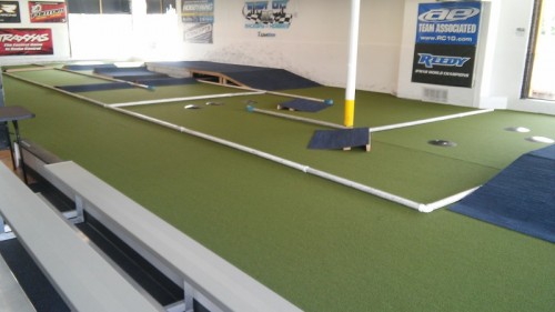

Some friends and I are setting up a new RC track here at the former WV Penitentiary. One of our track layouts is going to be carpet off road and I want to try and have all my ducks in a row with this Jrx-Pro for opening day.

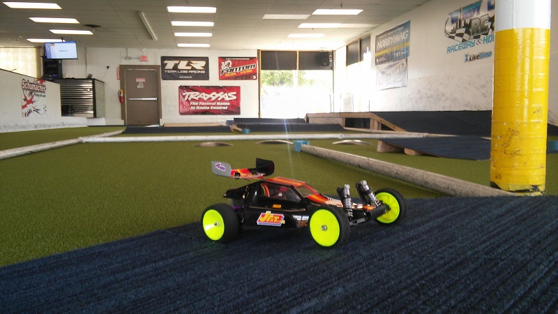

Car did very well today, no failures, the RC10 rere wheels are a win. The track configuration has a very tricky triple section that was beating the car up and it hung in just fine. I couldn't successfully take it as a single double combo so it was three separate jumps. It was actually more stable than my rere world's car which I have worked with a few times now.
Mostly I need to work my gear ratio a bit, one friend with RC10 B6M same motor was just much faster. I ended up with a 28 pinion and 82 spur that closed the gap as that is what I had. I think a couple more teeth on pinion would help. He also had a much better battery so that may be part of it. I also suspect he was playing with timing and ESC boost, I was not. Either way I think I have a bit of fiddling to do there.
I am running a non tunable blinky clubstock ESC and 17.5T Hobbywing motor.
The LRM tranny has a 2.18 ratio so based on the above spur/pinion my FDR was 6.38. Any thoughts? I was not running a slipper set up and as such I think 82T is smallest spur. If I go slipper I can go down to 78. I didn't feel at anytime today though a slipper would have helped me. I also may just think I need better batteries, I have some generic shorty Lipo and guy I was running against has Reedy 100C mega pack.

Re: JRX2 5 link down and dirty racer
That looks like a fun track! Glad to hear that the X2 performed well!
It's a smaller track which suits me better. Also removes all out speed as the deciding factor though I need to find a bit more speed when comparing buddies B6M also running a 17.5T. Going to play with gearing a bit more and setting on ESC.
Went back today, I ended up with a 30T pinion and the 78T spur. It was just about perfect, car was performing well. I had track to myself and was able to turn lap times consistently that would be bottom B main material. I am actually shocked how well the 5 link is doing on the turf. Way better than my World's Rc10 has done so far at least.
I played with some some toe settings and spring collars a bit but nothing earth shattering. It was very hooked up and as my tires I have worn I am actually getting more rear slide which I needed.
