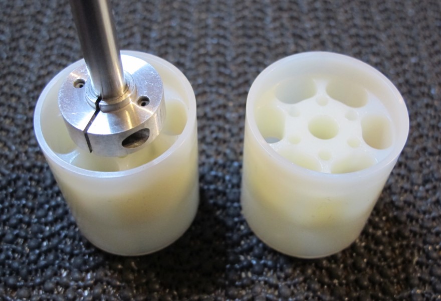

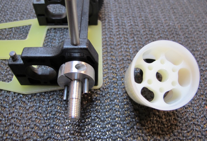

Rear axle is machined from aluminium and measures a quite unusual 7mm diamater. A clamping hub is used for mounting the left rear wheel, the same type of hub is used also at the right side for the first diff washer.

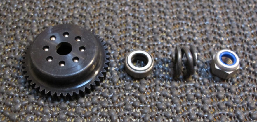

Mirage designed their own type of ball diff. None of the parts looks similar to American type diffs. Dish type spur gear, small diff balls, closed thrust bearing, no spring washer but very hard diff spring, metric M7 nut.

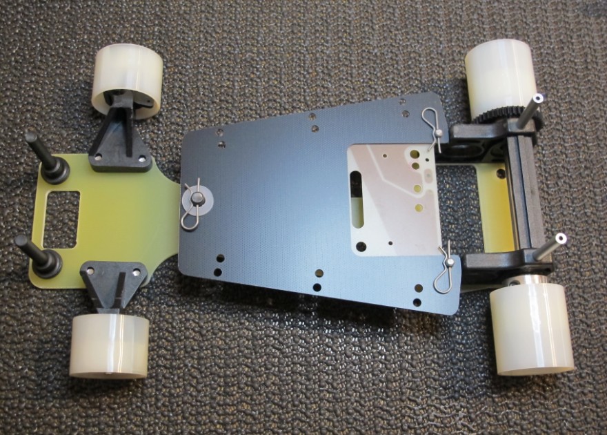

Tie rod and Mirage tires will be added.
Front and rear bumper won´t be added because I have not such parts. It seems to me also those parts were not used at races for lowering weight of the car.
Final pictures at Classic RC later.
