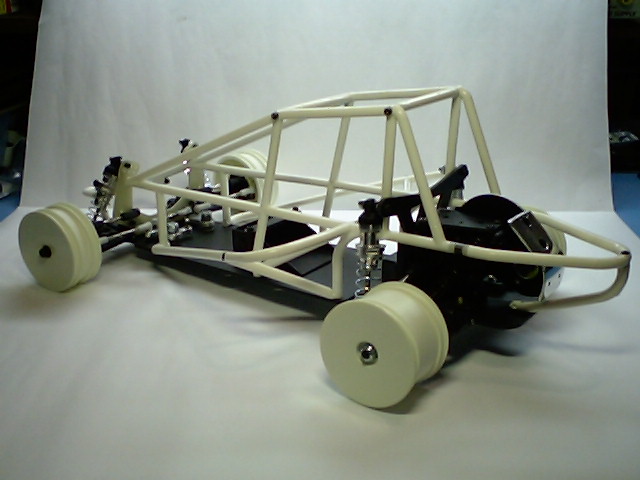

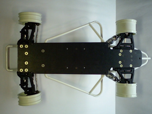

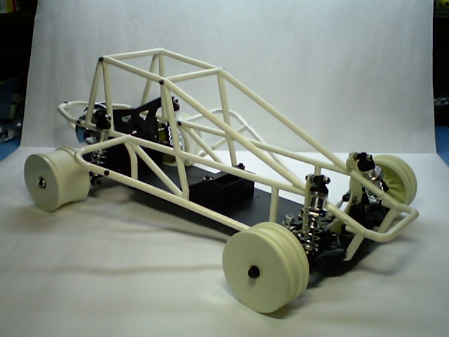

here are some pics of unique sprint cars. nobody seems to know who made these they are custom but i managed to find 2 of them 1 w/ fiberglass and 1 w/ graphite chassis. both have the front bulkheads mounted on old cheetah 10 degree castor wedges which are a great improvement rather than just flat mounting them.

Re: Sprint car conversion Big boys toys
are those plastic molded cages?
oh please, someone tell me who makes them/where to get one!

the caster blocks you have look like the stock 15 degree ones. i eyeballed a protractor aginst my computer monitor since you posted a nice juicy close up. on the fitment of the mip bell cranks and the mounting tube here is what i did to solve that problem. one time during a hard crash i tore the puniy 4/40 mip screw completly through the chassis and came up with this. i ditched the whole aluminum mounting tube and slid a piece of 3/16 aluminum tube over a long 3/32 screw and used that instead. i made sure to cut the tube exactly the same legnth as the stock mip tube and measured it with calipers. then also shimmed the bottom up off the chassis the same distance as the mip mount with some 3/16 wheel shims and topped off with a 3/32 nylon nut. it works great and have raced it like this for 5 years now with zero problems.

the cars i posted are not customworks cars even though they have customworks cages on them. i thought that when i bought them but i have been told they never made an enforcer with a standard rc10 front end. they have very clean cut or machined chassis that use the similar c.w. pencil graphite for chassis material. they are just really well built sprinters built in small runs buy some small company or 1 man shop. but they are still very cool and realistic lightweight cars and certianly conversation pieces.

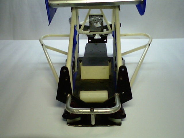

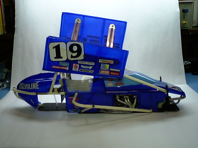

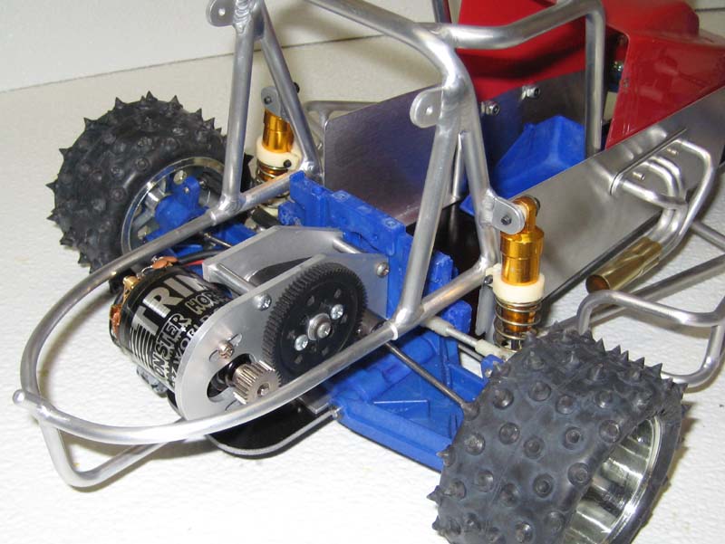

some updated pics.
The cage and transmission cleaned up really well. I used simple green for the grime, then one of these dremel purple finishsing buffs and then some 4-0 steel wool
The nylon parts were yellowed. I dyed them blue to try a red/white/blue theme, but the blue parts all look kinda scratched and dull. I think I may just go with black nylon and rpm arms and ball cups, and use the blue parts on another build.
