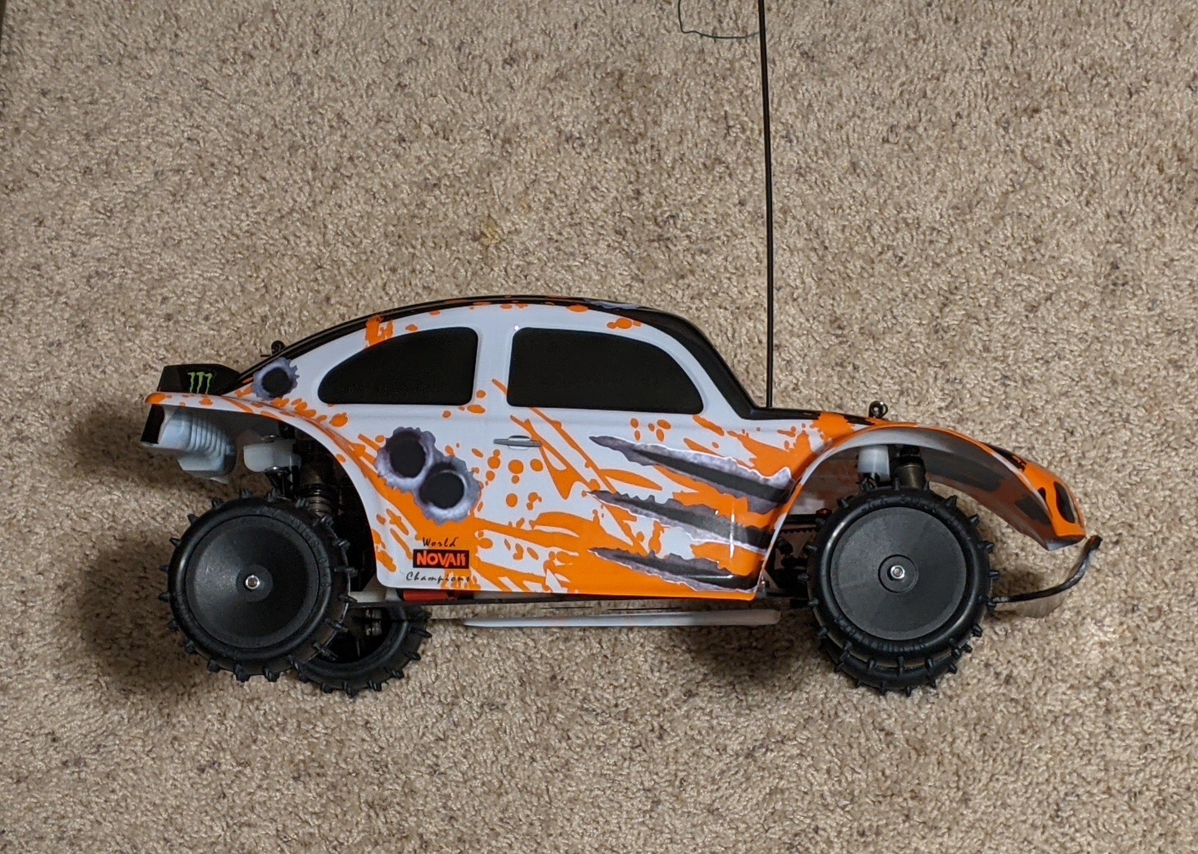

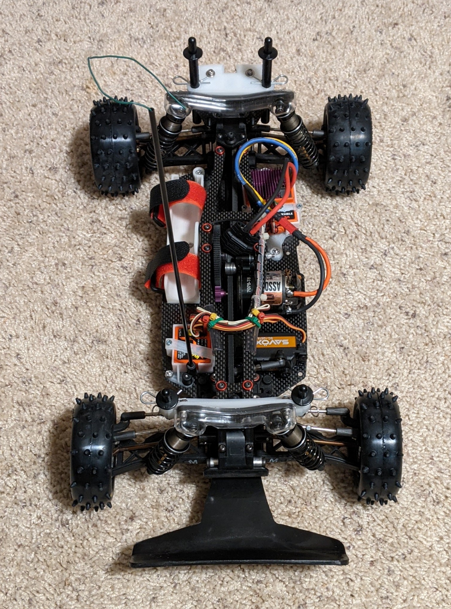

Nice to see progress. How does it drive with the higher center of gravity?
Also, have you considered using a body that fits the longer wheelbase (288mm) Traxxas 4-tec 3.0 series?

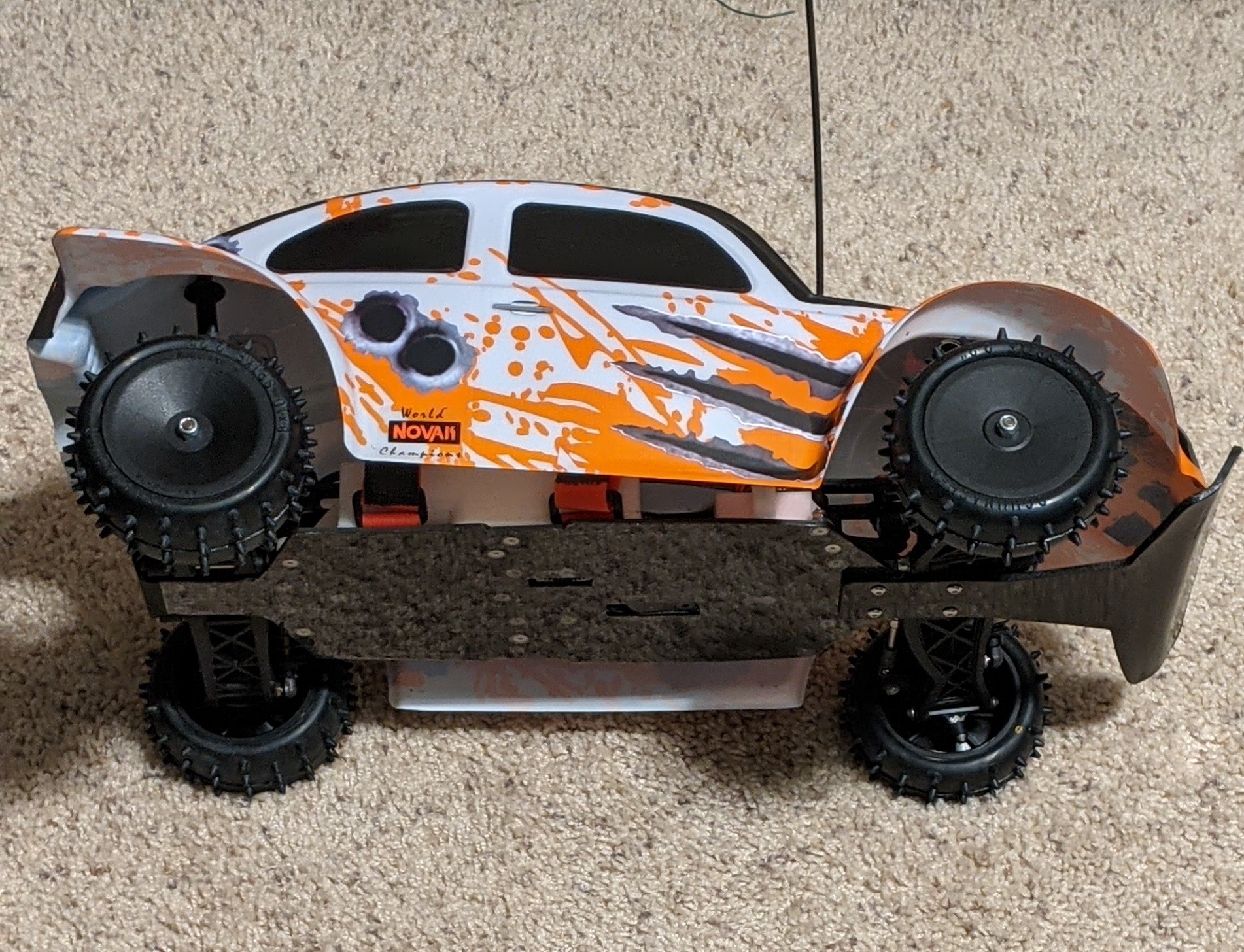

I've only had a brief shakedown run for the electronics so far. The suspension is set very soft right now and it lifts a rear wheel in every sharp turn due to body roll. But it grips well. I do need to come up with a new body. The battery mounting is too tall for the Cat body. I'll take a look at the Traxxas offerings. It is going to be run off-road too, so I need a body that won't cover the wheels.

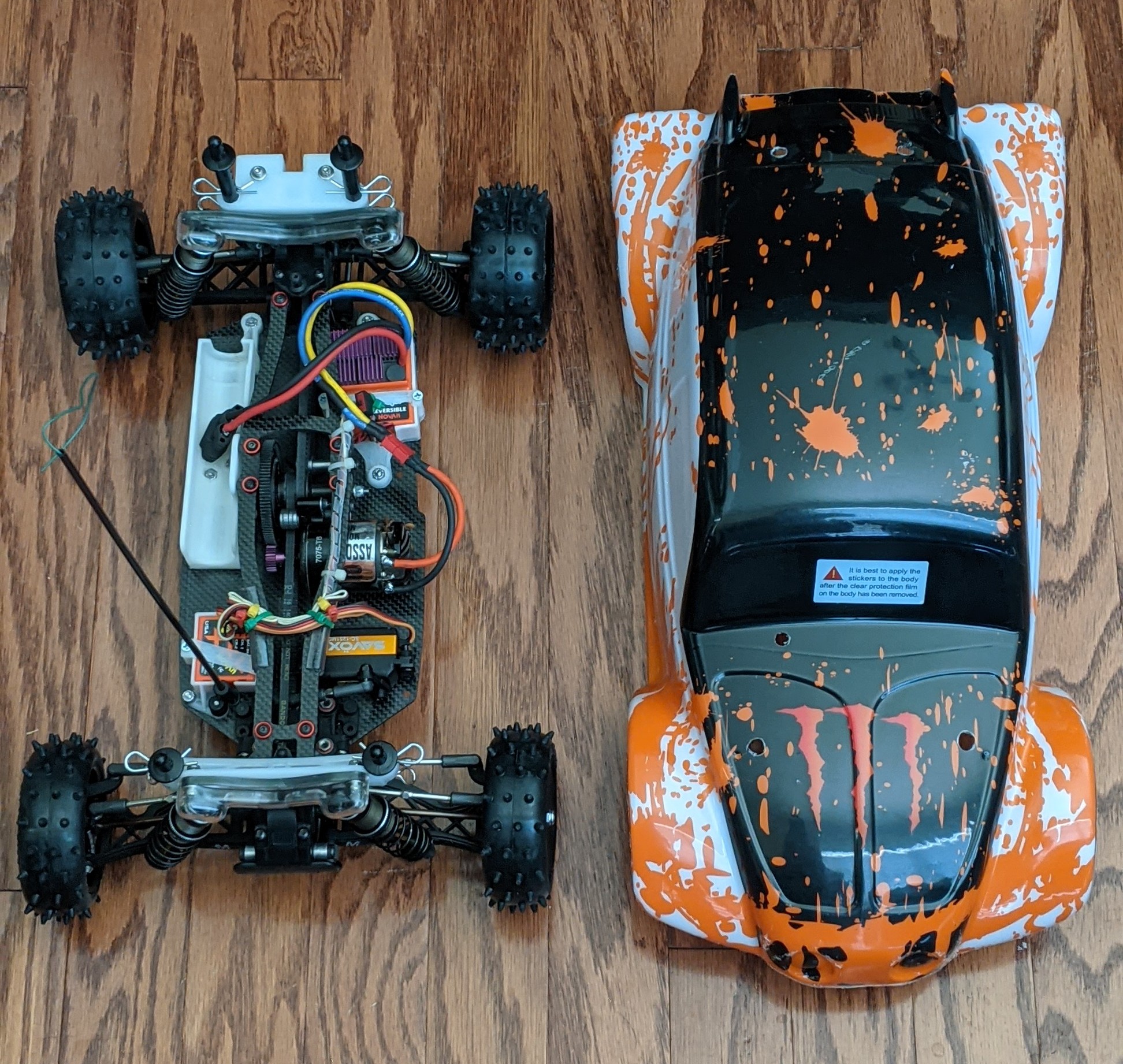

I've started fitting an adjustment body mount setup that will let me experiment with mounting different types of bodies. I'm starting out with a 1/10 scsle slug bug, but the proportions seem to have been exaggerated for fitting onto trucks and truggies.

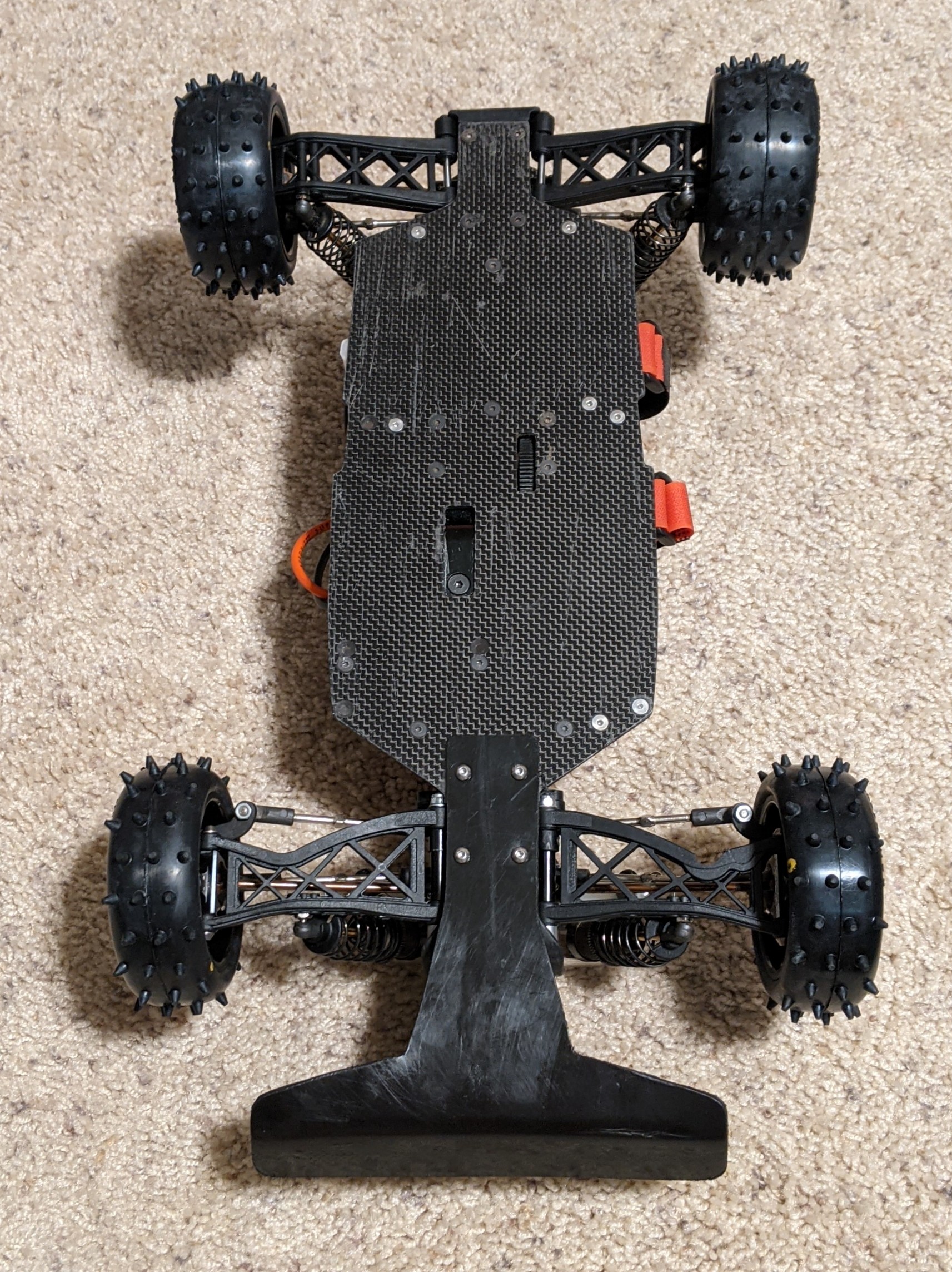

I've changed my plans for an undertray. I don't think having something that holds debris in and feeds it into the belt drive is a good thing for a 4WD car. I'm considering the JConcepts protective sheets for a chassis skin, but not sure if it's any better than plain old contact paper. Hopefully it is.

I think I'm done. I did use a JConcepts protective sheet for the underside and then added a front bumper. Now I need to take it out and experiment with the gearing to see what seems right for it.

Since the rear wheel is lifting, the following roll bar sets may be helpful.Frankentruck wrote: ↑Tue Sep 07, 2021 5:56 am I've only had a brief shakedown run for the electronics so far. The suspension is set very soft right now and it lifts a rear wheel in every sharp turn due to body roll. But it grips well.

Based on your requirements, the street body would probably not be a good choice. The Traxxas shell was only suggested since they offered a longer wheelbase touring option. Also, fitting touring width arms may result in the rear tires rubbing the K1 chassis.Frankentruck wrote: ↑Tue Sep 07, 2021 5:56 am I do need to come up with a new body. The battery mounting is too tall for the Cat body. I'll take a look at the Traxxas offerings. It is going to be run off-road too, so I need a body that won't cover the wheels.
Given your open wheel requirement, have you considered the Schumacher Storm ST shell and body mounts?

Frankentruck wrote: ↑Wed Sep 15, 2021 2:59 pm I've changed my plans for an undertray. I don't think having something that holds debris in and feeds it into the belt drive is a good thing for a 4WD car. I'm considering the JConcepts protective sheets for a chassis skin, but not sure if it's any better than plain old contact paper. Hopefully it is.
Using the K1 and the KF2 on a deteriorating road with loose pebbles, I have learned that velcro around the perimeter of the body shell (where the body contacts the side rails) provides good protection. In fact, if using a larger body (e.g. the Storm ST body), I would still prefer to use the K1 or K1 Aero body underneath to protect the drivetrain.
Also, nice bumper and custom body mounts. I added a front bumper (with a blank T-Bone Racing bumper) and it has been helpful.

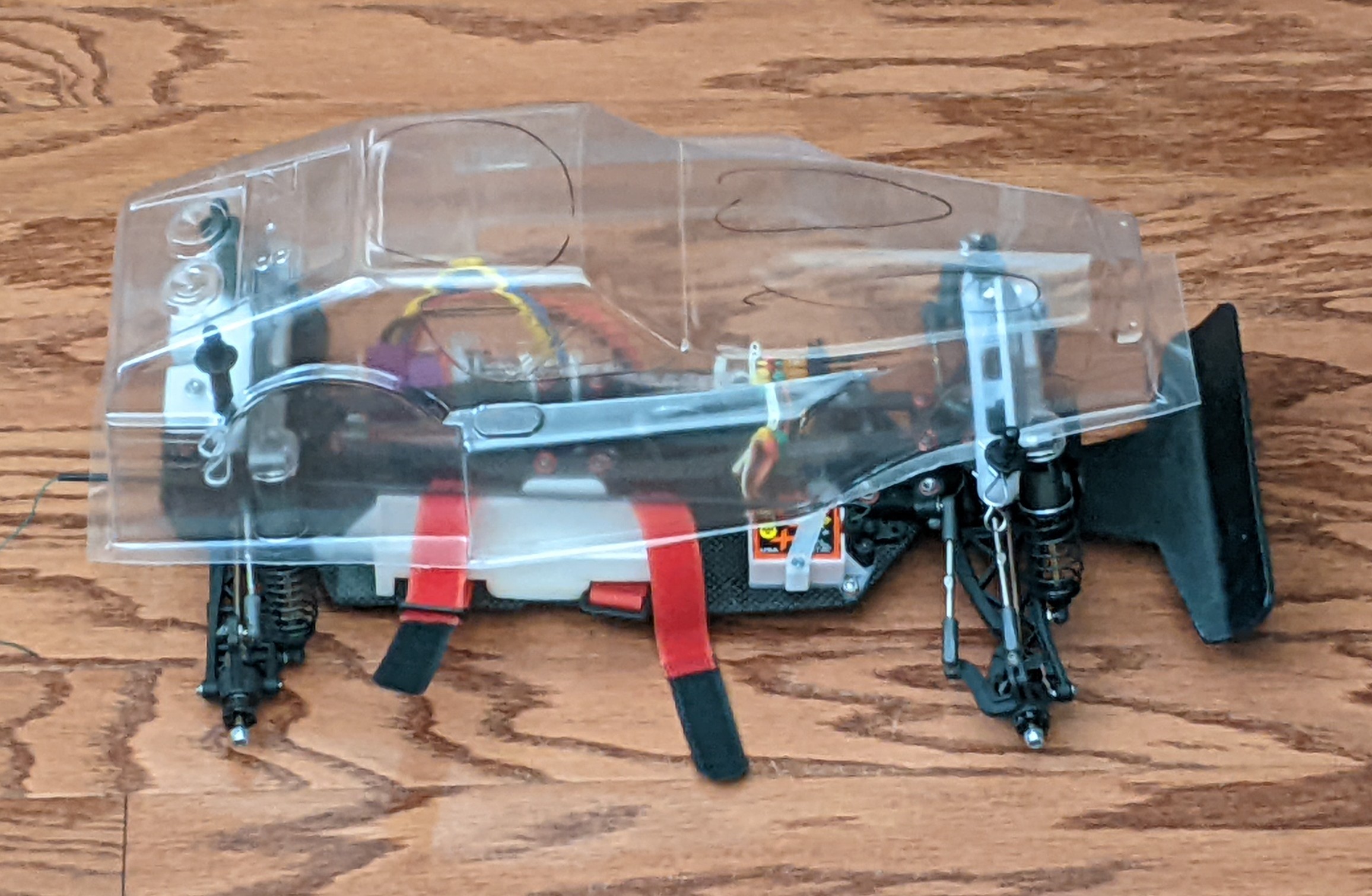

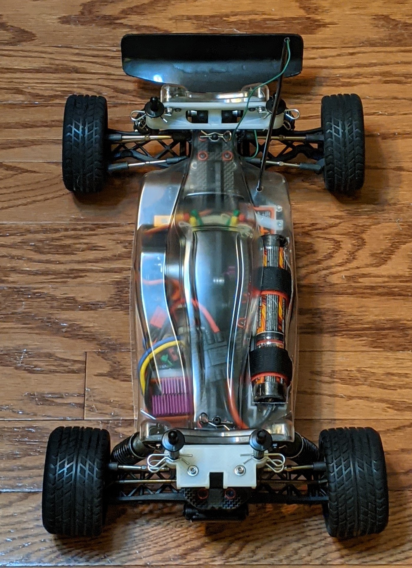

I was considering running an body under the top body for added protection for the drivetrain. I'm thinking about a u5123 with a tight fitting cutout for the battery. The existing u5116 body has the sides cut a little high so I'll need to start with a fresh body. If it doesn't come low enough on the sides, I may need to add some chassis side walls. Maybe I should anyway so there's a place for Velcro (the pods had to be removed for space reasons).

One custom trimmed dust cover. Still haven't decided if it will stay clear or not. Leaning towards staying clear because of all the tight routings inside it.

I've got a Sabula Tech Funco 2 seater body and it actually looks like a really good fit with the battery and electronics layout I have.
