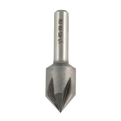

Temple is sending me the front tires I needed which I thought were TQ70's but now think from closer inspection of the manual that they have round spikes not square ones...any idea what they are?
Also final question, please can someone give me the dimensions of the drill bits I need for the nose-plate.
Nose tube holes =
Servo mount holes =
Countersink =
Chassis mounting/bellcrank holes =
Thanks a lot.

I use a #33 bit for all of the 4-40 holes (nose brace, servo mounts, battery cup, antenna & tranny) and a #19 bit for the 8-32 holes (suspension mounts, bulkheads, body mount & bell cranks). For the countersink, I use a bit like the one pictured. Associated's 8-32 flat head screws have 100 degree heads and the 4-40 flat head screws are 82 degrees.
Good luck with your build!
Paul

Just might be me, but on a project of this intensity, I'd use the proper countersink bits with the proper head angles for the screws you are using.
That's just me, though. ;)

You make a great point, Eau Rouge.
The content above has been edited (and yet another order :roll: is being placed to McMaster-Carr for a new bit for my build).
