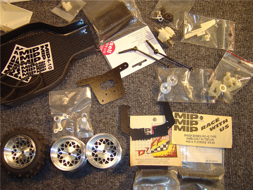

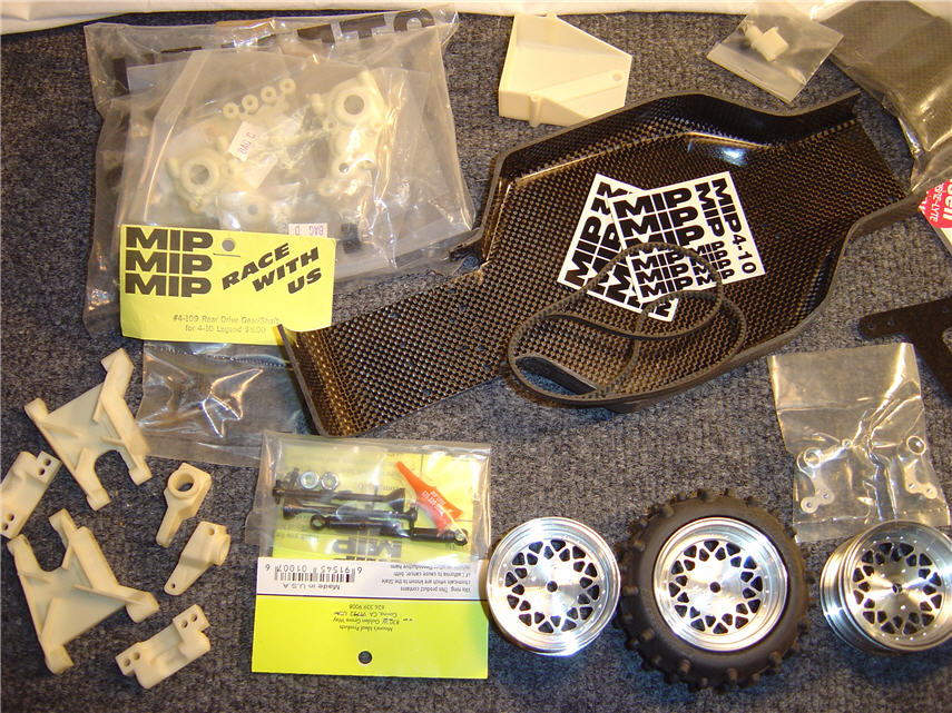

I purchased this tub and front plate from the Fibre-Lyte guys last August or so, just for this build. Now, I finally have the MIP kit - so here it goes. I'll add more photos of the project as things progress...

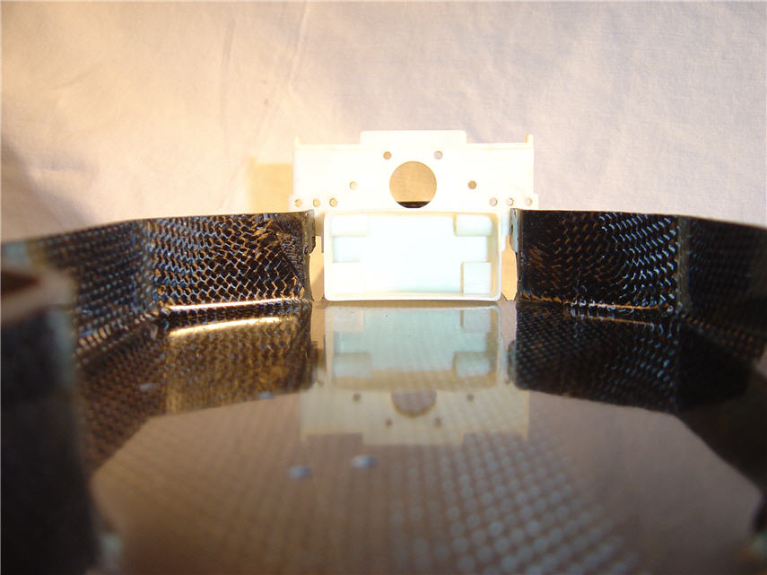

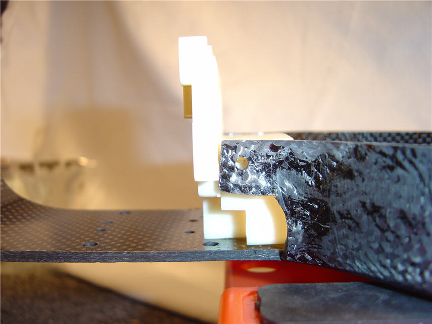

Yep, this chassis has the same issues as the older versions. The alignment of the side bulkhead mounting holes is off a bit and it’s too wide in the back. The really surprising thing, however, is the substantial gap between the bulkhead mounting tabs and the bulkhead. Perhaps they were allowing for a chassis brace or some other bulkhead? Maybe I’ll install an A&L brace per wyldbill's suggestion… 8) All of these items have fairly easy workarounds. At least the positioning and alignment of all of the critical holes on the bottom of the tub are spot-on.

BTW did you speak to Martin or anyone about your chassis's problems? I got mine through the post today and the first thing I noticed was that the rear was to wide.
I am going to be pretty annoyed if the bulkhead is miles from the chassis at the sides too.
It's amazing how badly made they are :shock: :roll: :cry:

The FL Tubs BITD came with little 3mm carbon spacers for the width over the bulkhead issue. At least I'm 99% sure mine did and the one i recently picked up had spacers too.
The slight mis-alignment isn't a biggy in my opinion.. it's not as if we run these cars! :D

I was curious about the bulkhead spacing, so I sent an email off to Fibre-Lyte.
I thought others might be interested in their response:
Hi Paul,
I've asked the question and have been told that spacing is purely because the carbon tub could not be moulded with those tabs in their original position as on the original chassis. They had to be position further out otherwise the chassis couldn't be released from its mould.
Best Regards
Stephen Walton
Hansell Composites Ltd
Unit 33
T. Dicken Ind Est
Station Road
Stokesley
TS9 7AE
ENGLAND
Just as Dr. Robotnik mentioned in his post earlier on his 4-10 thread, they also let me know they were sending out the 3mm spacers to fill those gaps ASAP.
