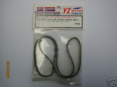

hey will this work on the front of the yoke?
Yokomo M2-252T KEVLAR FRONT DRIVE BELT ZC-653S, it's on ebay now
