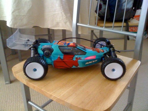

Yes still do. Just did the Petit event, and was the first time indoors. It went rather well in the finals which was a bit late but still a lot better than I thought. I have spares to last me for another twenty years so game on. The alloy parts were made as the car has a shed load of weaknesses due to not much development by Kyosho. Still I have alloy rear shock tower mounts (the weakests part on this car) and then the gear box front as its original design is milled out and puzzles me as one crash and its broken as well, but not as weak as the shock tower mount on the rear. Great car though and thats why I still race it.

Ian,
Well the first race it was diabolical. I have tried to set it up on a high grip carpet but had no luck in getting it right and Im no slouch on carpet setups so had no idea why I had no luck with this.
Richard Lowe helped me out a bit and by the finals I had got a half decent set up but had to get rid of the TRX1 shocks and go associated to get it close to where I want it. Still Richards ideas were good and pointed me in the direction I needed to go.
It still needs some more work but in the final I went from last to 2nd only for the undertray to come off and breakage on the front gearbox, but cant complain as it was rapid and yes very competitive. A lot of the guys in my heat were a bit shocked in the last qualifier as well as I was on a flier but I also had another breakage in that round and that cost me. But cant compain as I had a ball with driving it.
Yes a lot of people sat down and looked and Petit interviewed me and took pics as well as Racer and apparantly i am in the March edition so should be interesting.
2wd is now dialed and Richard set it up properly for me. Pity it was ready by the final but I went from last to 1st in two corners and was 3 quarters of a lap ahead by lap 2 only to roll and when I was marshalled as the sensor wire came out. Never mind but I now have a set up for the second event and hope to make the top 30 in 2wd. Ive also mastered the brushless ratios for 2wd.

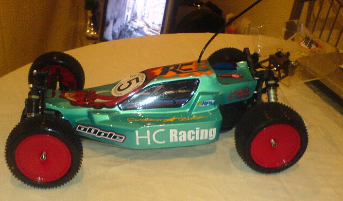

Re: Lazer ZX-S
do you mind a couple questions?
(I hope not 'cause here they come anyway
-which rear axle carrier is that? Lazer ZX5 with how much offset?
- why do you use the upper hinge hole for that carrier? I'm doing something similar but had to use the lower hole as when using the upper hole, the cvd would glide into the outdrive to deep and bind under compression (I think yours does also looking at the scratched part near the ball end)
- which length cvd is that? 62.5 of the ultima rb5 is almost identic to the original 1st gen lazer dogbones, but does not allow more offset to compensate for the smaller offset of the 2.2 inch wheels. the ultima RB5 cvd's are also a lighter colour... are these 65.5 ZX5's?
- Posts: 320
- Joined: Mon Nov 26, 2007 3:39 pm
Re: Lazer ZX-S
Nope its from the 2wd RB Type R buggy and the standard kit off set, whatever it is.
Im unsure what your talking about. Please emphasise more. Do you mean the upper bottom holes that link the hub to the wishbone, if that is the one you are talking about then the car seems to work better in that position on a high grip surface. However I have changed it again due to totally redoing the setup with help from a very helpful Richard Lowe, who picked up on a few things when I was trying to set it up at the Petit event. I had never raced it indoors before.
If you are using a ZX or ZXR the I would seriously advise in using the kit instruction hole as the car perfered that position. Also this car is not a ZX or ZXR its a totally different buggy altogether. My UJs dont hit the bottom of the diff units, its just that the UJs are 15 years old and have worn over the years of a lot of use. Mind you the pictures are showing flash reflection on the Petit site if thats what your on about and if you pay attention to the drive cups you will see no scratches or shiney bits on the edges.In fact there are no scratches on these as I look now, so it must be the reflection. I think your on about the ZXR and your issue may be due to having the longer UJs in the rear instead of the front hub where you can use the other holes on the castor block to widen the front end. Other than that your camber is a bit wrong from what you are saying or if you have gone and copied my ZXRS rear end then there could be the bearings that may be pushing the uj further in towards the diff. You may have the wrong hub, and may need to file away a section of the inside to resolve the issue.
Nope they are prototype and even I am unsure of the true length. However I have done some homework and discovered that there are about six different size UJs for the ZX5, maybe a bit more and I understand that two of those sizes will fit, but I am unsure which ones at the moment. The ZXR UJS do fit but I think that the front there is an issue with the ujs popping out.

Re: Lazer ZX-S
guys, ive now got redesigned gearbox sides that have strengthend the car big time. Also got lighter steering plastics and will be trialing a new LA11 plastic. Hope it lasts. Also ive narrowed the rear by 1mm on each side, and widend the front by 2cm on each side and makes this so much more drivable and turn in and out of corners are tight as tight at high speed. Also moved nimh batts saddles together at the centre very rear of the chassis where they sit against the top deck and motor plate plastic mount. This aides jumping and handling and is almost ready for the Petit invitational in January.
Next change i would like to do is fit a zx layshaft and third diff slipper ( the one with bearings in the spur gear). if any one has one and would be up for selling pm me and let me know.
Also the front wheels are protos and are basically ansman mad rat rears cut and shut into a front wheel. Im getting them made into a mold and will have these on the front. Its looking rather nice now.
