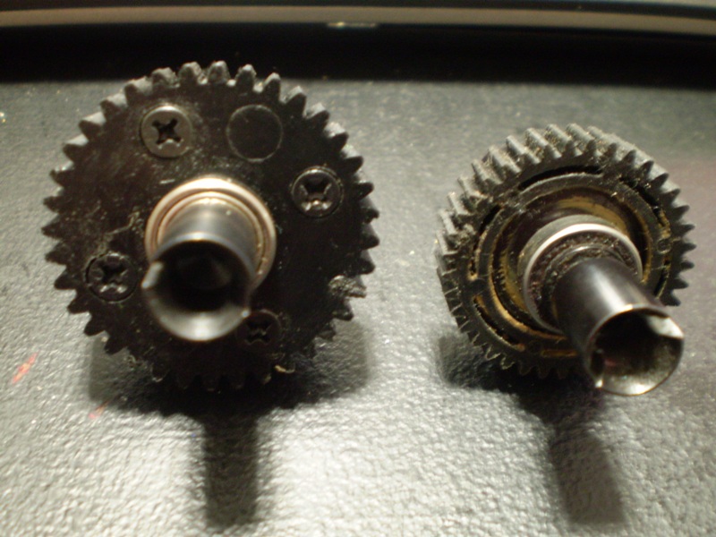

here are the differences, right is a ball diff, left is the st15. the st15 has a 32pitch i guess, and the ultima is that .5 mod or whatever metric it is.
and the internals are radically different too, nothing can be adapted, the outdrves and overall width of the diff is wider too

Totally different indeed, thanks for posting this picture.
(glad I didn't order this)
fyi:
The pitch of the kyosho diff is 32 dp, the st15 has something larger. (The 0.5module is only a tad bigger than imperial 48dp)
There's a geardiff for the ultima also (used in cheaper cars after the turbo, and on the original ultimas before the turbo.
fyi:
