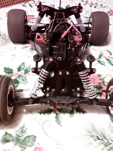

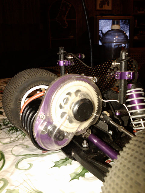

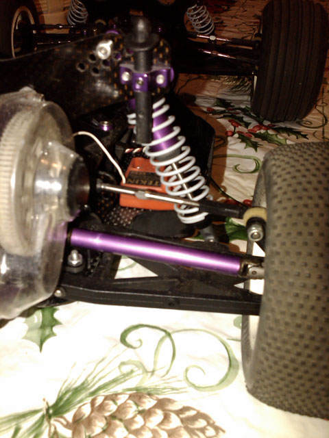

that chassis is awesome... i'd love to have one...as far as the drive shafts go, i made newer ones for my storm 2000... i crimped the thin tubing.. took out the ends ... bought thick walled aluminum tubing and had them adonized purple then used threadlock to reassemble the drive shafts...i'll post pics by this weekend

photo-tips:
- most important: no old fashioned flowery table covers
- serious: the contrast between the light colour background and dark plastic and graphite parts is too big. Try a darker colour background and the details of the subject will come out better.
- don't flash straight onto the white background, (better, don't flash at all, but probably others here won't agree
- use a camera stand for long shutter times, or support the camera in some other way
- or use more light on the subject
- check if you have a macro function on your camera
maybe this sounds jerky, but honestly I'm just trying to help you a little.

didn't take it as jerky...just took the pics at 2:30 am in the kitchen with my camera phone

i still have my box too...i'll try to get some pics up this week...as far as gearing goes...i'm running a 13 double with a 83 spur and 19 or 20 tooth pinion
