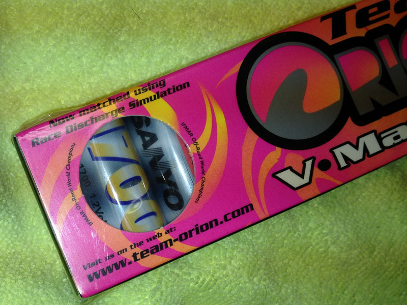

Can anybody identify these cells? They're 1700mah and the label is blue, kind of like the tan label of the RC2000 cell. I'm guessing they are the last version of the 1700 that came out right before the RC2000 cells. The box is sealed so I don't want to open it up.
