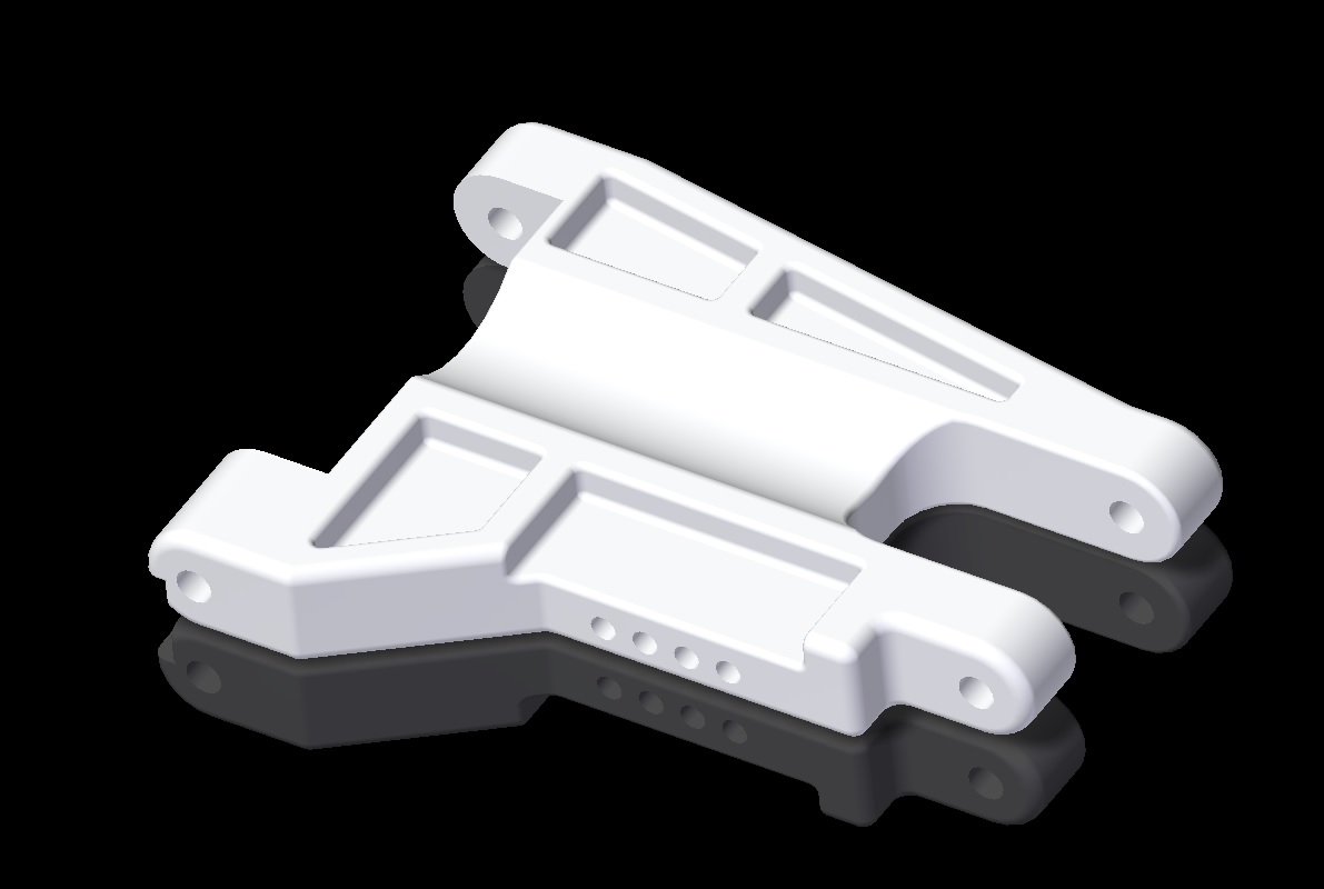

Nothing is indestructible. The new arms will be designed to be tougher but I have no idea if they could have survived that wreck or not. The current arms are intended to retain a stock appearance. It really depends what you want. If durability is more important than the original looks then the new arms will be the way to go. They'll probably be a couple of dollars more since there is more material in them.

I considered making the new rear arms wider to accommodate the stock RC10 hubs but decided against it. Part of the reason that the current conversion arms work well is because the front and rear arms are closer in length to each other. The reality is that with a front kick, you want a longer arm in front than in the rear. The RC10 has much shorter front arms than rear arms and even with the wider version, the fronts are still slightly shorter. If I were to make an arm that would use the stock rear hubs, the rears would be much longer than the fronts again. This is also why I haven't made a set of arms that allow the use of hex wheels up front. They'd be short again. Just slightly longer than the stock arms. I don't want to make something just for the sake of making it but rather have it be a useful improvement.

In progress. There is a lot more material here.

I finally got around to loading those new rear racer arms into Shapeways. They are quite pricey since they've got a lot of material in them but they should be strong.
