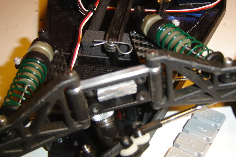

A picture of the lead placement under the bulkhead. You take two 1/4 oz lead weights (for balancing auto wheels), stick them together and shave the sides with a sharp knife so it fits snug inside the front bulkhead. This helps with turn in and it keeps the light front end down a bit better.

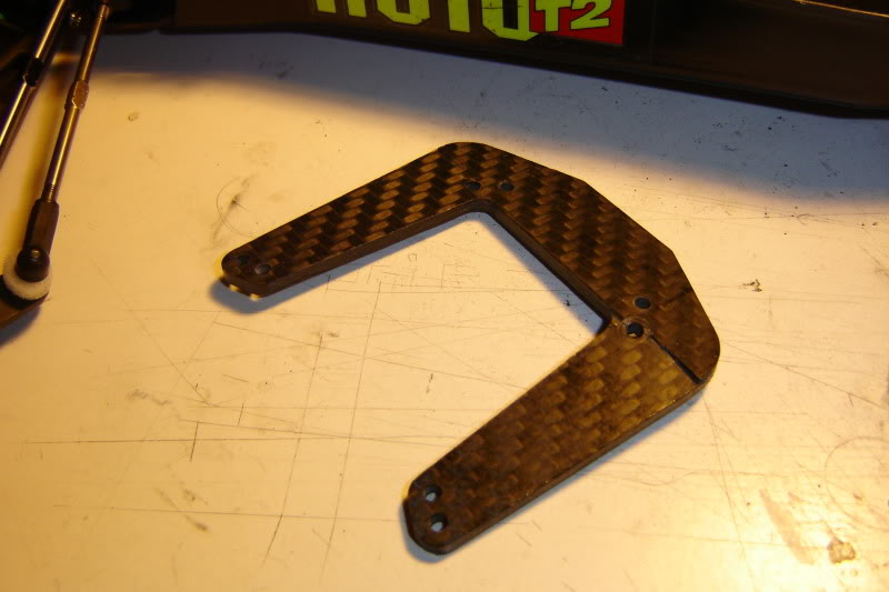

You all know from reading my posts that my carbon fiber tower was busted by a HPI Savage crashing into me! :cry:
Trumpets please! :D :D :D
I found 2 in Vegas, one was 1/2 price! :D :D :D :mrgreen:
