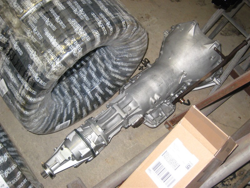

metallicats33 wrote:what's under the hood? 455?
it's a 68 toronado 455, but it's punched out to a 496. it also has a turbo 400, with a Gear Vendors 6 speed overdrive setup on it. look how long the friggin' thing is. :lol:

Holy crap :shock: That's not going to bolt right in is it??
Mine had a 455 30 over and a Turbo 350HD trans.

metallicats33 wrote:Holy crap :shock: That's not going to bolt right in is it??
hell no! :lol:
we had cut off, raise, and reweld the ends of the trans crossmember to drop the trans about an inch, reshape the trans tunnel and restructure one of the floor braces. also had a new driveshaft made that's about a foot shorter.

is there another crossmember for that OD? I always hated how far off the end of the trans' they hang.....makes me nervous....
