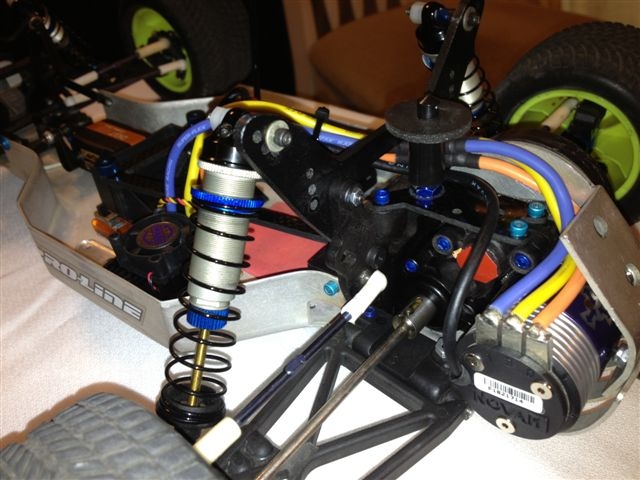

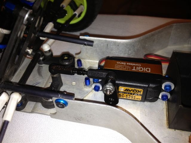

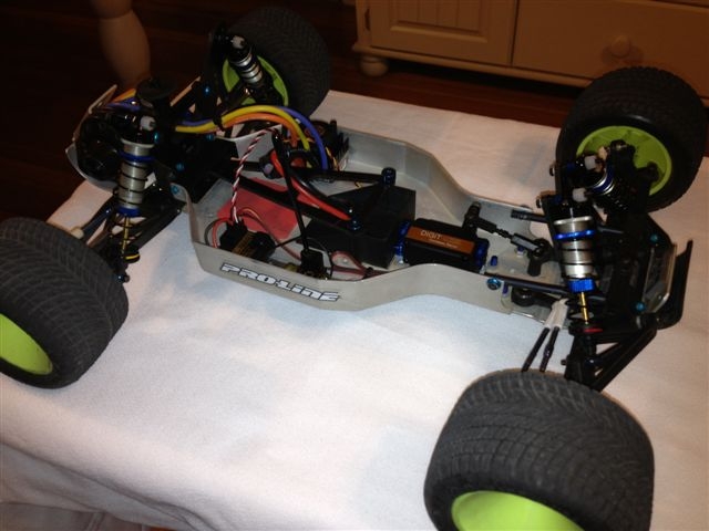

Update for this model:
Currently set-up for our local parking lot "rally" runs on bumpy, gravel strewn pavement
with a few home-built jumps, etc.
Pro-Line Road Hawg tires.
Freshly rebuilt 2.25 Stealth transmission with 81/21 gearing.
Novak GTB-2 speed control with SS Pro 8.5T sensored motor.
Savox 1251-MG servo.
Airtronics 2.4 GHz Rx/Tx.
Runs great!
-dldiaz

Post by Brocklee »
Sweet truck, does it handle noticeably better with the big bores?
Cars: kyosho raider, rc10 ce, kyosho ultima pro xl, lazer zx, inferno mp s, losi xxt, xx4we, rc10t3, kyosho zx5 sp, rb6, zx6, rb7ss, zx7, mp10e, crc xl, rc18r, tamiya trf 801xt.
dldiaz
Posts: 838
Location: San Antonio, TX
Has thanked: 41 times
Been thanked: 58 times
Re: Fresh RC10T Racer
Post by dldiaz »
I didn't own the truck before it had the big bore shocks, so I can't really compare, but I can say it is very well damped and handles very nicely with the current setup.
-dldiaz
