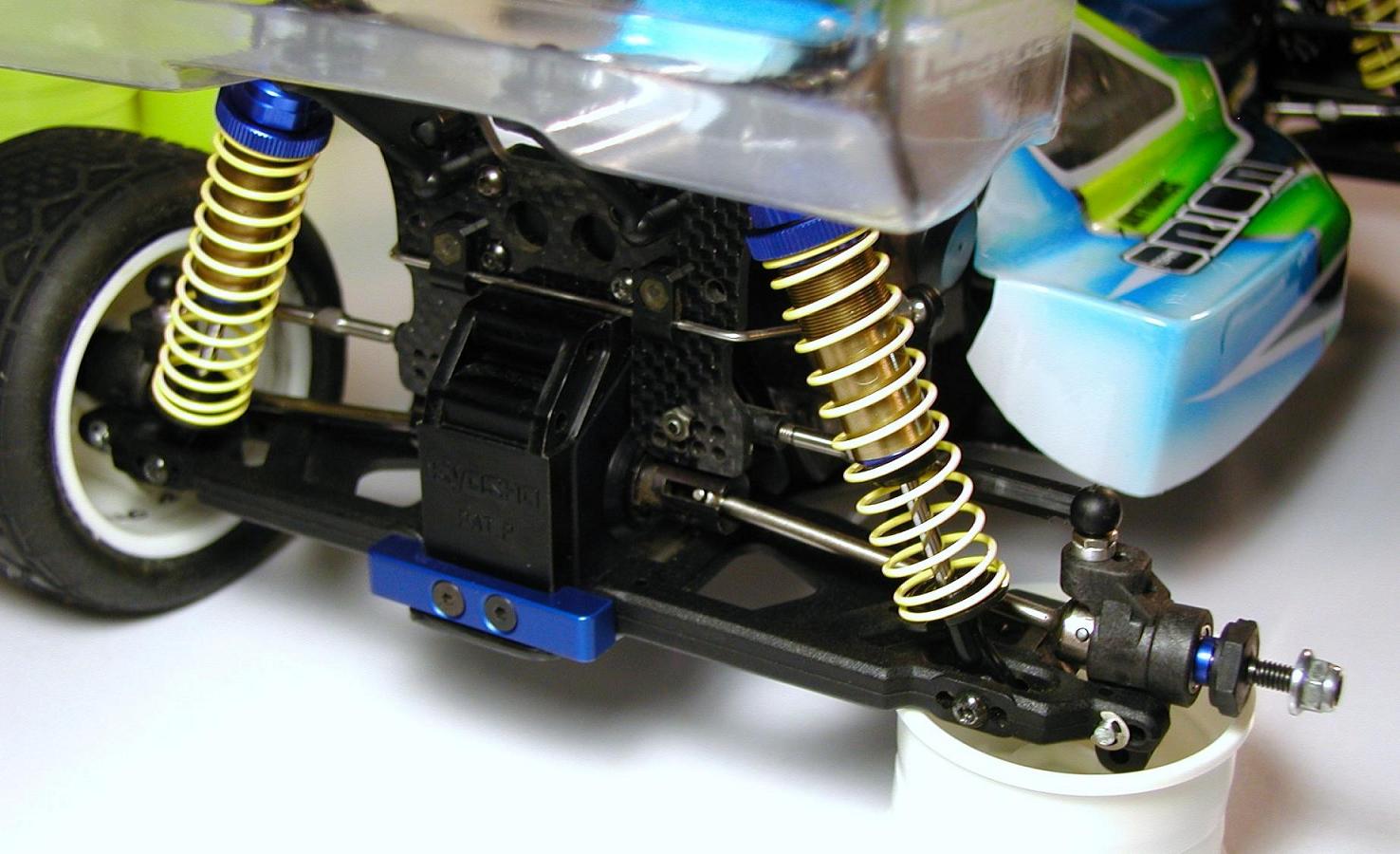

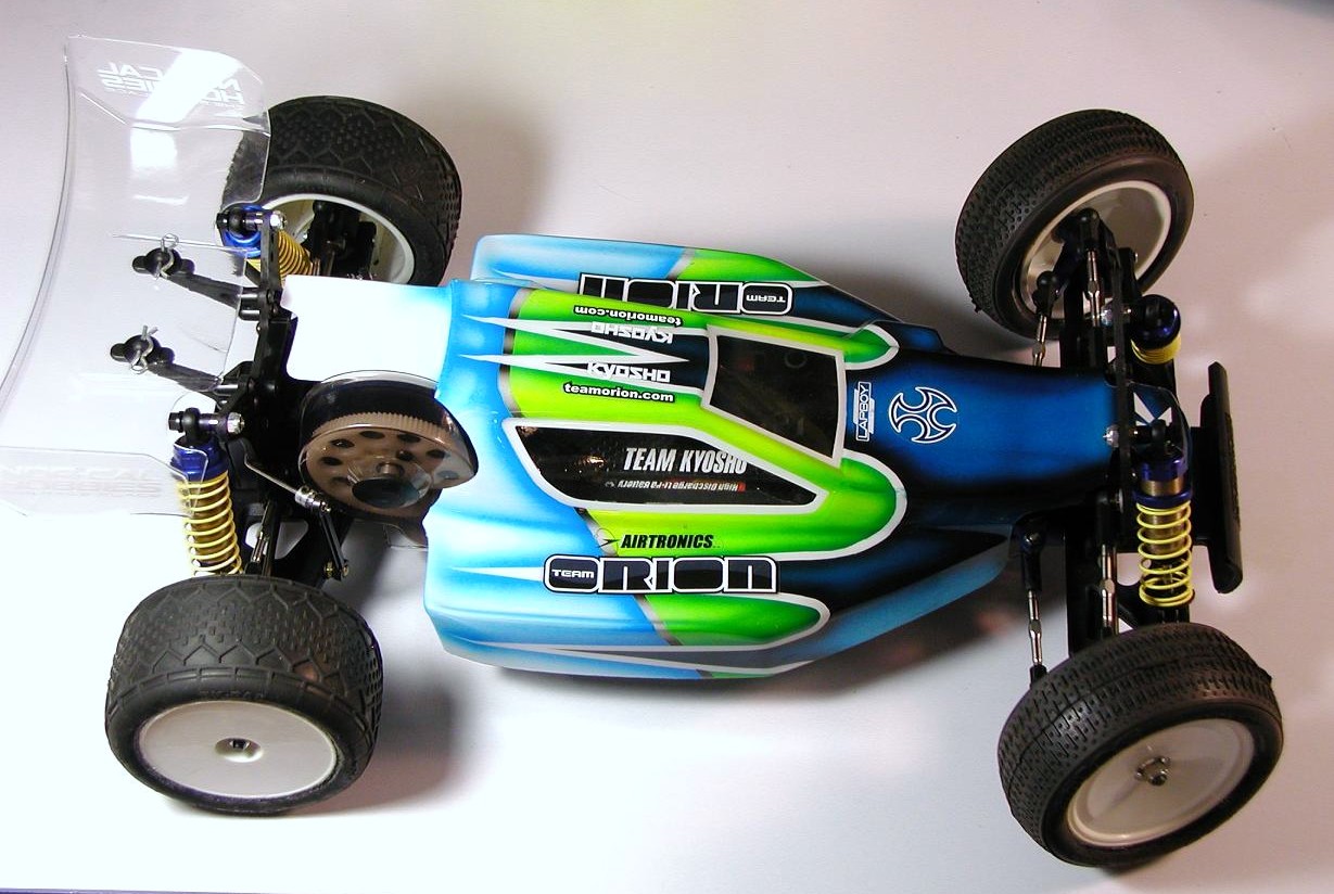

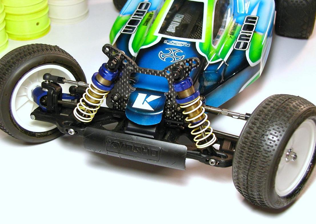

Here are a few pics of my current ZX racer. Has quite a few mods, most can be seen in the pics. -Jeff

First question iso asked. Rear hubs narrow the rear fractionally and make the rear more dosile so it follows the front more. Also gives more height adjustment and thought you knew this as i first tested this 10 years ago. Doh!!!

Re: Please show off your Lazer ZXs here!
Well, the rear width is the same as the ZX5 FS. If you look closely, I have re-drilled the a-arms to accomodate the newer version rear hubs. Having a hub with a further hinge pin offset (compared to stock), makes the car more supple in rough corners. Since my local outdoor track can get rutty, it made sense for me. I have really only run the car a few times, and it has always been with the mods I currently have. So I have little input in regards to stock.
I originally fitted the ZX5 front hubs to gain more caster, as the team line or kyosho versions were hard to come by. I used the ZX5 steering knuckles as a better option than the cast ZX versions. Overall I think the car is at max width front and rear. I do plan to adapt the ZX5 FS/SP front knuckles and blocks in the future. Two reasons, first is the same as previously stated for the rear (more supple in rough corners), the other is so that I don't have to carry two different style front wheels to races
