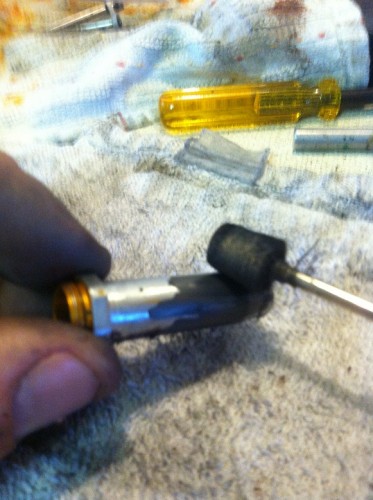

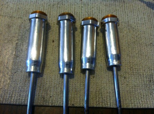

ok well here is some more stuff i did
was looking for some orange shocks
but i thought that would be to much
so i did a lil polish job step by step for ya
i know you can do other things to remove the anodize
but i wanted to get rid of some dings and scratches
there is about 1 hour into each shock
dont mind the shock nuts and such just on for a mock up
here we go enjoy

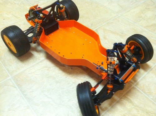

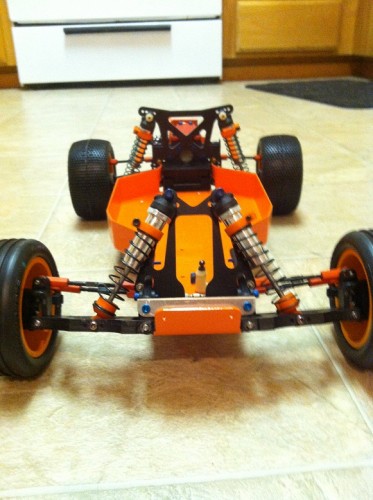

here is what the look like on the car
and some my dye
work
enjoy

Casual observations-
Ditch the alloy screws as shock mounts unless you like not finishing races
Ditch the alloy screws in the nose brace tubes and chassis mounting points too
Love the RIT Tangerine color!
What shell are you running?
- Posts: 553
- Joined: Mon Mar 19, 2012 9:06 pm
- Location: Bakersfield, CA
Re: FARMERS Official ORANGE RACER Build Thread update 7/21/1
reggie
in these pics are the areas in red the concerns
if so
could you shed some light as why
i used all the factory team on my t3 and b3 with out any probs
what probs do u see arising
if it has to do with the aluminum
do the make the factory blue in steel?
thx farmer
if so
thx farmer
- losiXXXman
- Posts: 935
- Joined: Sat Aug 29, 2009 9:53 am
- Location: Cary, NC
- Been thanked: 5 times
You basically don't want to use aluminum any place where the screw carries a lot of load, i.e. the shock mounts upper or lower, and those places that hold the chassis pieces together nose brace tubes, and the three screws that connect the chassis bottom to the nose plate. I think there are other places, but could be worng - where the motor plate screws to the rear of the chassis, and where the chassis screwas to the sides of the rear bulkhead maybe? I'm not an RC10 expert...

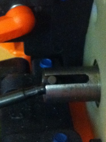

also having a lil prob with the jeepz arms
running the b4 cvds and even running front 10t shock shafts in the rear and 1/8 spacer
and im still getting almost cvd pop out from the outdrive they are staying in but man its close at full arm extension
farmer
the shock mounts can be aluminum, the shock mounting bolts should not be aluminum.
how much down travel are you using? my b4/jeepz armed car seems fine on the dogbone into outdrive area.
--Joey --
Vintage A&L and Factory Works
JKRacingRC.com
JKRacingRC.com
- Posts: 16748
- Has thanked: 33 times
- Been thanked: 1216 times
using that mip trans your outdrives are higher off the chassis than a standard stealth. that's most likely why you're having that problem.
