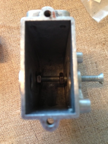

The work with removing the brushings is done. All you need is a M4 bolt, one washer and two M4 nuts. Then it’s easy to remove the brushings.
