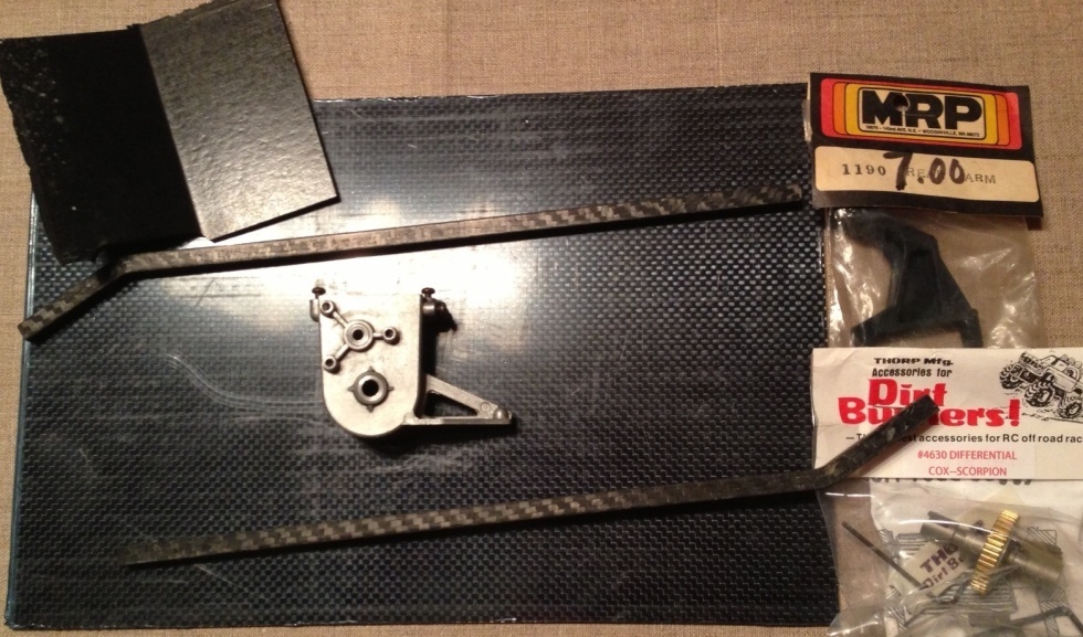

But anyway, this is the first post for a new built runner.
Sins my runner was beaten late last spring in the Swedish vintage race of two Optima’s I have been obsess with the thought to build a lightning fast Tomahawk… at least faster than an Optima, maybe even the MID and Yokomo… no, no, that would be too cocky, I have to settle for those Optima’s…
The simplest way to reach this goal would probably be more track-time for the driver…But that’s much more fun and much more of challenge to go fast with a 28 year’s old Kyosho Tomahawk that are easier to drive than practice; don’t you think?
My goal is to get it reedy to the Swedish vintage race in Mars/April (date not set yet). I hope it will be in April, I think this will take some time; I want it right from the beginning. And as always is all comments welcome.
The base for this Kyosho Tomahawk will be Mr. V’s (RetroMagic) beautiful quilted carbon rails. As long as I have known him, he has always had an urge to manufactory part because he wants to test if it’s doable. Of cause there will be some other nice stuff to in this Kyosho Tomahawk to.

Re: Kosho Tomahawk: “All” carbon fiber runner!
All good... except that stock transmission in the middle
Why don't you try something more efficient for the drive-train?
Well, I have been thinking about that. But that require a mill that I don’t have witch means I have to invest.Mr. ED wrote:All good... except that stock transmission in the middle
The original gearbox is quite nice if you adjust it right, and I have some thoughts and “surprises” up my sleeve.
Wont be a stock trans once he put that Thorp ball diff in.
Lars, you could also do it up as a Scorpion and make a nice looking faux carbon fiber tub with a hydrodipping/hydrographics diy kit. http://www.youtube.com/watch?v=V8wHglTJl6A
Either way should be another sweet build.
Looks very promising -
If You open that Thorp bag, You´re allowed to use the std. tranny
I´m hoping for a carbon radio tray and the 12mm red short shocks.
I´ll be watching this!
12mm red shocks... look nice but won't help beating the optimas either.
It think you'll have to do 2 projects Lars: one with your base idea and a second 'what-ever-it-takes' concessions build
The stealth transmission shouldn't really require a mill: The footprint is mall enough to fit the original part of the chassis carrying the stock transmission.
Tip: TLR22 rear wheels fit 12mm hexes and have serious offset. I think you can use them with new style frog axles or the old traxxas TRX1 and 3 slider shafts
Lots of good ideas, and I appreciate them all. Some time I got stuck with an idea and I can’t get it out of my head, then it’s good to have friends that point you in another direction and get’s you out of those ruts!
Tomorrow I will travel down to the country house and hopefully I will be able to make some chassis parts out of that CF sheet and drill some holes in the CF-rails. And If I want to, I can prolong the CF-rails up to 16mm compared to the original rails length. The origina wheel-base is approx 255mm; a modern car is around 270mm. And I have another idea that aloes me to adjust from standard (or the chosen length) to +5-6mm. But I don’t know if I will gain any thing by prolong the CF-rails? So I need some advice guys...

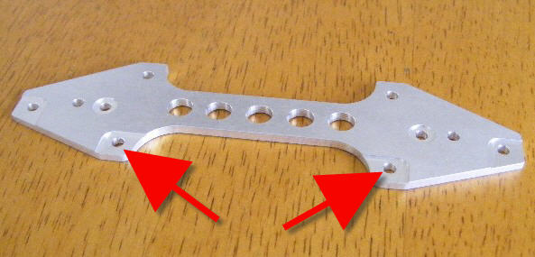

Lars, glad you're calling me a friend, and by the way: you spelled Kyosho wrong in your topic title
Another tip:
On my ghostrider I used some different rear-arm carriers: similar to the ones on an rc10. By doing so I can alter the toe-in and lean-in angle of the rear wheels.
Another tip:

Re: Kyosho Tomahawk: “All” carbon fiber runner!
Yes I see you as a friend Erik!
If I make this holes a bit oval I will achieve that effect right?
Thanks Lars, glad you 're not my enemy
Oval hole
to difficult to get the set-up symmetrical, and even more difficult to keep it that way when running.
Oval hole
Man… now you gave me a headache and my wife gone get you for that...
- Mr. ED
Nah, don't worry about it: the stock set-up was probably tried and proven to be just perfect by the kyosho engineers in their days. So no need to make it adjustable
Goodnight Lars, and Mrs Lars
