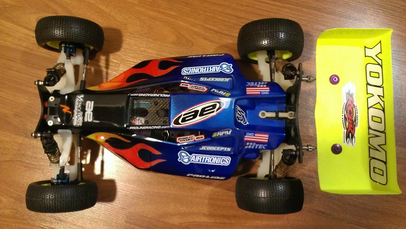

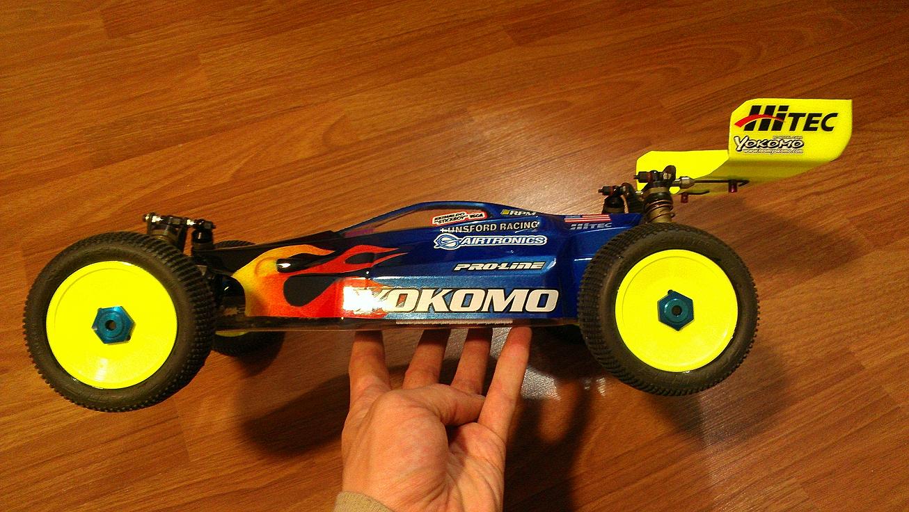

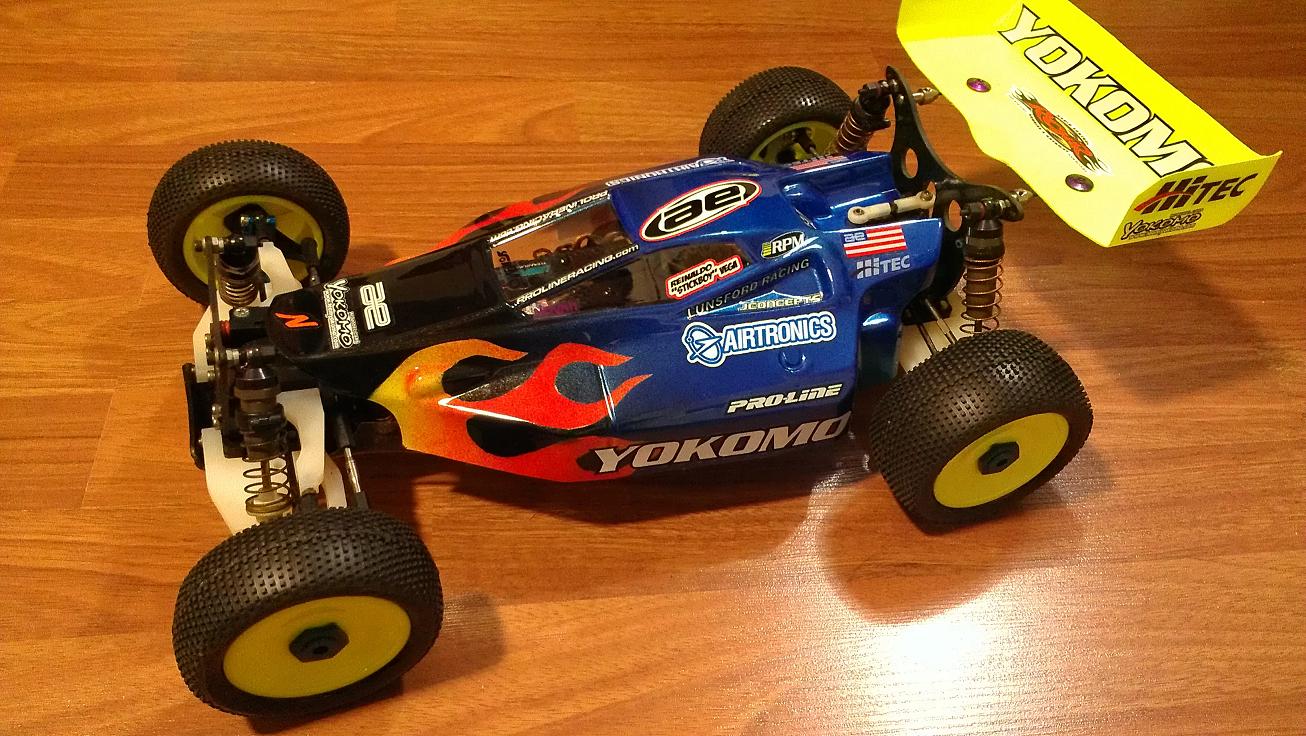

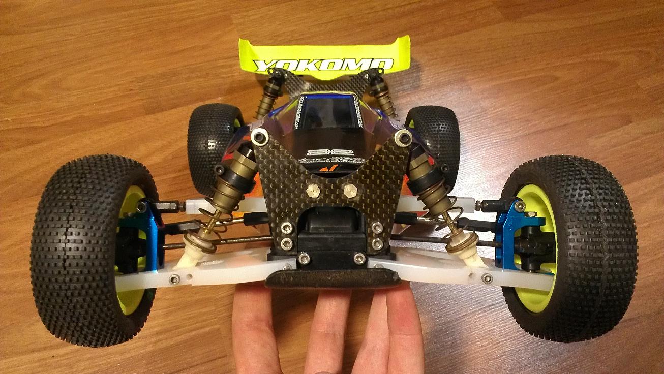

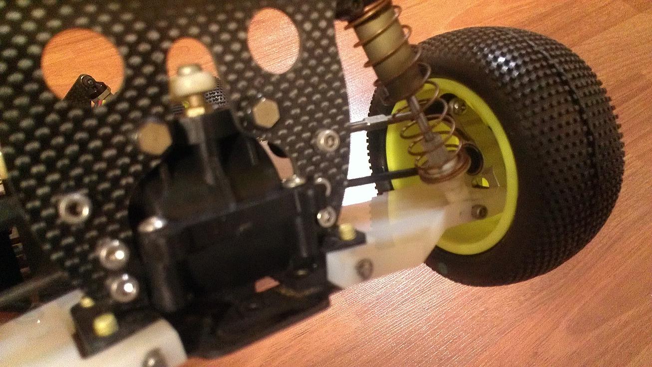

Arms installed. Pics below (despite the Pavidis towers, this is a '94. I got the towers from eBay). Had to widen the inner and outer hinge pin holes in the rear, and the inner holes in the front, by just a bit with a Dremel. Also needed to shave the shock mount opening a bit, to fit the ball end that mounts into the bottom of the shock. Looks pretty good...
Since these arms are flat, as opposed to the stock arms which have kick-down, the ride height will be a little lower than stock. The reason the stock arms have kick-down is to enable more droop, since the kick-down basically wraps the arms around the ends of the chassis which otherwise blocks straight arms from traveling down further (the 870C has this problem and is partly why it does not jump well). This gives more suspension travel upon landing, and also allows the front to rise up more when accelerating up a jump, which in turn should keep the front from diving mid-jump.
One **could** shave the chassis at the rear of the front arms, and the front of the rear arms, to bring this level of droop back with the Dynotech arms (similar trick can be applied to the 870C to get more droop, since that chassis uses straight arms. I've done this - it works). I want to keep my '94 chassis as-is, so I opted not to do this. In any case, the ride height is pretty reasonable and comes in close to my B44.
Overall, I'm happy with the arms. The feel very solid and they add a great look to what is already a beautiful chassis.
