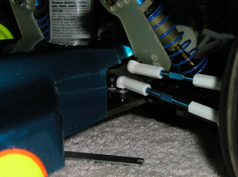

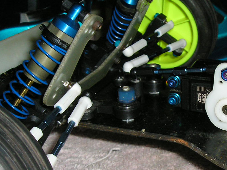

Hi ra272,
Yeh, it's a problem on my car for some reason. If I have the suspension on full droop, I can get full lock (say right), but I can only get the wishbone to about level before the ball joints hit. If I force it higher, the fouling forces the steering to go straight ahead! :shock:
It's not just touching a little, its a lot!
G

Well perhaps Jconcept ball cups are not as big as Losi's:
This is the only position with contact (fully compressed, 20° steering)

Mmmmm, I guess thats the problem, the Losi ball joints are WAY long, nearly twice the length of the original white AE ones. If I have my steering the same as yours, the inner camberlink ball joint hits the steering ball joint, not the turnbuckle. I guess I need a shorter inner ball joint.
I might move the tower forward too on the blocks, it won't do any harm, and some short neck ball studs should top it all off :D
Do you race your car? Have you found 20 degree castor blocks the best?
Thanks again,
G

I'll race this car as soon as possible (indoor races of my club are canceled because of some administrative problems...).
For information, I have cut those Jc cups (5mm or 1/4 inch).

Thanks, have you cut them so they are a similar length to the std AE ones?

I used JConcepts, no binding like with Losi or RPM. Either use JC or Associated. AE makes long and short if you have turnbuckle length issues. I am using the World's Car bellcranks, which place the steering balls more towards the rear. But I see you've got the old MIP steering, which is basically the same... :?

Well, I milled away the triangular blocks to move the shock tower forward, and with some 20 degree (I think) castor blocks fitted it fixed my problem without having to cut down the Losi balljoints or fit shorter ones. :D :D :D
