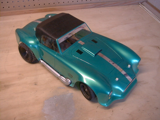

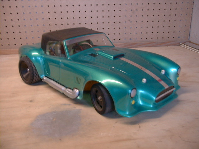

Here is my parking lot car which I put together just like the one I used to club race before the DS was released. I'm still experimenting with tires (back then I ran "waffle" pattern tires.) Compared to the actual 289 Cobra which has a 90" wheelbase the Parma body is actually 1/8th scale.

if you wanted to get some rubber street tires tucked up under that body nicely, and want to experiment, try these:
http://www3.towerhobbies.com/cgi-bin/wti0001p?&I=LXNUA8&P=M
http://www3.towerhobbies.com/cgi-bin/wti0001p?&I=LXNTK7&P=M
http://www3.towerhobbies.com/cgi-bin/wti0001p?&I=LXNTL0&P=M
with these on the car, you should get close to a 8 3/4" wheelbase front and rear, which should fit under the car pretty good (i'd think).
now as with anything else, to make new stuff fit, you have to change other stuff. so first off, because of the offset of the rear rims, you'd need to cut down the hub carrier so the rim doesn't hit, and lower the camber link hole. then convert the rear axles to 3/16", with either new stub axles or b2/b3 cvd's. you'll also need (4) 3/16" x 3/8" for the rear carrierrs and (4) 3/16" x 3/8" plain bearings for the front rims.
or, if you don't want to modify your old hub carriers, you could use a pair of the old losi h-arm carriers (a-2038). you'll need (4) 3/16" x 3/8" plain bearings for those.

Thank you buddy. I'm mounting rear foams which should work well on days when the club sprays the track. Treaded rubber looks so much cooler thoughscr8p wrote:if you wanted to get some rubber street tires tucked up under that body nicely, and want to experiment, try these:

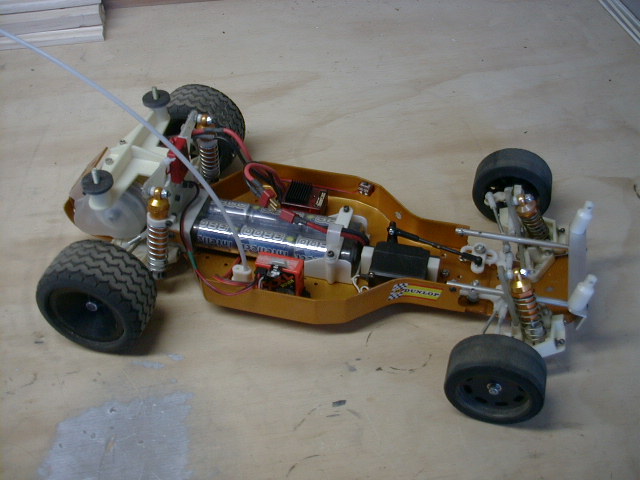

Re: DS wanna-be.
Here are some Pics of the Dual Sport, I bought this car when it first came out and kept running it up to the time I stoped racing about 10-12 years ago. After that it just sat in the rafters of my bacement along with my other RC stuff.
Got the itch again when I could not race the big cars for a while so I dusted off my old stuff, bought a new 2.4 radio and we are going to go RC racing again, and yes I am going to run the RC10 in the background with stock buggy.
Anyway here are the pics

Re: DS wanna-be.
Very purposeful looking. I assume that the car was originally built using a conversion kit, since the tub is gold. I like it.

Re: DS wanna-be.
Hey Cherokee, nice DS there, I was wondering what kind of wheels and tires combo you used on your runner and what kind of modifications it needs. I also noticed you have special frontspindle carriers, what are they? Last but not least, I'm on the hunt for the exact same "Goodyear" decals, do you have more or somewhere I could source them? Thanks!
