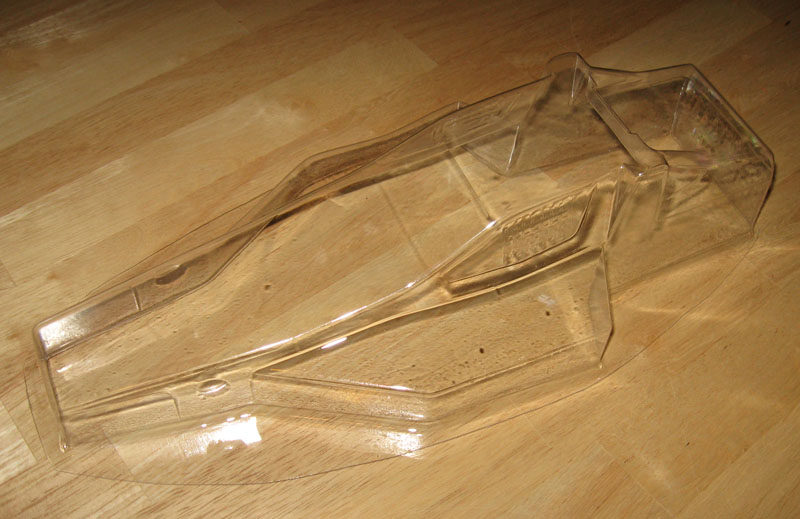

Hi,
I'm a new member here and this is my first post. I've been into hobby grade RC cars since 1986. I have two original RC10 gold pans, an RC10T and an RC10B3 team car, along with more than a dozen other vintage cars.
I'm in the process of building a vacuum forming system, primarily to repro a NIP Turbo Optima body. I've been experimenting and working the bugs out with an RC10 Viper body, so as not to ruin anything irreplaceable. Ultracal-30 works very well. Attached is a pic of the Viper mold from Ultracal-30. Please ignore the color variations; the mold is very smooth and it picked up all the detail. I didn't use a release agent and the mold was a little difficult to get out of the body. It didn't damage anything, but to make things easier, next time I'll use some sort of release agent like spray Teflon, etc.
Regards,
Robert
Regards,
Robert

Some repro success!!
After about a dozen vacuum attempts and building a new heat source, I finally got some good results. Below is a pretty nice repro pulled from the mold I posted before. Almost all the detail has been picked up. I think just a little tweaking of the mold and/or process is in order. The material is 0.030" thick PET-G (the stuff 2 liter soda bottles are made from). I chose that for my experiments because I knew I'd be scrapping a lot and it's about 1/4 the cost of polycarbonate. PET-G behaves similarly during heating and vacuum forming. There are some air bubbles in the formed plastic, which is to be expected, considering I didn't dry it. That's my next job: build a drying box for the polycarbonate and PET-G. The plastic sheet needs to see about 150 F for several days prior to vacuum forming.
Robert
Robert
