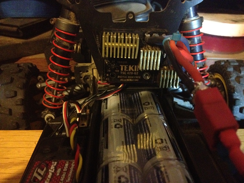

Woohoo got the Pro-SE going! After the g9 esc lost the ability to power on I figured I would be SOL until I bought another good one. That lot I bought in town had a couple 410 g2 escs in the tackle box that looked rather roasted and once I popped the cases they looked bad inside as well. Well after doing some testing one of them actually seems to work more or less. Yay! Although the g9 dying was really annoying as it was working perfectly in the Mini T, it will still function however with an external battery pack but that is somewhat against the point :p
The motor seems to be working pretty well considering I had to put the 12t double armature from a Kyosho Atom Smasher into a spare losi revolution motors 3 piece case. The Atom smasher case was quite corroded and required hammering out the timing ring to get everything apart. No idea what the original armature was in the Losi motor or if I even managed to get it back together and timed in ok for a basher motor as there are no timing marks on the losi case.

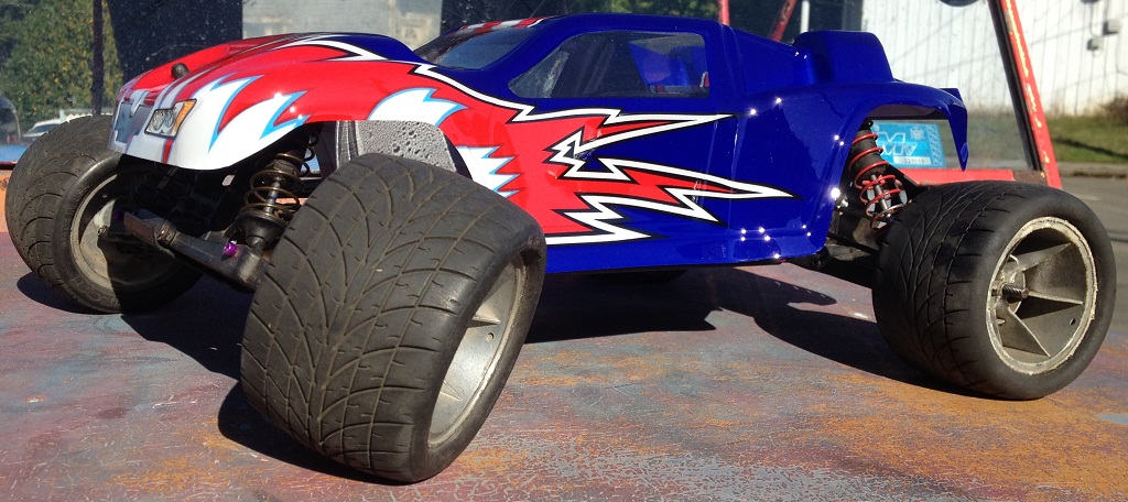

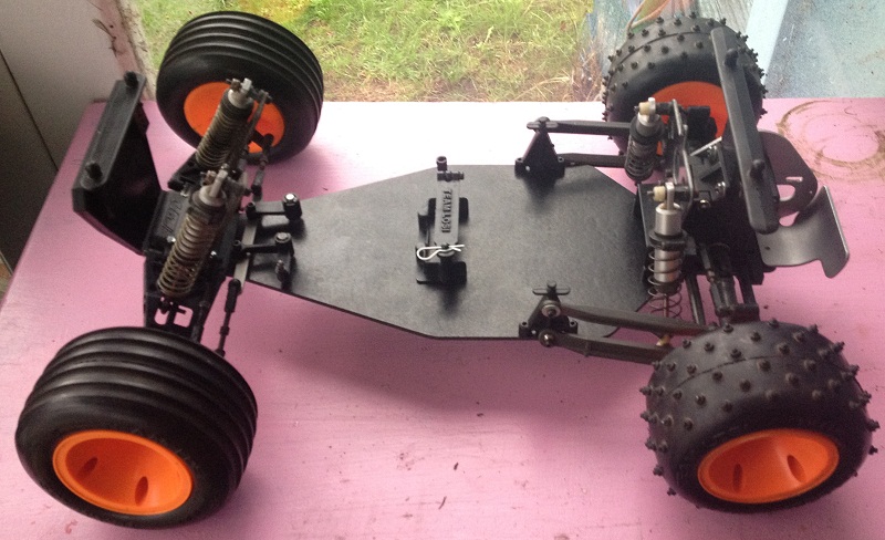

Just received a front body mount in the mail so thought I would try the free evader body on the XXTG+. I kind of figured the G+ XL chassis would be too long for it and I would have to switch back to the shorter one... not so! The body dropped on with the holes drilled perfectly! I do need to find some decent losi stickers for it as I don't want to disgrace it with Evader decals... other then the grill and headlights of course lol
I do wish I could find proper XXT bodies however.

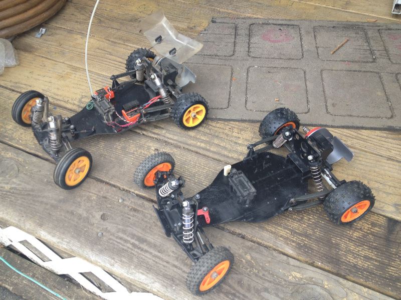

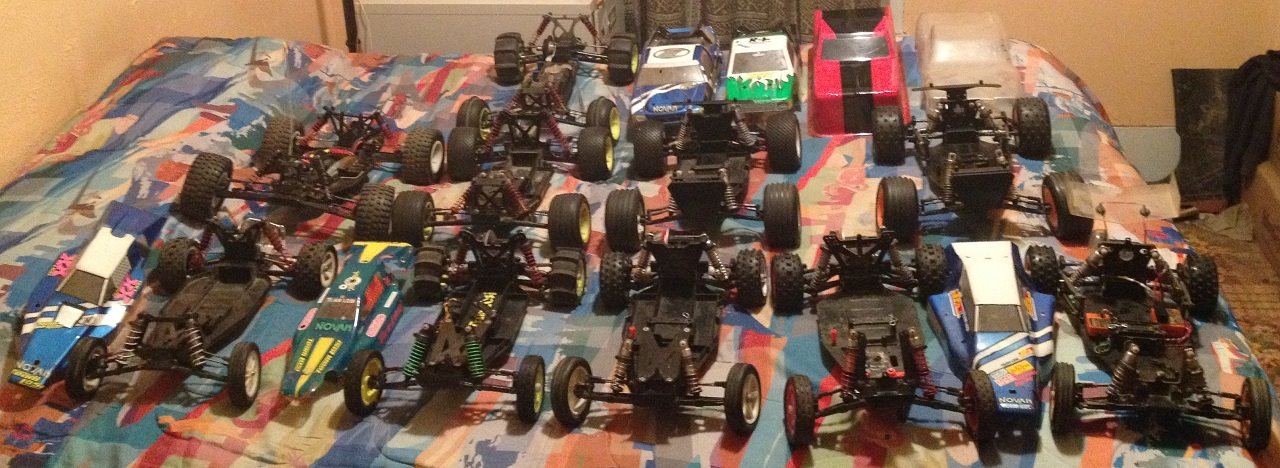

I managed to get all my jrx based cars (and my two XX's had to butt in!) rolling and decided to take a nice group photo :)
Need to replace the chassis on the lxt and proSE or find better examples... but they fill the holes for now. I would also like to find better JRXT and PRO chassis plates... but as with the others, what they have now will work for now.

Your original trailing arm JRX looks great, I've been looking for one like that to buy for sometime and they are hard to find. The condition of yours looks really good. Have fund with it!

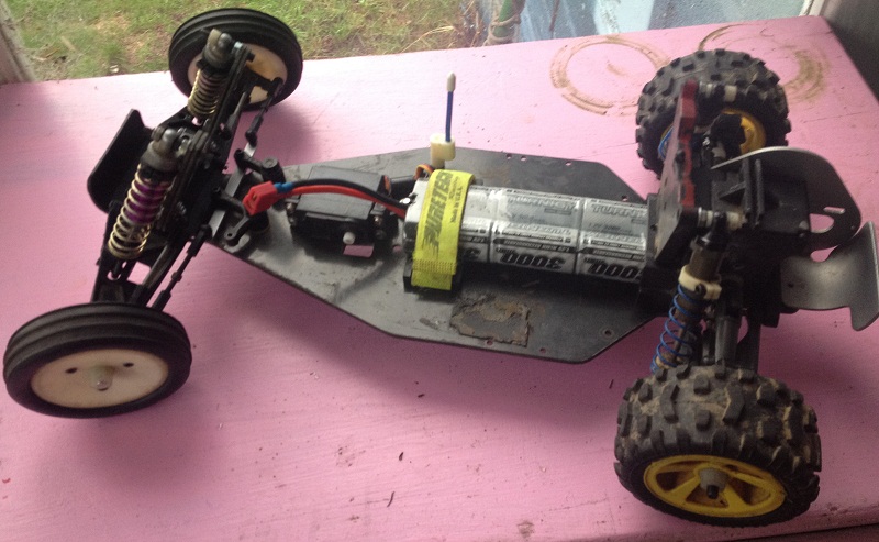

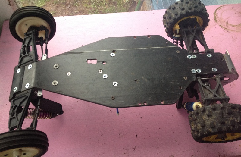

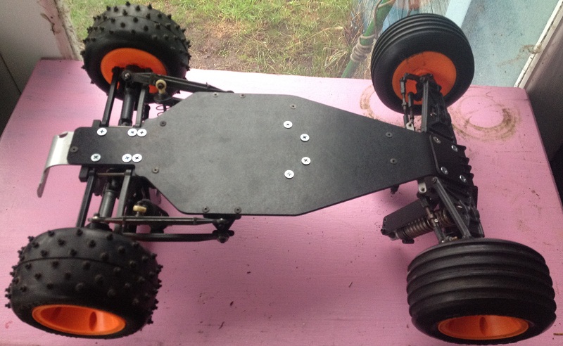

Well I got a new chassis plate... so used it on the Jrxt
I am amazed the thing is looking nice! I do need to find another 5 link shock end and I only have one, but it works ok for display.

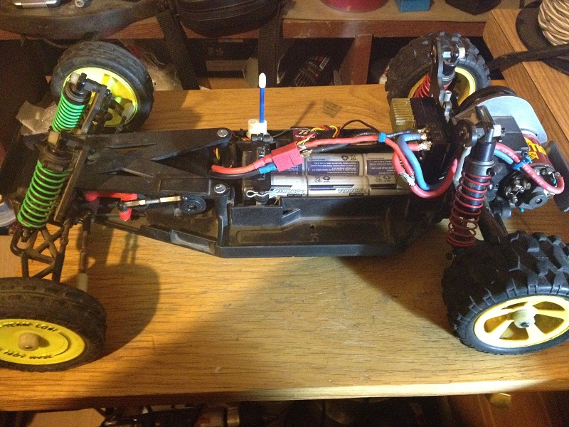

And I started making a beater out of the spare losi parts I had piling up... I am going to get a waterproof receiver box for it from an evader and possibly a castle creations sidewinder v3 for it for the ultimate in hose-off ability :)
It has rpm bellcranks and front bulkhead along with a traxxas bumper... that bolted right on O.o It has a set of 10t front shocks on the back and trinity long shocks on the front right now. I will probably eventually get b4 wheels with dirt hawg tires on them and a junior 2 body... I am tired of thrashing one of the cars I am trying to collect ;)

Which traxxas bumper is a direct bolt-on? I can't tell from the pics.
klavy69
Moderator
Posts: 5208
Has thanked: 639 times
Been thanked: 294 times
Re: CLM's Losi Collection and rebuild thread
Post by klavy69 »
shirochanwrx wrote:Which traxxas bumper is a direct bolt-on? I can't tell from the pics.
looks like its part number #2735 front bumper. Found on alot of vintage traxxas stuff along with several models that still survive today like the rustler.

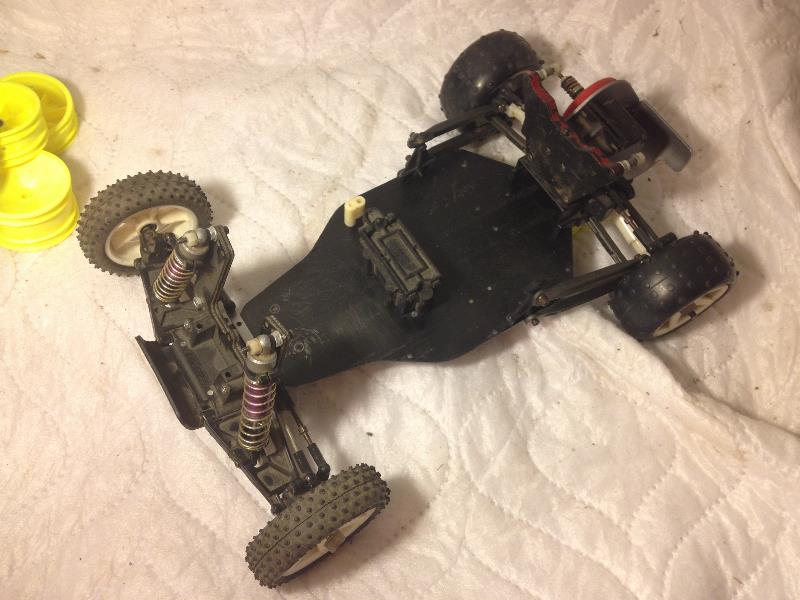

Just recently I managed to get A pile of parts from fellow board member that included a new unused slimline molded chassis! Yeah! Now I am only missing one slimline chassis and a Jrxt/Pro chassis from having new chassis on all the Jrx cars but my original x2.... But... When the package came in It was not the chassis that caught my full attention it was the pile of early x2 parts.
I immediately tore apart my 'beater' Losi buggy and started building a Jrx2 Runner. I think I have come to the decision my two vintage runners are going to be this jrx2 and my beater 10t/t2 meld.
Well, I am missing an appropriate rear shock tower and apropriate shocks from making a roller.. well that and front wheel bearings >.> It also requires some steering posts and the L shaped bellcrank. I was unable to reuse the bellcranks from the lwb chassis as the RPM ones require drilling the chassis..
I would love to find some RPM front arms for the Jrx2 in a used state so I am not afraid to run them ;)
The plan right now is to put a pile of Sabula tech parts on it for non stressed parts, I will need to use the lower shock mounts as it is and that worrys me somewhat. But heck plans change as we all know so only time will tell how it turns out!
