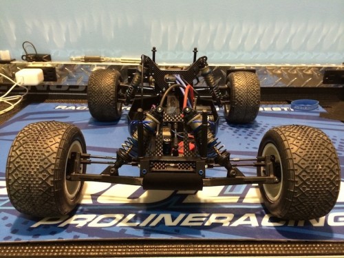

Made a few changes on the ball cups and shock towers, tires need to be glued up but its ready for its first run after being updated. Just need my batteries to arrive, as i decided to go with shorty packs so i don't need to modify the chassis or battery cup.

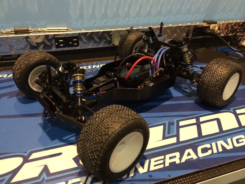

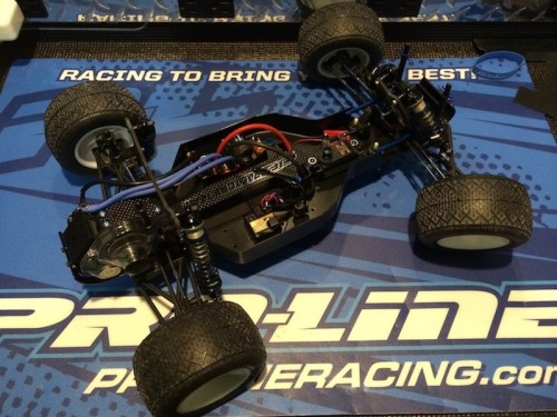

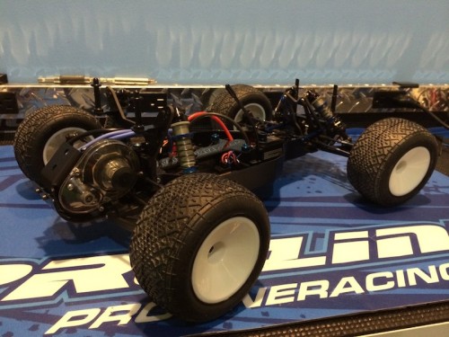

Here are a few more shots.

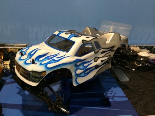

With body on

Awww, modern body???

Yea using what I have for now. Didn't want to spend extra on a body since I had this one being painted as a spare.ca-rj wrote:Awww, modern body???

Awesome build, thanks for sharing. I have one of these in parts too, very good inspiration (except for the body
). How are you mounting the shorty packs and do the big bores pass the shock towers?

I'm just using foam battery spacers to keep it centered for balance and a B4 carbon battery brace to hold it in place. For the shocks I used Avid shock mounts with a 2mm spacer to keep them away from the shock towers and a 4mm spacer on the rear shocks at the arms to keep a decent angle.just wrote:Awesome build, thanks for sharing. I have one of these in parts too, very good inspiration (except for the body). How are you mounting the shorty packs and do the big bores pass the shock towers?

when I run my shorty packs in my 10 (buggy), the foam isnt needed, as long as the battery strap tucks under/inside the rear bulkhead "cup". I run my packs full forward, against the servo.
