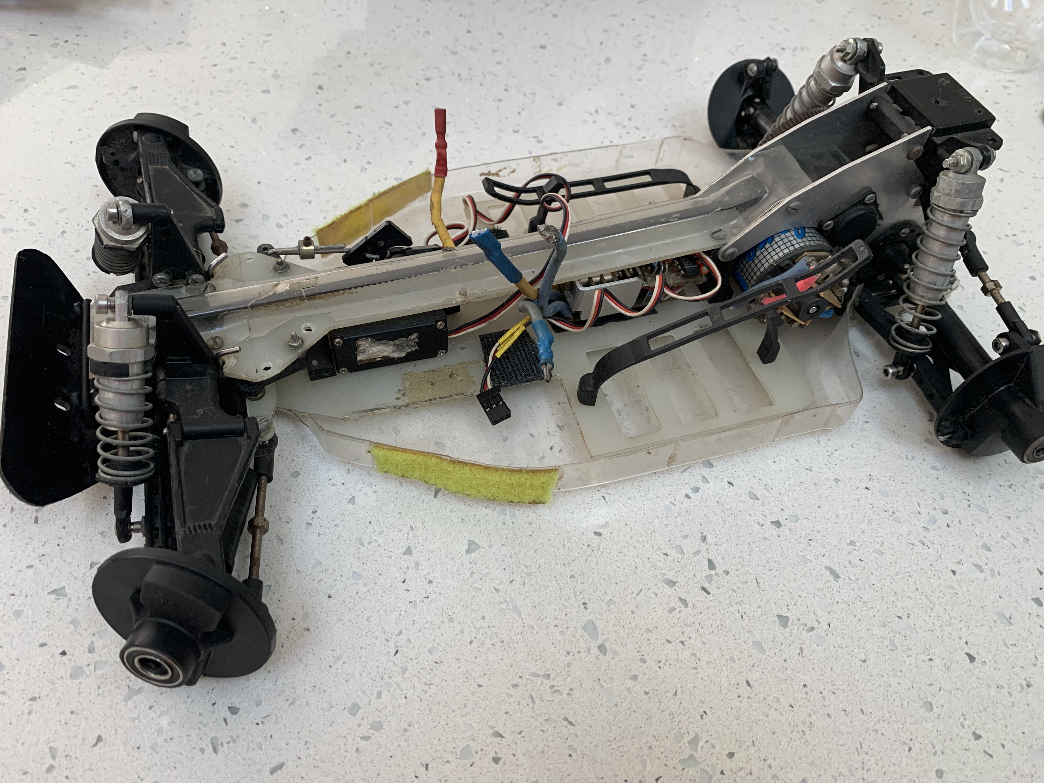

What started out as a rebuild on a procat I picked up from the Uk a few years ago
Has as usual gotten out of hand and turned into this😱

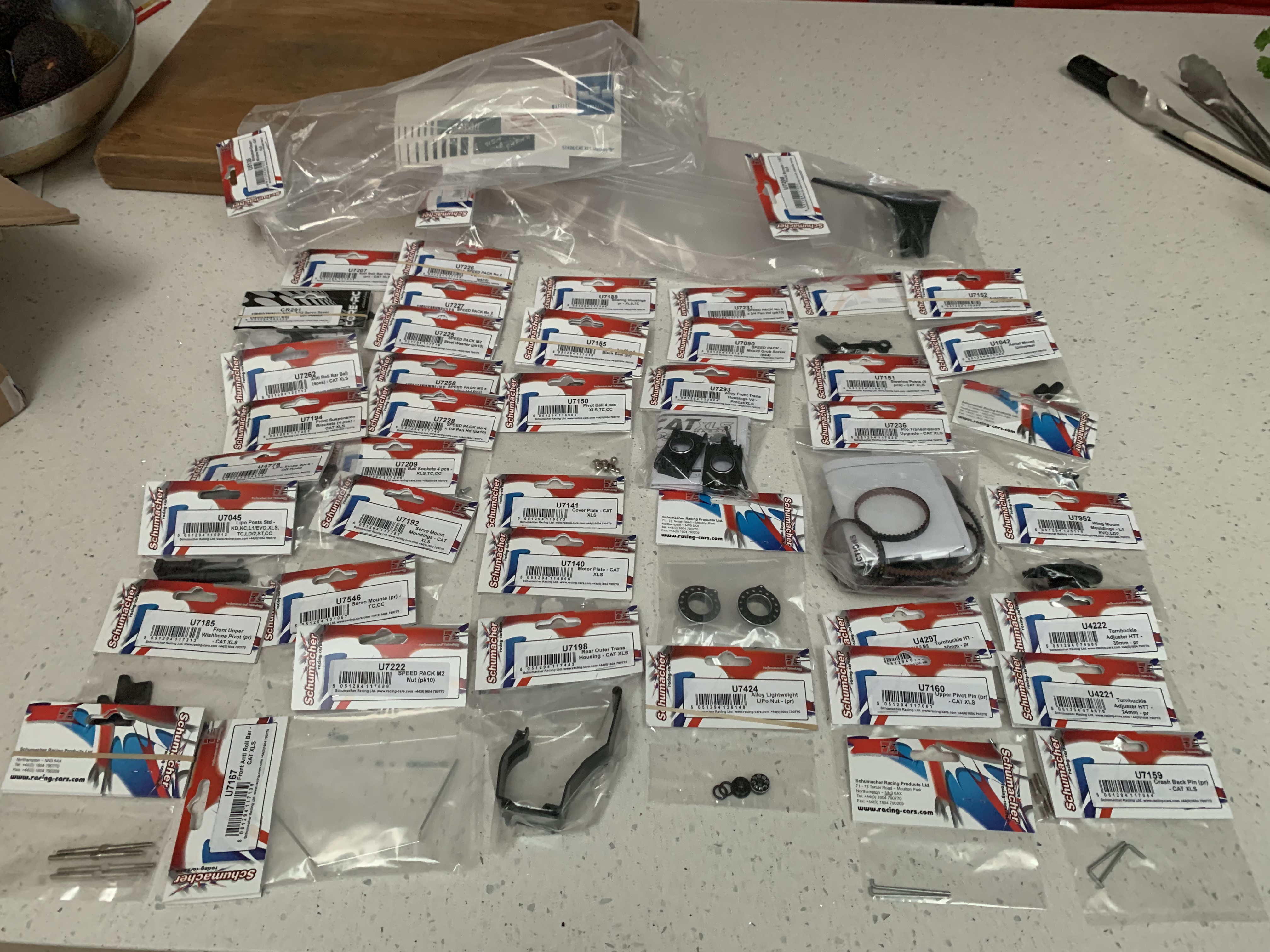

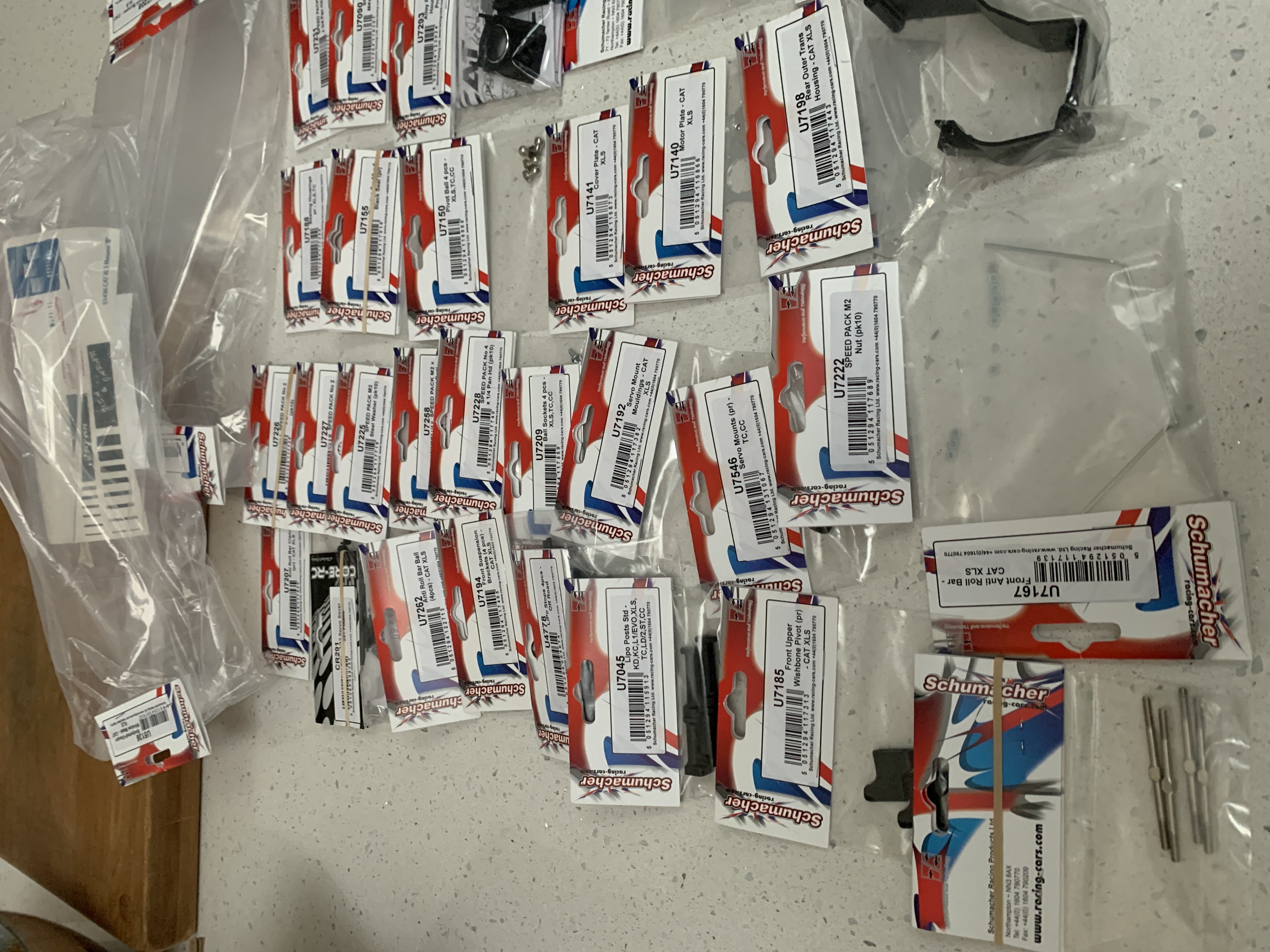

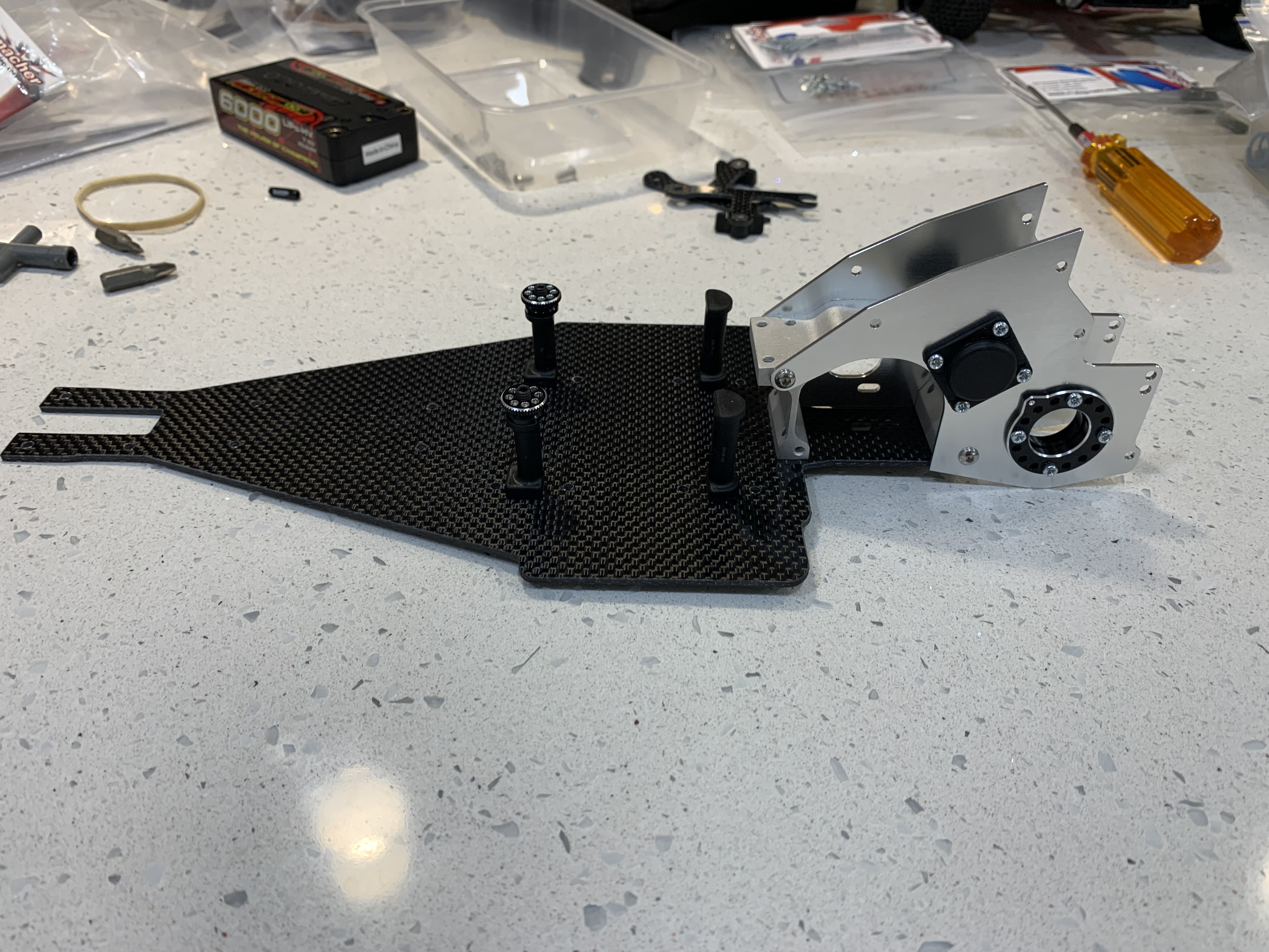

So into the build we go
Started off with the new chassis from fibrelyte, is a modded version of their XLS saddle chassis with the saddle cutouts deleted and holes for the masami saddle setup drilled, and has 3 different locations available for weight distribution changes.
This chassis is also set up for the original release procat xls rear gearbox inner housing holes not the re re.
Stage 1 parts
Stage 1 parts
I managed to find the alloy inner gearbox housing a few years ago new and unused and am using the re re alloy bearing eccentric’s as well.
Stage 1 done

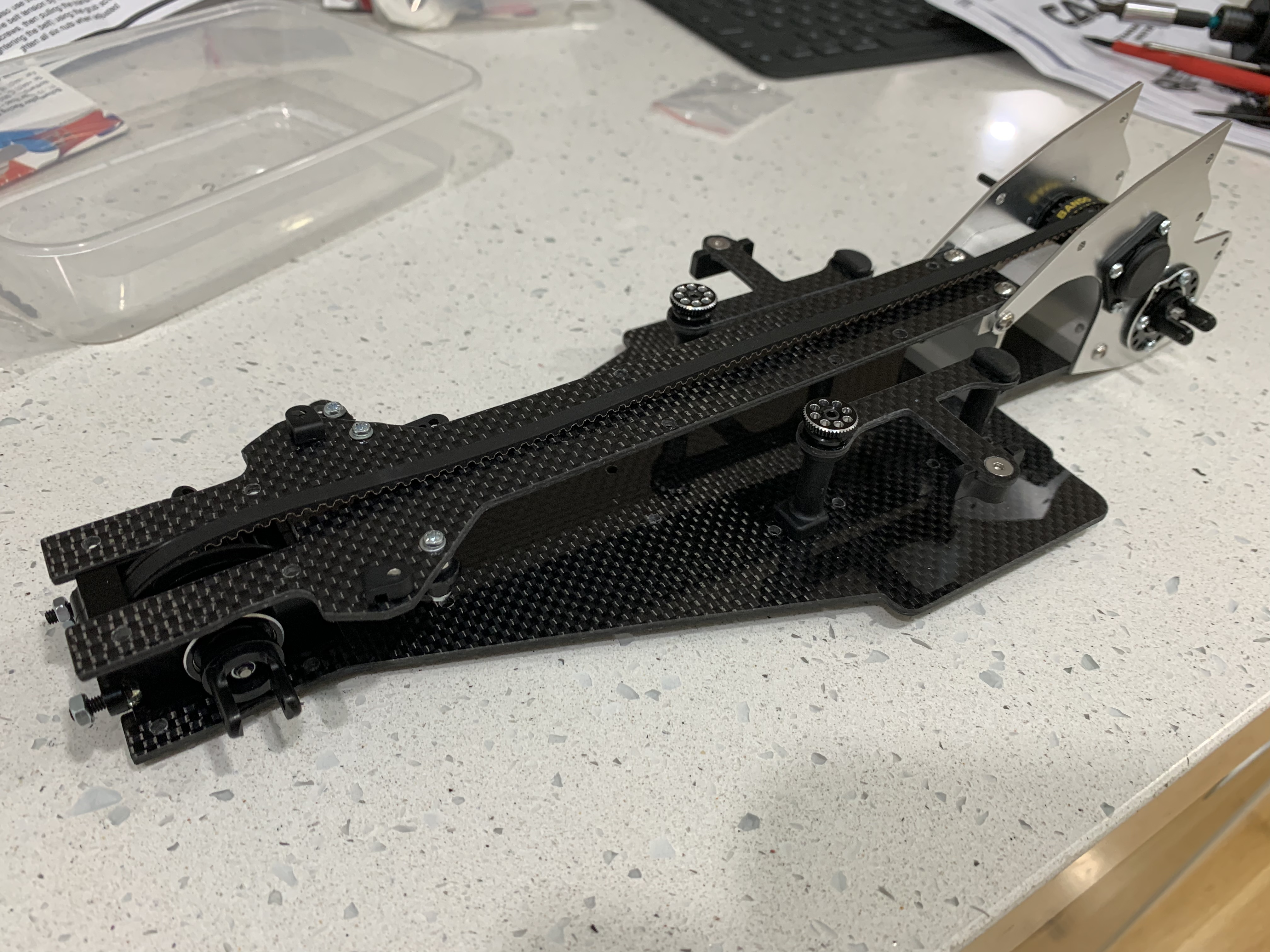

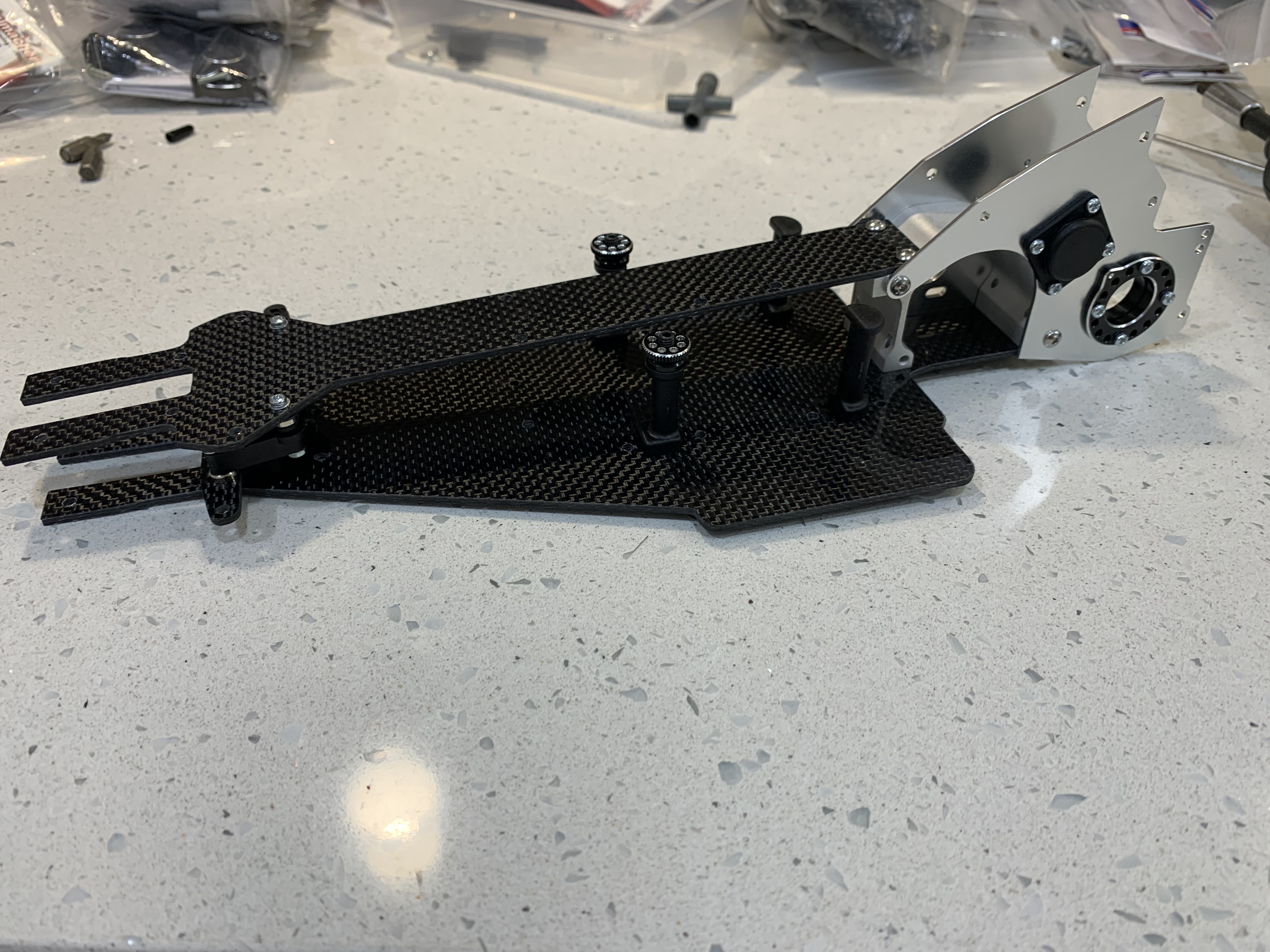

Post by Retro rc »
Stage 2 top plate and steering setup. Unfortunately I still haven’t got a ball raced steering setup yet but will have 1 on it some day😬
Stage 2 parts
Stage 2 parts
Together and installed

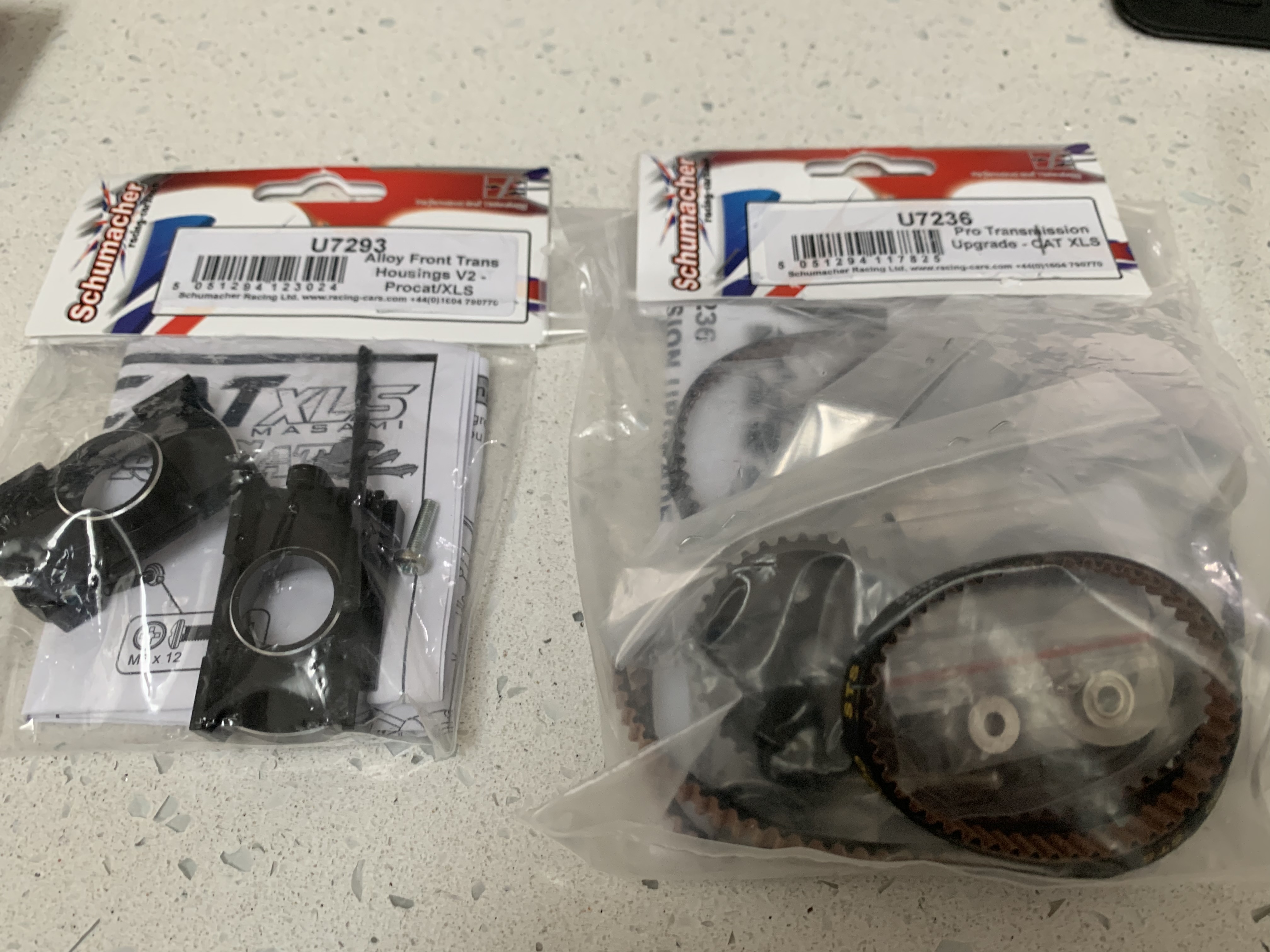

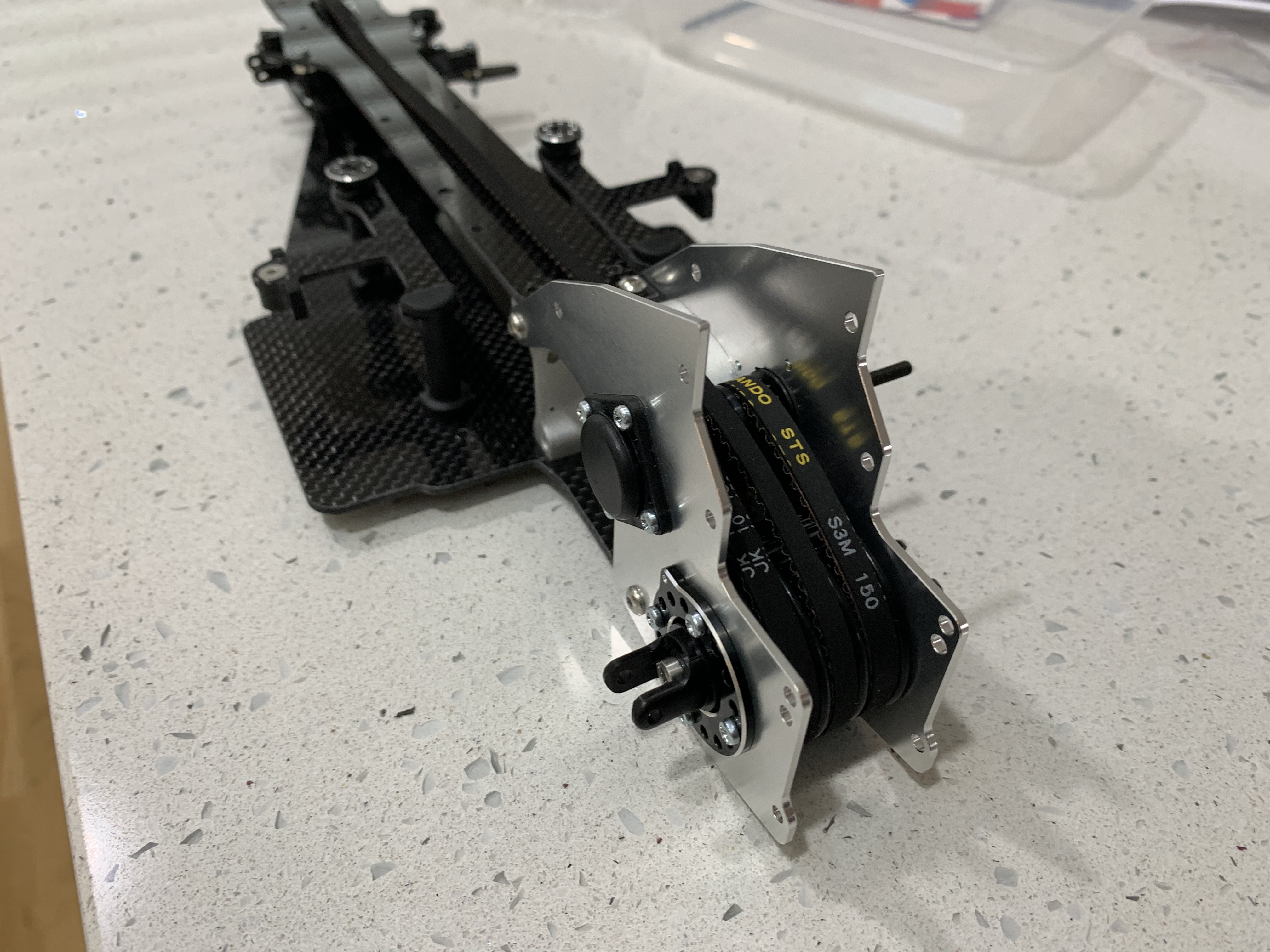

Stage 3 transmission time.
I’ve gone with the pro transmission and alloy front gearbox as this is going to get run. Haven’t taken any of the build shots of the trans but here the installed product
