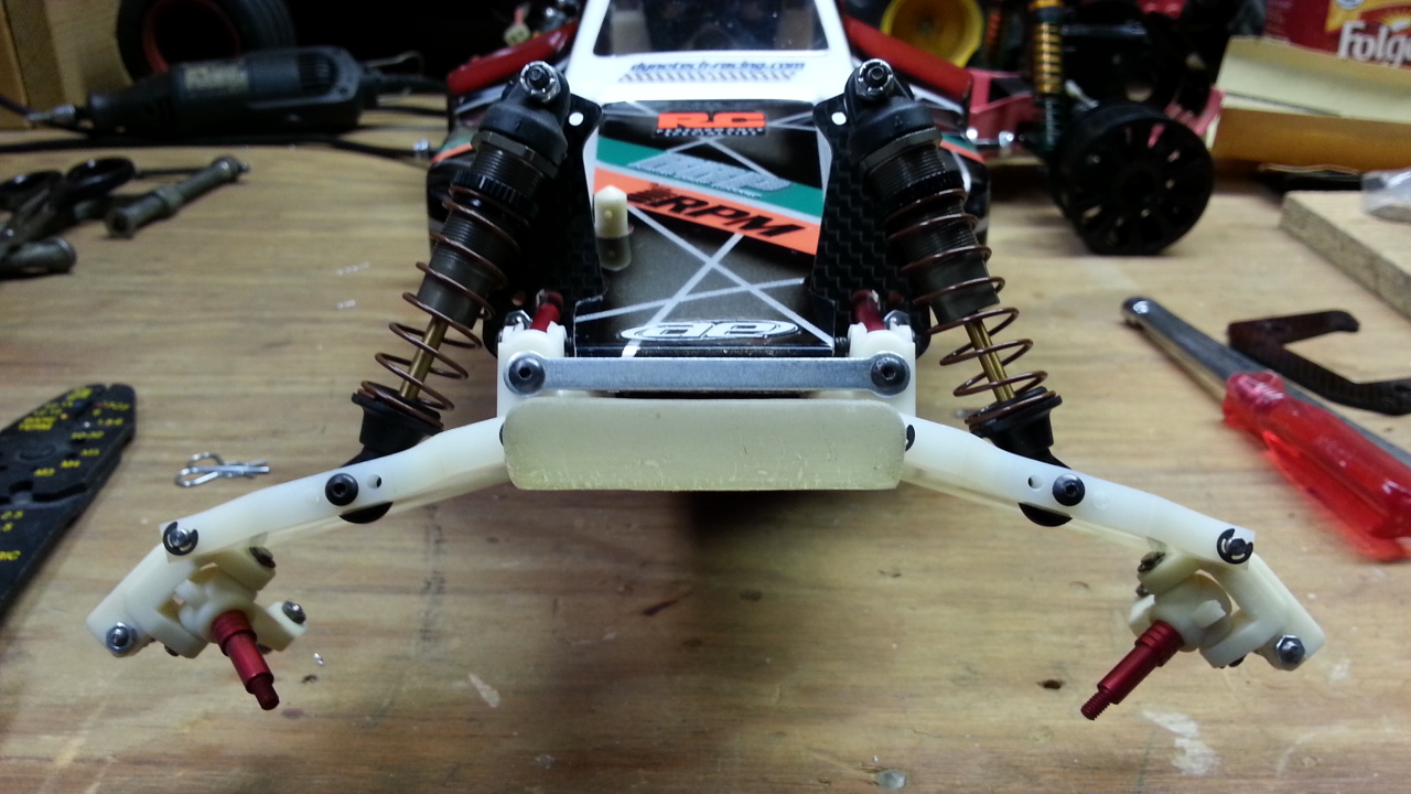

Sean, is this about what you'd like to see for down travel? These are .89's with no limiters.

Re: my graphite rpm worlds WOIN build
i wasn't questioning your knowledge of suspension travel, i was asking if that amount of droop is good for you.Orange wrote:I have the concept of down travel/up travel... I have been racing nearly 30 years now. Thanks for the lesson tho!

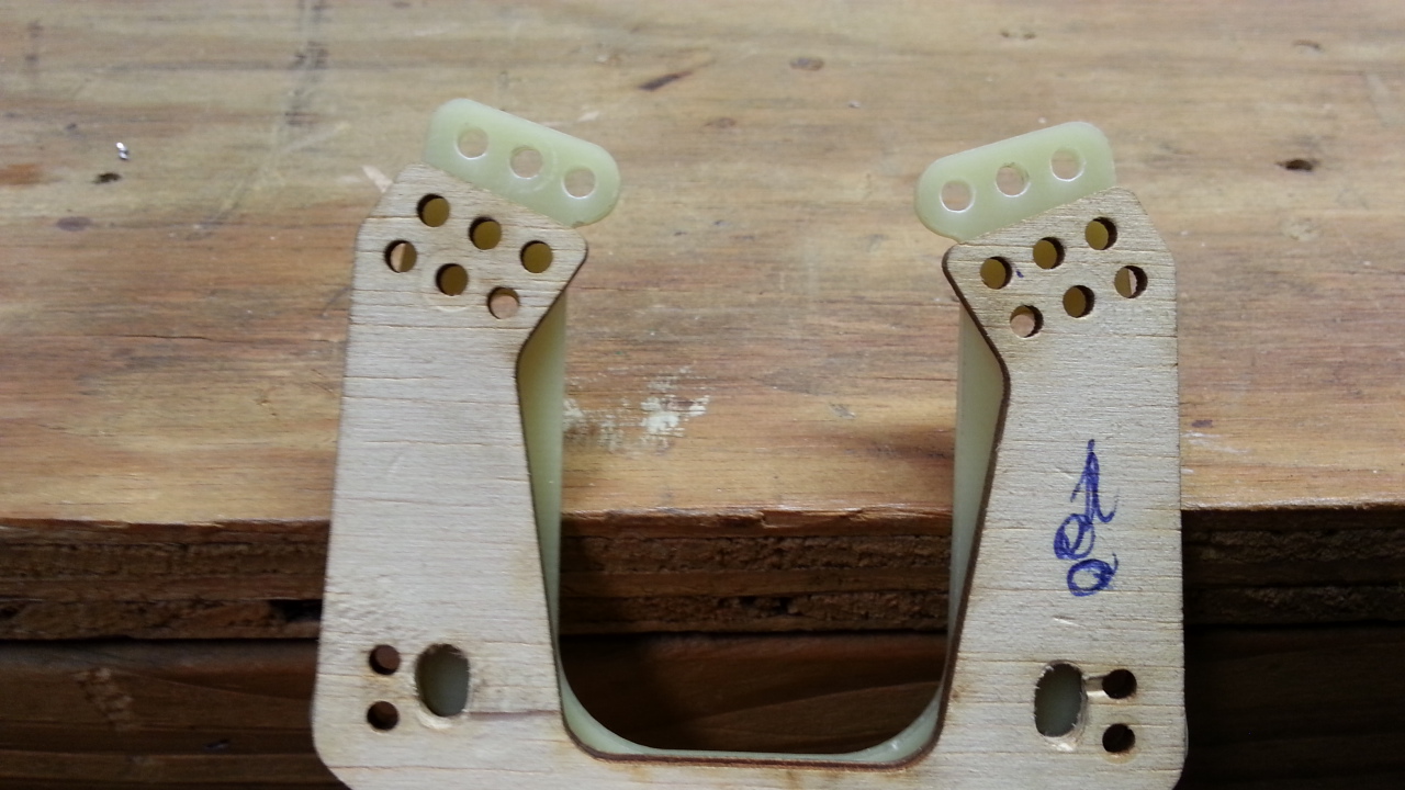

i asked your opinion about the droop to show you this:
this is my prototype .89 tower over top of a c.c. worlds front tower. when i designed my tower it was supposed to be .89's up top, .71's on the bottom. well, something got lost in translation and the bottom ended up becoming .89's, so the top row was removed before the file was finalized and my tower was cut. take notice that the holes on the c.c. tower that are "supposed" to be .71 holes line up almost perfectly to the .89 holes in my tower. i could put that c.c tower on my car and there's be like zero difference in the suspension travel.
there's also plenty of room to the outside to add another hole if it was wanted. you could even use a b3 as a template to add the outer hole and reshape the tops if you wanted to shorten it.
but i get the fact that you want a direct fit tower. maybe one day something will be available. i'm done hi-jacking this guys thread now.
Someone should produce one of those in carbon fiber. I'm sure it would sell, I know I'd pick up a couple

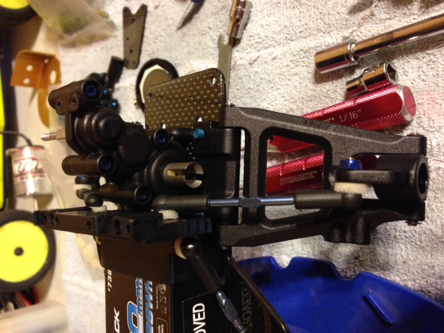

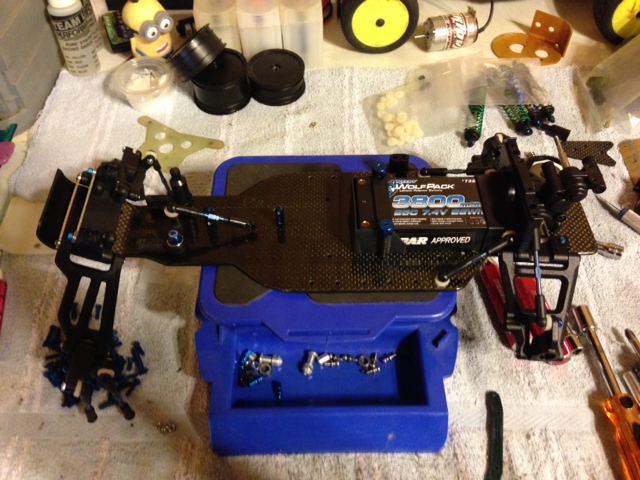

got my parts dyed and started final assembly still need to buy shock towers and decide what im doing for steering bellcranks but its making headway
Looking good! Black, carbon, and blue always look great on an RC10.
Are you not going to use the bell cranks on the chassis in the photo? I have the same bell cranks and really like them.
glastornjet73, car looks really good. If you are planning to race this, in my experience your battery position is not good, I run my shorty pack full forward, against the servo. Love the feel of the shorty in the RC10, really has the car feel nimble.
thanks guys! i was going to use those bellecranks but they are the houge ones that someone has modified to use the a&l rack. i love the way it fits the car but i sanded and buffed it and when i did the dye from before when it was died black started to come off. i tried re dying it and it just wouldnt take any color so i dont know what i want to do with that yet. i might get the rere worlds style bellcranks associated re released or i also have a set of the houge ones that have not been cut up to use the rack but i need to get another blue turnbuckle to link them togeather. seeing as how i used lunsford ballcups and i dont want to use the rpm 1 peice steering link i know im probly too anal! but i like my stuff perfect or at least perfect in my eyes lol
i probly will race it but im going to put a full size lipo in it or use saddle packs reedy came out with a lipo that looks like a nihm stick pack i think im gonna use to kinda blen the old with the new look... plus im pretty sure its shorter than a typical lipo and will fit the chassis without re drilling holes and moving the battery foreward but i will cross that bridge when i get there
+1JK Racing wrote:glastornjet73, car looks really good. If you are planning to race this, in my experience your battery position is not good, I run my shorty pack full forward, against the servo. Love the feel of the shorty in the RC10, really has the car feel nimble.
It makes a huge difference in the handling of the car. I won't even drive mine any other way. Its just that much better.
