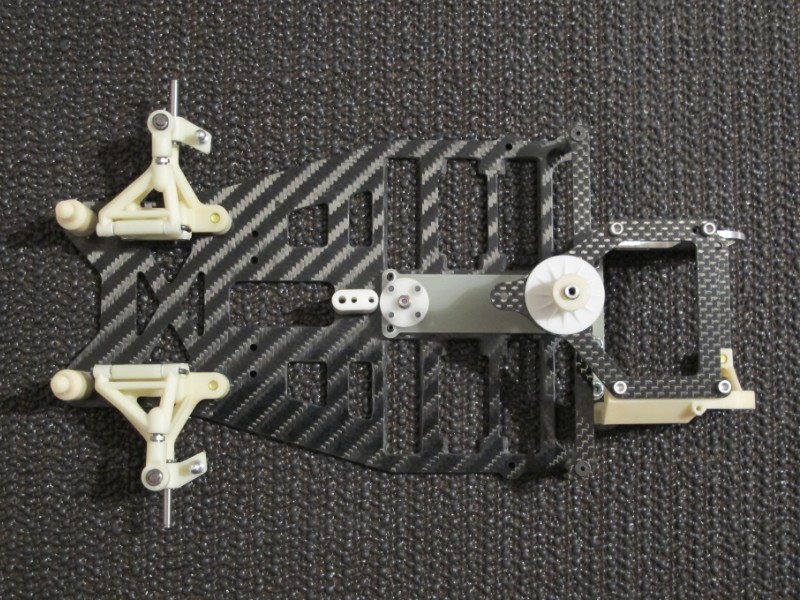

Adding the parts to the chassis.
Hinge pins mounted reverse, used by Phil Davies this way.
Need some front end springs for finishing the front end. Hope to continue in the evening.

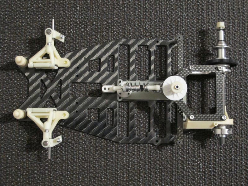

Re: RC12LS 1995 Euro Champs Special
Steering blocks, king pins and springs mounted, also aluminium ball studs for steering setup.
So frontend completed now.
White bodyposts for the front added.

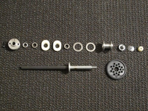

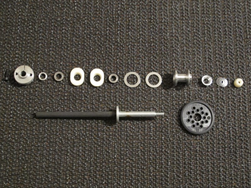

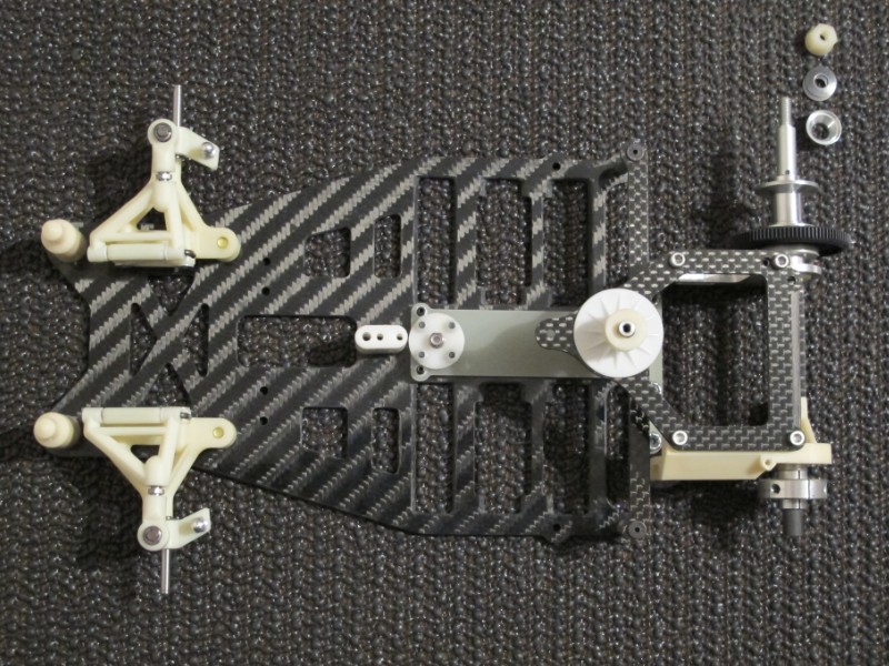

Next step is rear axle/diff assembly. Parts shown at the picture will be used.
Rear axle and diff hub are Stealth 1 version.
A special clamping hub will be used for the left side, one of the special parts used by Associated team drivers.
For the spur gear I was not sure which way to go, I just know Phil used a black 64DP spur. This means no Associated spur as their "Precision Spurs" were not made as 64DP. A period correct black 64DP spur would be Kimbrough or Dumor, both also popular choices by factory guys. And the spur needs working with the small diameter Stealth diff rings.
I´m not really sure if there is a difference between a Kimbrough spur of 1995 and a current one, so I will go with a Dumor what have been left from those days.

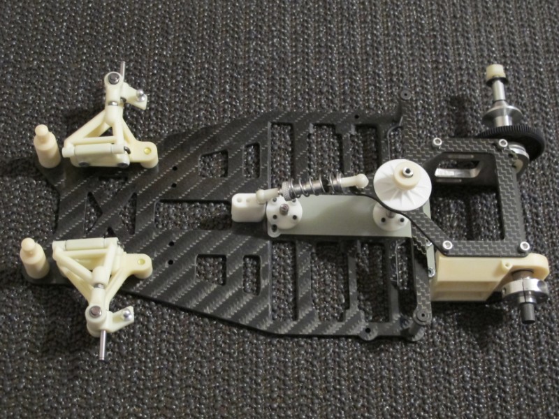

Diff assembled and mounted to the RC12LS. Diff cone, belleville washers and diff nut will be added after mounting of rear wheels. This is a final step.

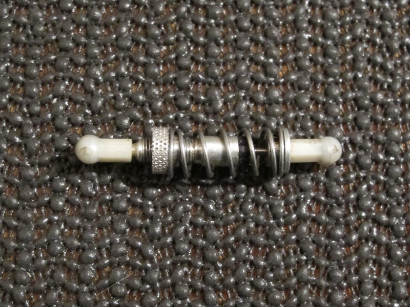

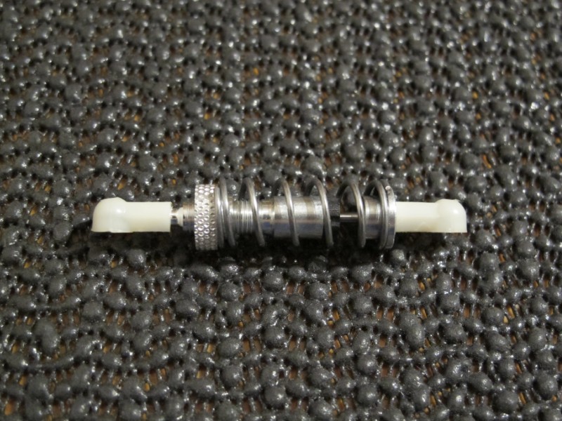

Was now working at the center shock.
I had no new shock parts, but a used shock which came with a parts lot.
Picture showing dirty condition.
- Posts: 1282
- Location: EU
- Been thanked: 100 times

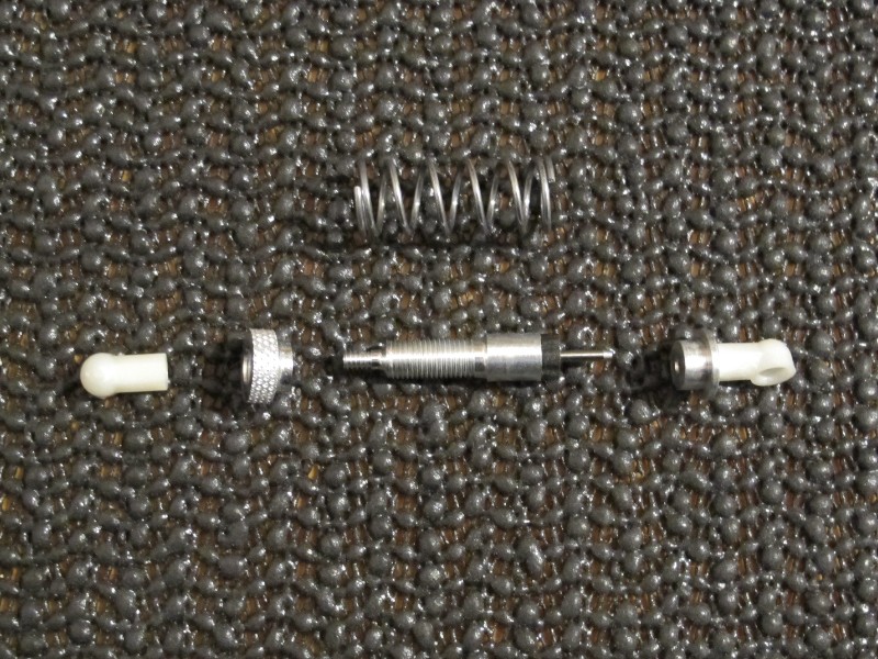

Shock disassembled and pre-cleaned with brake cleaner.
Afterwards a session at my favourite cleaning machine, yes ultrasonic again.
