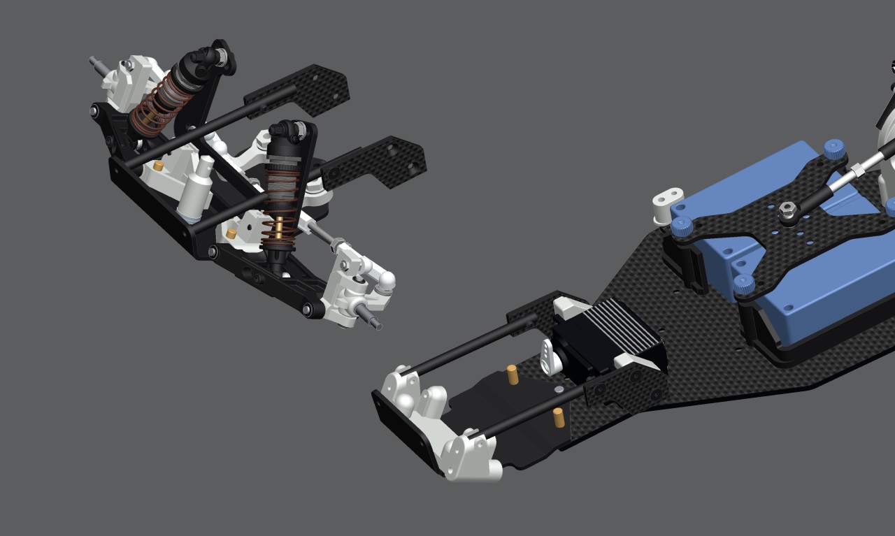

Re: NIX10M
Hey fellas you think ASC89077 work in the place of ASC25568? I ask because I can't find the one you listed at Amain and these other ones are for the chassis bracing on the 1/8's anyway so maybe you know? Thanks
- Niki
- Posts: 524
- Location: Finland
- Has thanked: 3 times
- Been thanked: 45 times
Re: NIX10M
Too big and not for M4 turnbuckle I think.
Turnbuckle is M4x50mm and total lenght of center support from ball center to ball center is around 71mm.
-Niki-
-Niki-

Re: NIX10M
Thanks niki I am sure they are 4mm the chassis brace turnbuckle but I trust you an will see what i can find.. Thanks again

Re: NIX10M
I don't see why you couldn't use a 3xXXmm turnbuckle with different ends. The cut out was designed for the 4mm AE ends so you may have to fiddle to get it to fit right.

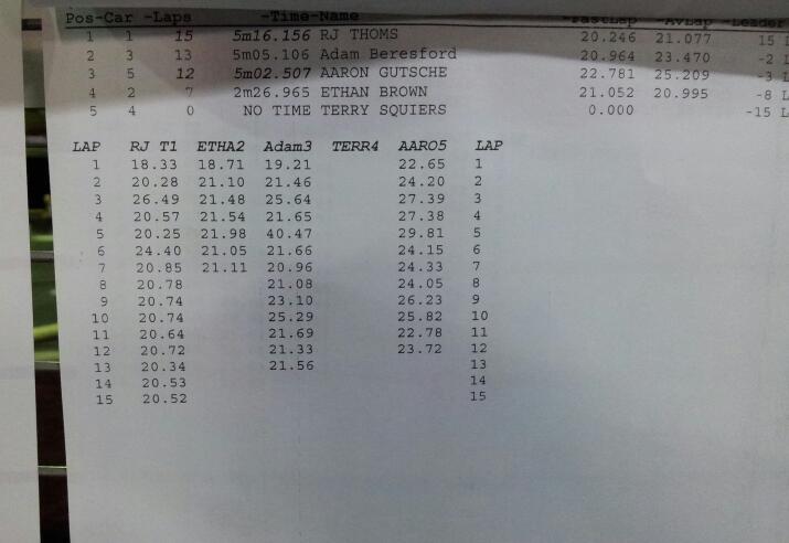

You can also fit an 84T spur gear under Niki's gear cover for modified cars, the VTS slipper is highly recommended for modified cars as you can set it looser to save the small 2.25 ball diff. I've been running a boosted 6.5T in it and so far it's holding up fine.
Tomorrow will be the first official race for this car (indoor carpet and bumpy), and I must say this thing carries crazy corner speed. The steering is direct and positive, the car rotates well and is well balanced. The car has plenty of steering but at no stage does the rear feel out of sorts. I will try a different oil combo tomorrow but it's close.
The harder you push it the faster it goes !!

Re: NIX10M
The car went well in its first race and can be competative against modern cars. The driver turnout was low due to the heat we've been having, but it was at least a good test and tune session.
Ethan's battery went flat and Terry broke his car, so it ended up being like an open practice round.
On the third lap I tipped it over cutting the chicane too close, other than that it was nearly a perfect run. I didn't have the fastest single lap of the night but the consistency was excellent.
