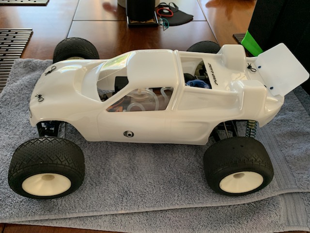

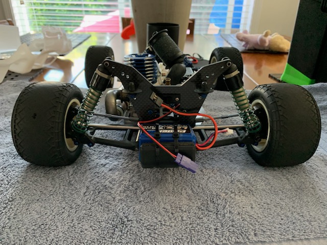

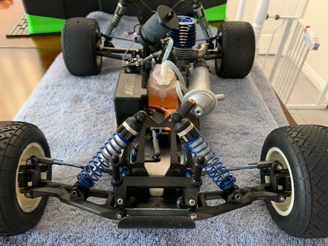

Well it's been a while, but I thought I would update this thread now that I am FINALLY done with the truck. Put everything on hold for a while and recently got the itch to finish things up. The truck is AWESOME!!! Runs perfectly and that rebuilt motor screams :twisted: Here are a couple of pics after I cleaned her up and painted the Proline Crowd Pleazer body that came new when I first bought the truck.
