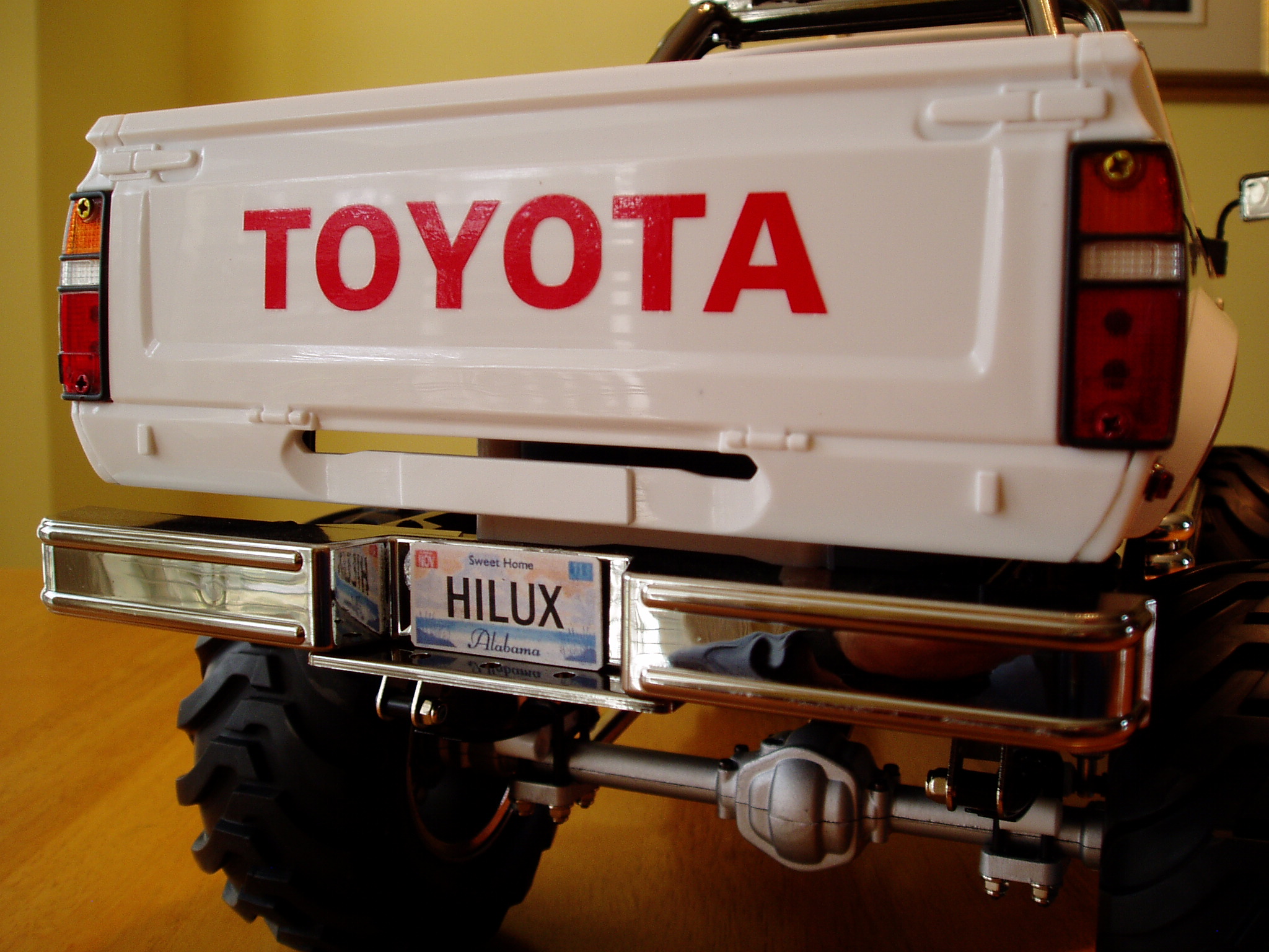

While I was making some scale license plates for the Blazer (or "tags" as they're called here in the south), I went ahead and made some for the ToyAto. I found blank tag images online (google images) and used MS Word to adjust the scale and add text, then printed them on the office color laser jet printer. The plan is to bond these to some thin sheet aluminum, trim to size and laminate them with clear packing tape to keep them dry.
RATS! I just noticed that I've misspelled ToyAto -- oh well.

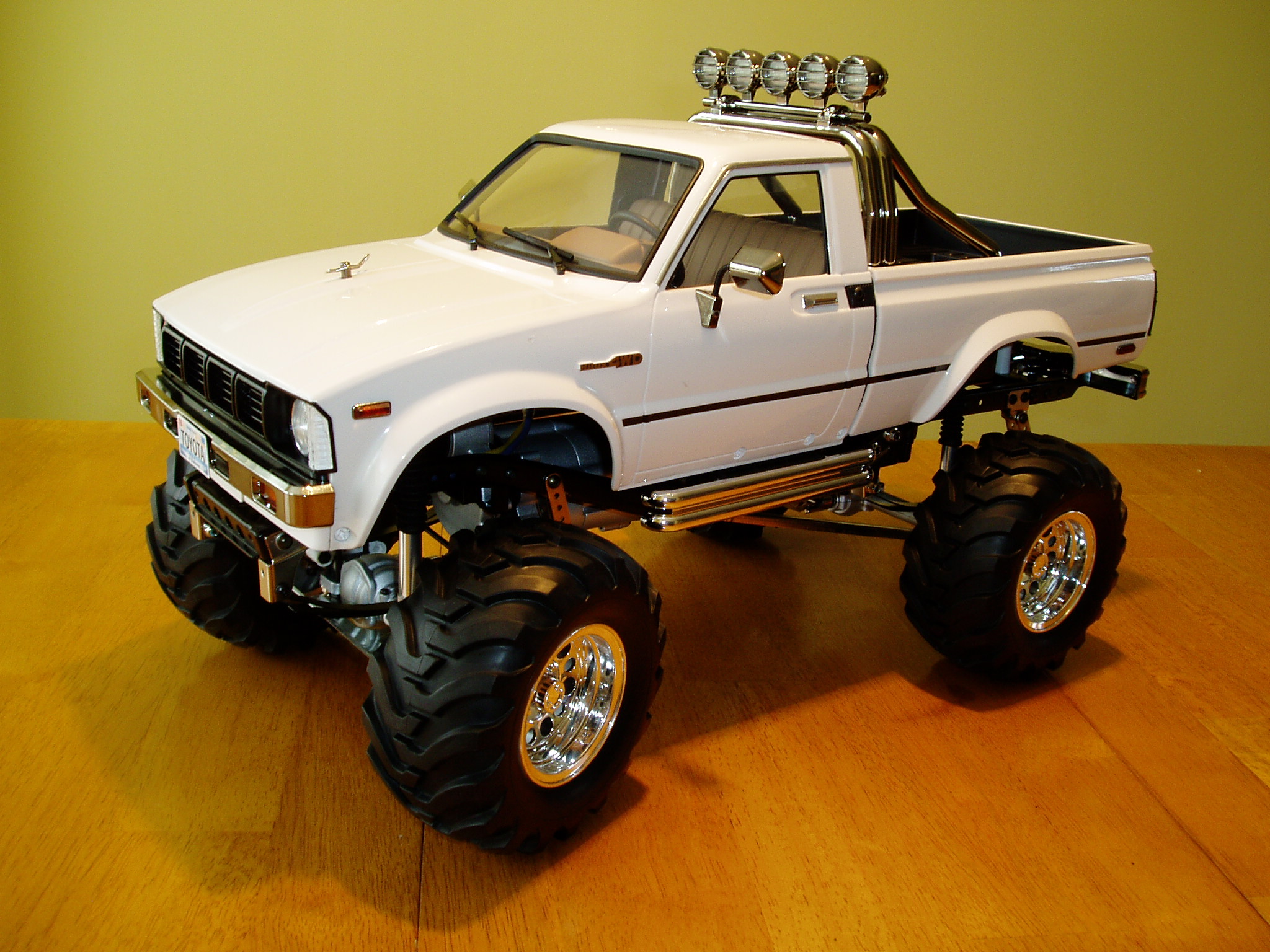

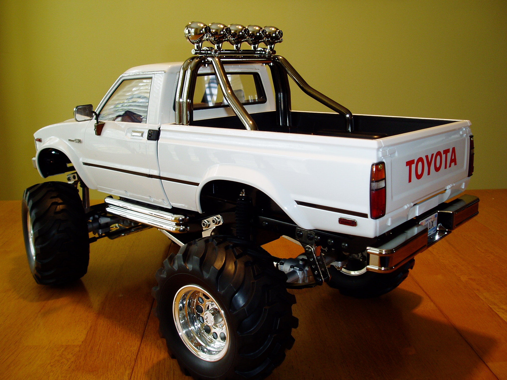

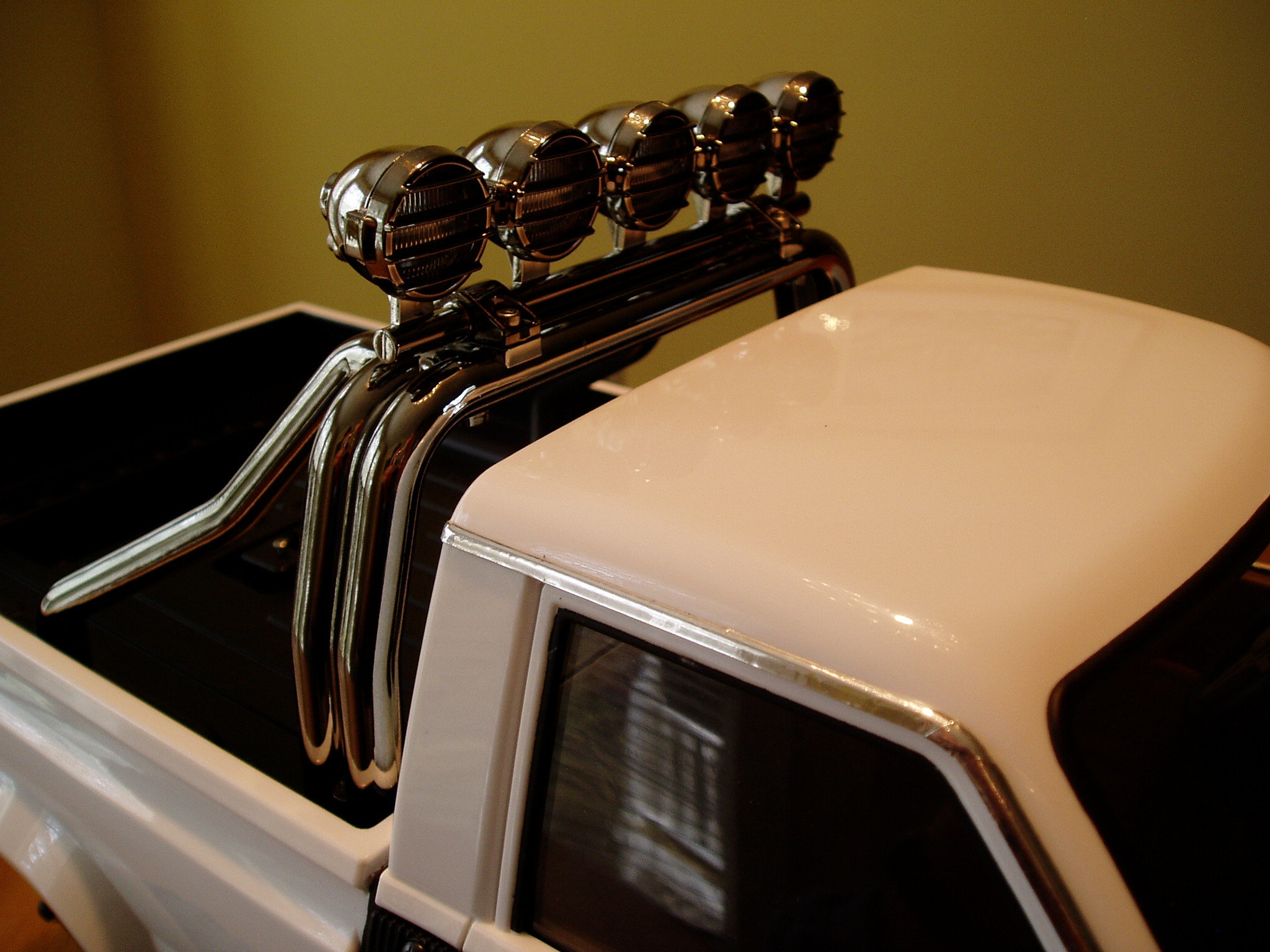

I've picked-up a second kit (a white one this time) and fitted it with Tamiya Hilux High Lift chrome bits (bumpers, mirrors, roll bar and lights). Cab back and glass and side badges are from RC4WD.
I'd planned to paint it like the boxart red Mountain Rider but changed my mind and decided to leave it white for now. After gray priming and painting the underside flat black it seems to have made the molded white really bright and solid - I could never apply paint as smooth and shiny as the bare plastic so guess I'll just leave it white.
The chassis is completely stock. This one's just going on the shelf.

XLR8 what did you use for the chrome strip around the door ways ? Looks really nice , the whole truck looks very nice .
- XLR8
- Posts: 3318
- Has thanked: 1684 times
- Been thanked: 1180 times
Re: “ToyAto Crawler” HG-P407 (the black kit)
Thank you Dadio.
I have a roll of adhesive-backed aluminum foil tape that came from Lowes - it's meant for sealing HVAC ductwork. The foil is thin and has no coating so it stretches and conforms nicely to irregular surfaces and, when polished with Mother's mag wheel polish, it shines like chrome. Also, the adhesive is wicked sticky so it stays put.
I have some if this Bare-Metal chrome foil but honestly I prefer to use the ductwork tape.
Can you give a little more info on the inner fender wells? Looks very nice.
- XLR8
- Posts: 3318
Thanks! Not much to it actually. I've just re-purposed a couple discarded margarine tubs, cut them to fit and painted them black using ordinary rattle can paint. I got the idea from other crawler builds posted on the web. The tubs are durable yet flexible and, best of all, they're F R E E (my favorite four-letter word).
