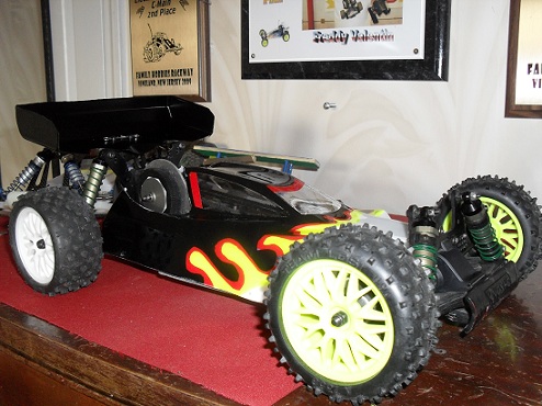

nice lazer i have a few and they are i think the best car kyosho made and i converted one of mine to pins i got the drives out of a alpha i dont know if that was standard but they work well for bashing that is

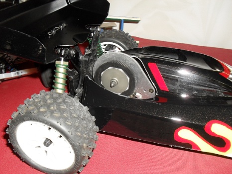

In the last pic it looks like you've got a B4 slipper assembly and spur gear fitted, care to share how you worked that out? Looks great.

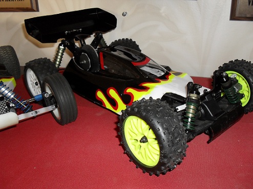

got to love those bbs style wheels looking good.
How does the jc body fit arent it kind of narrow ????

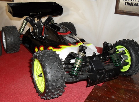

OK, I removed the stock slipper assembly, left the bottom washer/ring, made the hole on the associated spur big enough to fit the center bearing, slipped the spur and pads onto the shaft on top of the bottom (or First) washer, then slipped an associated slipper plate on top of everything, and tightened it all down with the stock nut.
There might be more creative ways of doing this mod, so all you Kyosho Mad Scientist, please, please, improve on my Idea...
I'm only running a 17.5 motor on my ZX.
I also replaced the Kyosho shocks with RC10 Team Shocks, used Associated Tie Rods with RPM ball cups, and I'm in search of a bearing steering system.
The B44 lexan undertray fits almost perfect, the sides of the chassis need to be trimmed a bit to have a perfect fitment, and the body will take some creative cutting to make it fit....

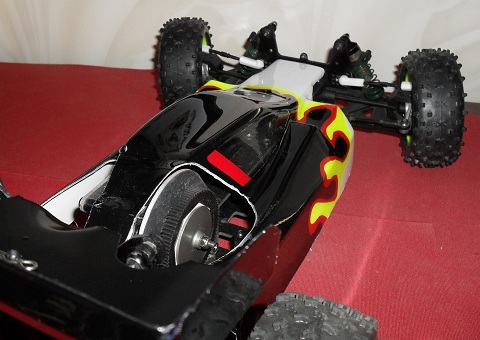

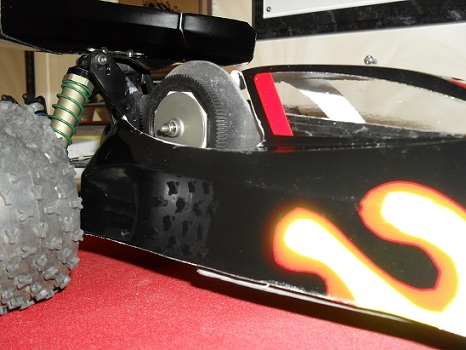

Here are a couple of better pictures of the slipper assembly.

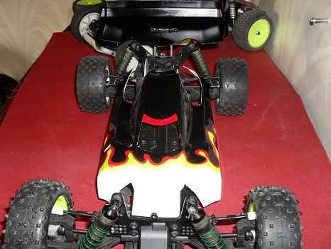

So I felt a bit creative today, and decided to paint the JC body...
Why did I cut out both sides of the body?? I don't know, it just looks kinda cool.
still need to get an under tray.
