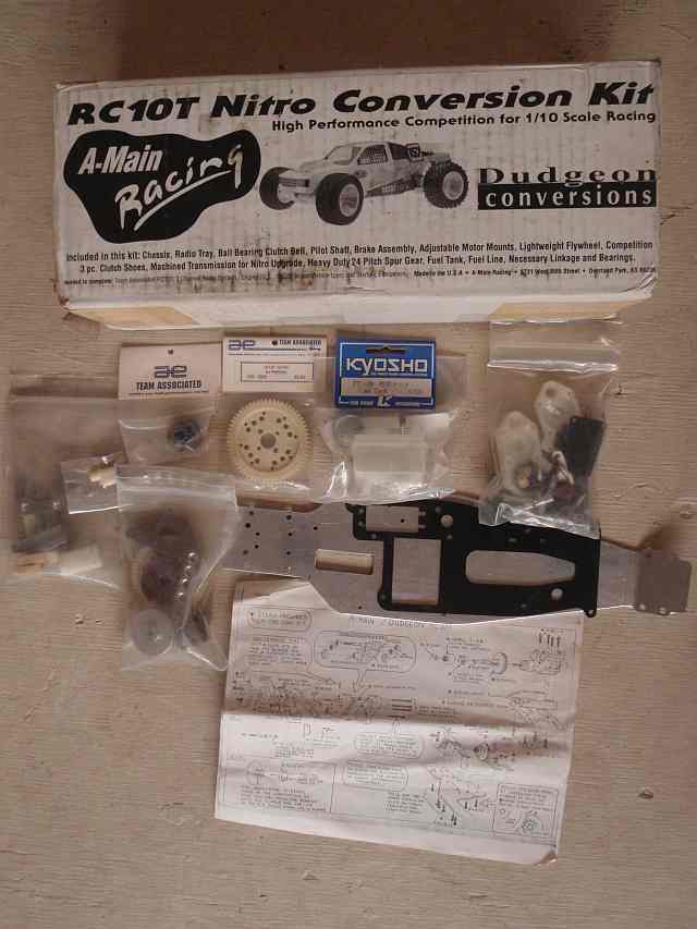

I have to many projects to complete if someone wants this conversion kit let me know. I also have an rc10t that i was going to convert if anyone is interested.
Re: ID Help RC10T Nitro Conversion
is this kit nib? if not, what is it's condition? also do you have any pix?

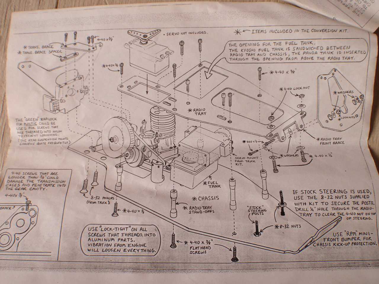

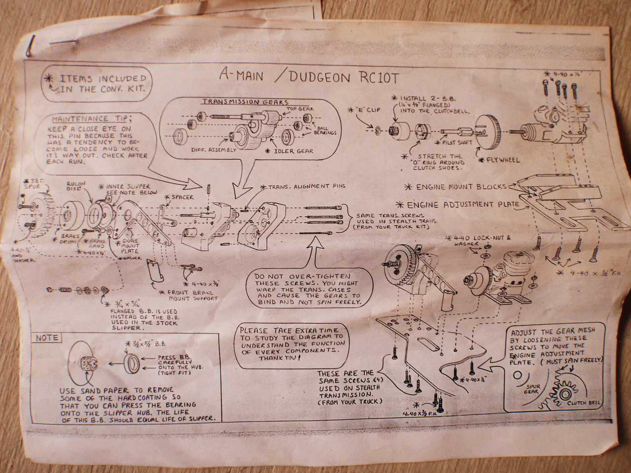

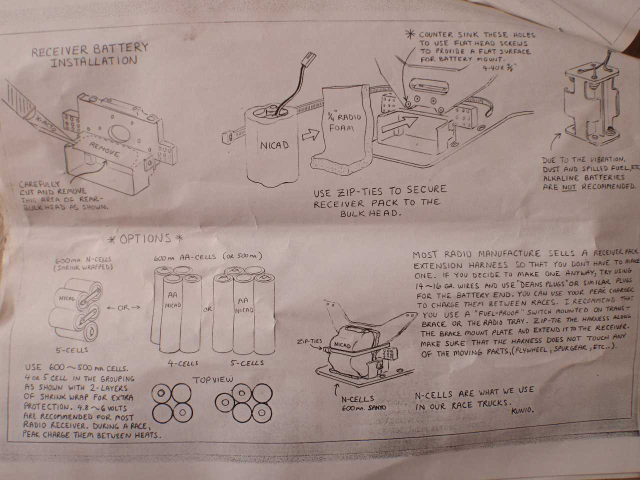

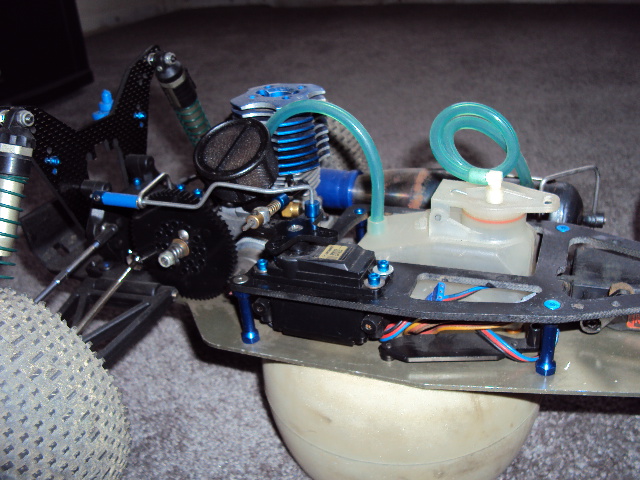

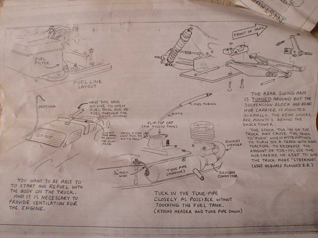

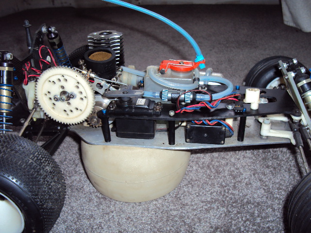

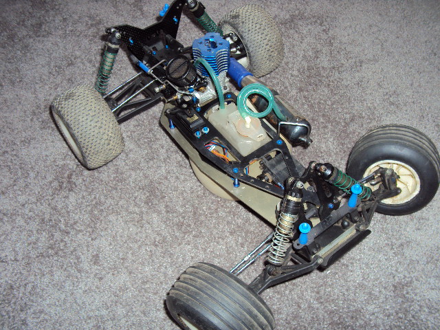

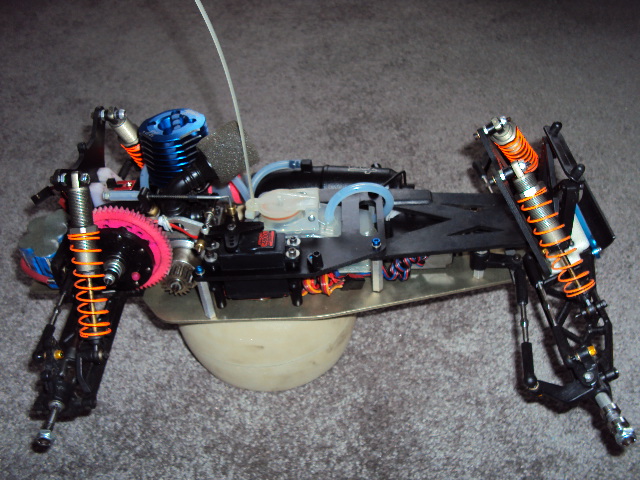

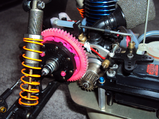

here are a few pix of the complete chassis. enjoy!!!!
- Attachments

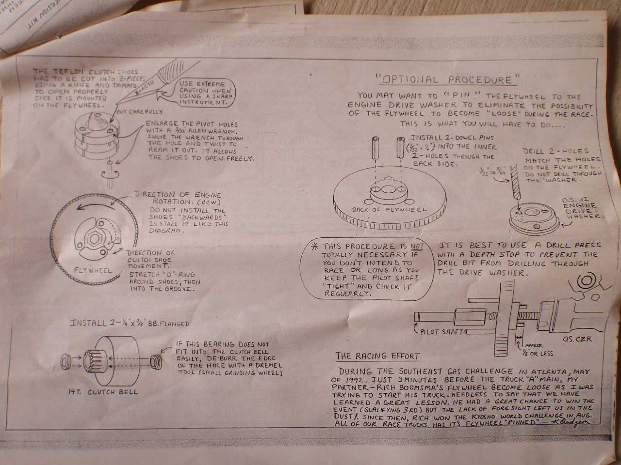

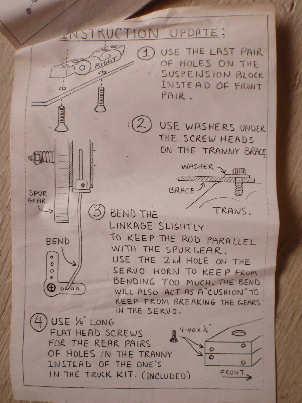

I dont have a scanner so i hope these pics of the instructions are good enough.

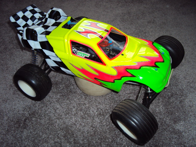

As I had mentioned, I have quite a history with this truck - dating back to it's original design and release.
So, I dug around a bit and found a few more pictures of the Associated original release. The truck shown here is the # 1 truck - it's the first one built from the final designs and the B/W pictures are actually Polaroids which Rich & Kunio had taken by a professional photographer. Enjoy!
The truck with the black wheels and with the body on I believe IS my original truck - I died all of the white plastic black so that the truck would clean up better..... little did I know!

I wish I could find that Kyosho CB-161 flip top tank cap for my NIB conversion. Nice pics! I do have the RC10T Losi wheels as shown on the box art...
I'll keep my eyes peeled for the tank; stuff like that is hella hard to find as you know.templeofspeed wrote:I wish I could find that Kyosho CB-161 flip top tank cap for my NIB conversion. Nice pics! I do have the RC10T Losi wheels as shown on the box art...

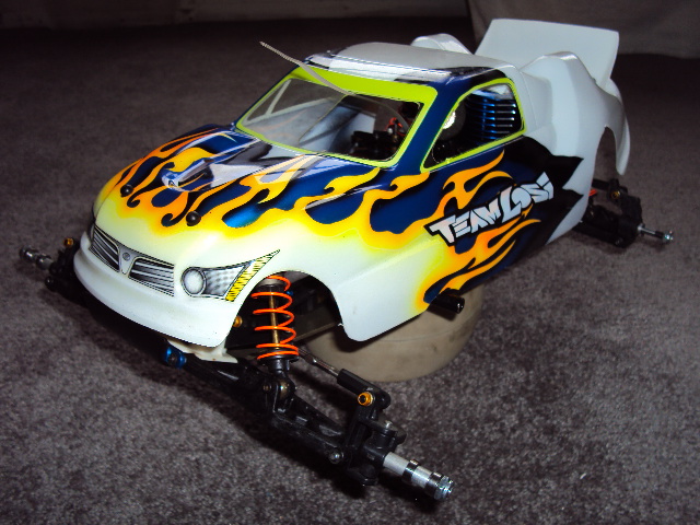

Do you (or anyone) know off hand what body that is??? It's (stating obvious) Parma but I don't have a clue as to which one; same deal wtih the wheels.
As a side note, at the time this truck was brought out, there were no bodies available with shock 'bumps' in the rear; so they had to be cut. At one point, someone came up with the happy idea that shock towers needed to be covered so the guys running them had to make some 'bumps' while at a race before they would be allowed to run. As has always been the case; whenever something new and cutting edge was brought out there was someone standing around with a slower vehicle trying to legislate backward.
