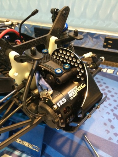

Added a couple JConcepts goodies to the truck.
JConcepts motor plate and trans brace
Javier -
