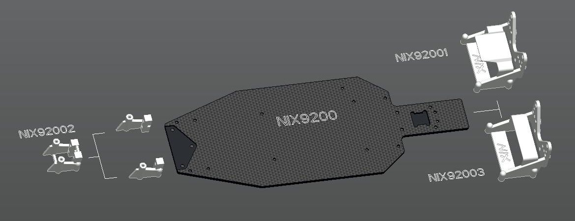

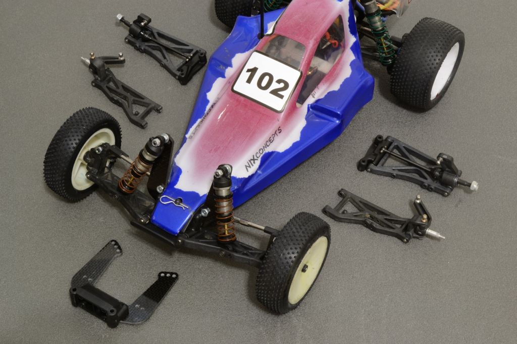

Awesome Build! Thank you for sharing. I have a B2 in Parts so i think i have to try this. Have you driven all three chassis length by now and if yes, which One Works best on carpet?
- Niki
- Posts: 524
- Location: Finland
- Has thanked: 3 times
- Been thanked: 45 times
Re: RC10B2 Graphite
I have driven only with the original B2 wheelbase chassis (NIX9200) on a tile floor indoor track.
Grip is very similar to outdoor so I'm currently driving with outdoor-setup. Can't say anything about the carpet.

Re: RC10B2(3) Graphite
Fantastic race result Niki, the B3 will be even better on carpet! That is what you run on right? Anyway, what made you choose not to cut the square notch in the chassis to lower the transmission and overall cg?
I'm not sure if I understod right... but... the transmission IS located in a groove on chassis topside.slotcarrod wrote:.........Anyway, what made you choose not to cut the square notch in the chassis to lower the transmission and overall cg?
Ok I understand, sorry I missed that!Niki wrote:I'm not sure if I understod right... but... the transmission IS located in a groove on chassis topside.slotcarrod wrote:.........Anyway, what made you choose not to cut the square notch in the chassis to lower the transmission and overall cg?![]()

Re: RC10B2(B3) Graphite
Original RC10 Graphite chassis was 1/8" thick I think? My chassis is 3mm - so little bit thinner. B2 transmission needs ~1.8mm cut to settle properly.
I wanted to keep chassis rear end as strong as possible so through cuts were avoided. Underside is nice and smooth in this design.
