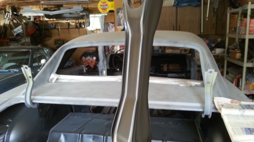

Lots and lots of metal work on a 62 chevy. I'll try to take some pics. But, its got all new floors and braces in the passenger compartment. New inner rockers, new right outer rocker, new trunk floor, new tail pan, new rear body mount boxes, new left quarter panel, and small rust repair patches here and there. Some of it is done, still working on some of it.JK Racing wrote:Back to Scr8p...what 'cha workin on now?
The right quarter panel was replaced many many years ago ( probably back when it was new) and wasnt installed all that great. So we had to cut it off to put it back on properly. Working on that right now actually.

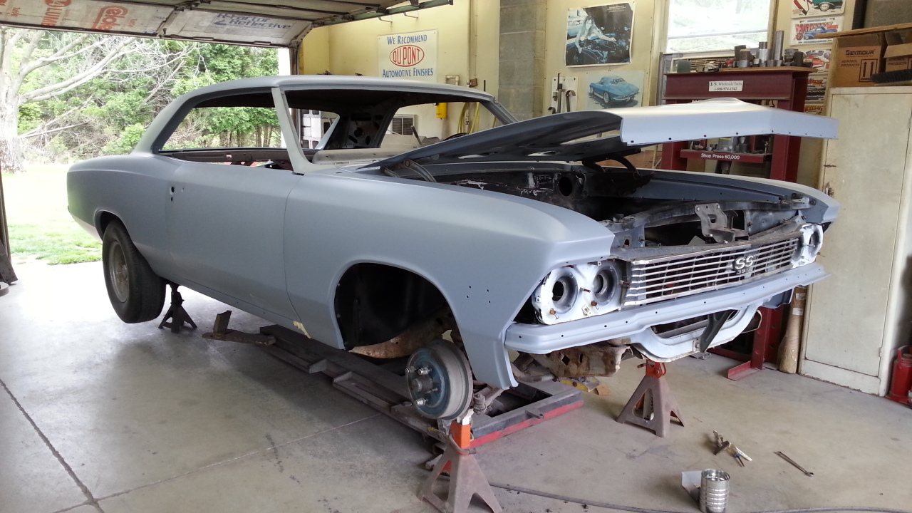

Still doing metal work on the 62, but the chevelle is moving along. All of the bolt on sheetmetal is done, primed and ready for paint. I got the body shell primed the other day. Now we've bolted it back together one more time to check everything before lifting the body off the frame.

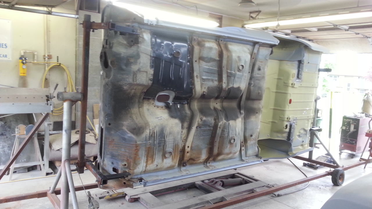

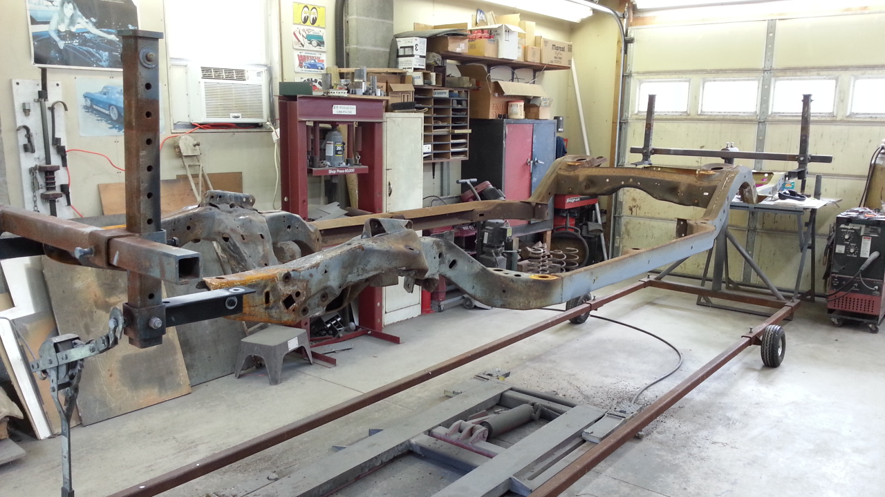

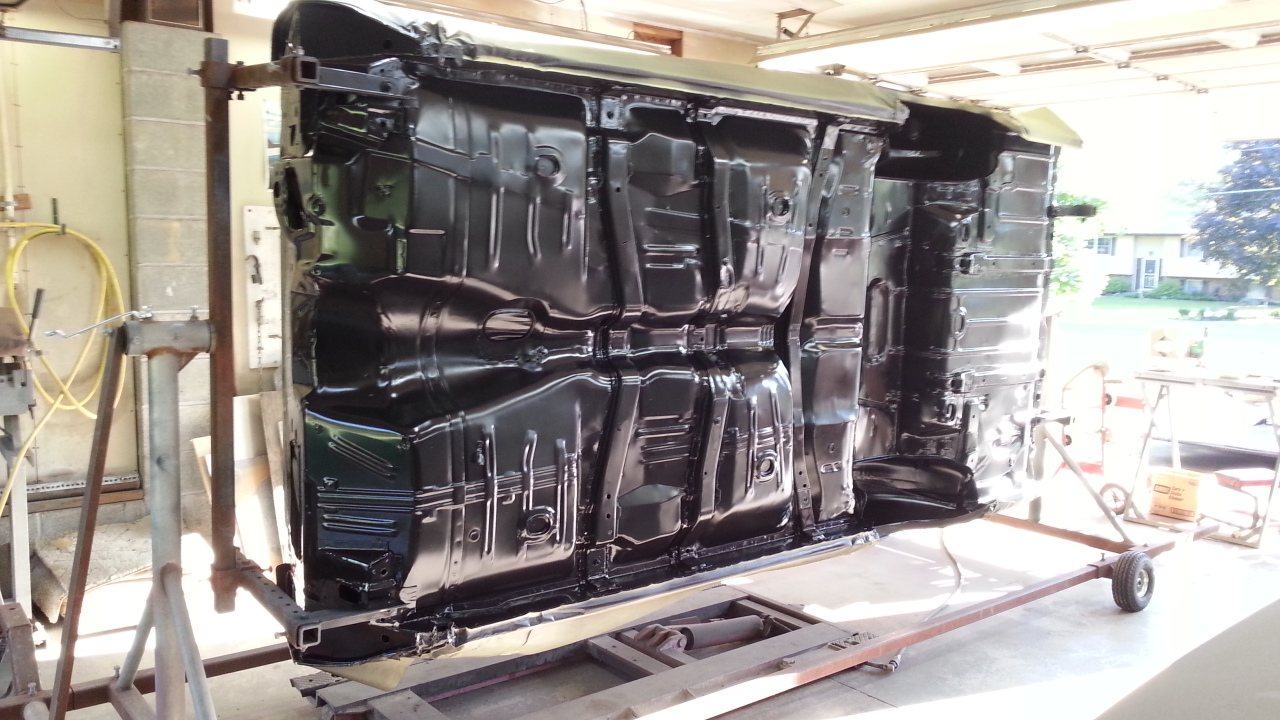

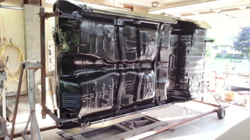

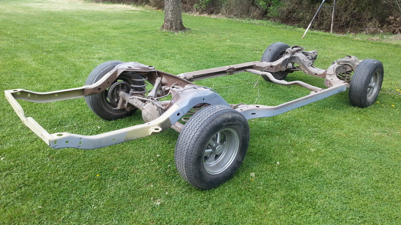

Little update...

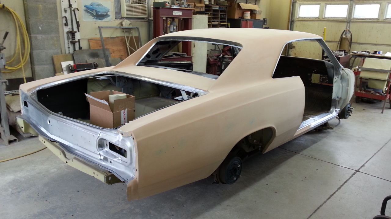

After pulling the body from the frame, we has to fix some rust issues at a couple body mounts and the inner rockers by the cowl. After that, got it sandblasted, cowl and dash primed, and the bottom and firewall painted.

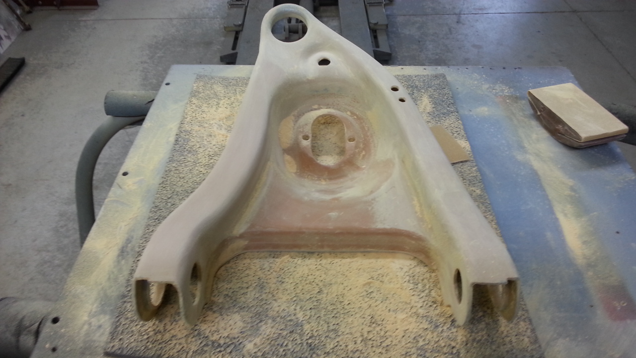

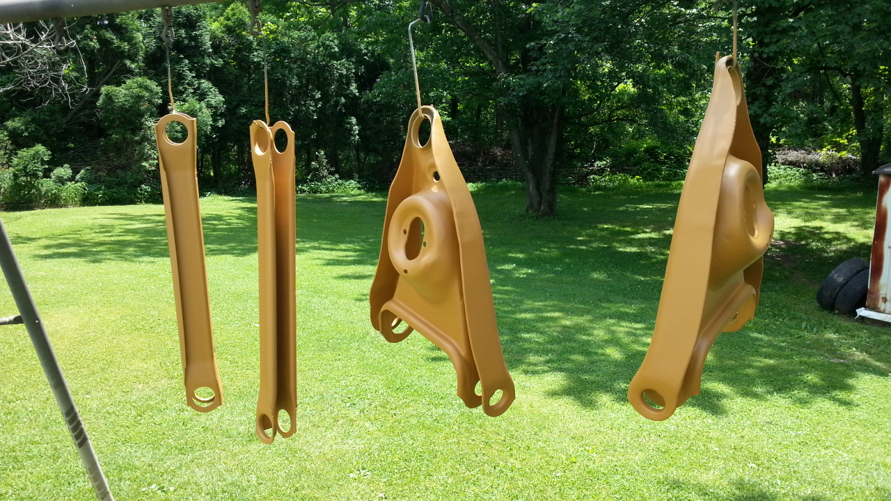

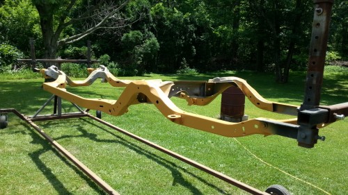

Once that was done, we put the body on the rolling chassis from the parts car we got and put the frame on the jig to get that blasted and painted. Unfortunately, the frame, along with most of the suspension parts are very rusty. Heavy pitting has to be fixed so polyester primer is sprayed on the bad areas. It'll then be sanded out and painted.
The fingerprint removal process.
And what becomes the final product. Nice and smooth with no pits.

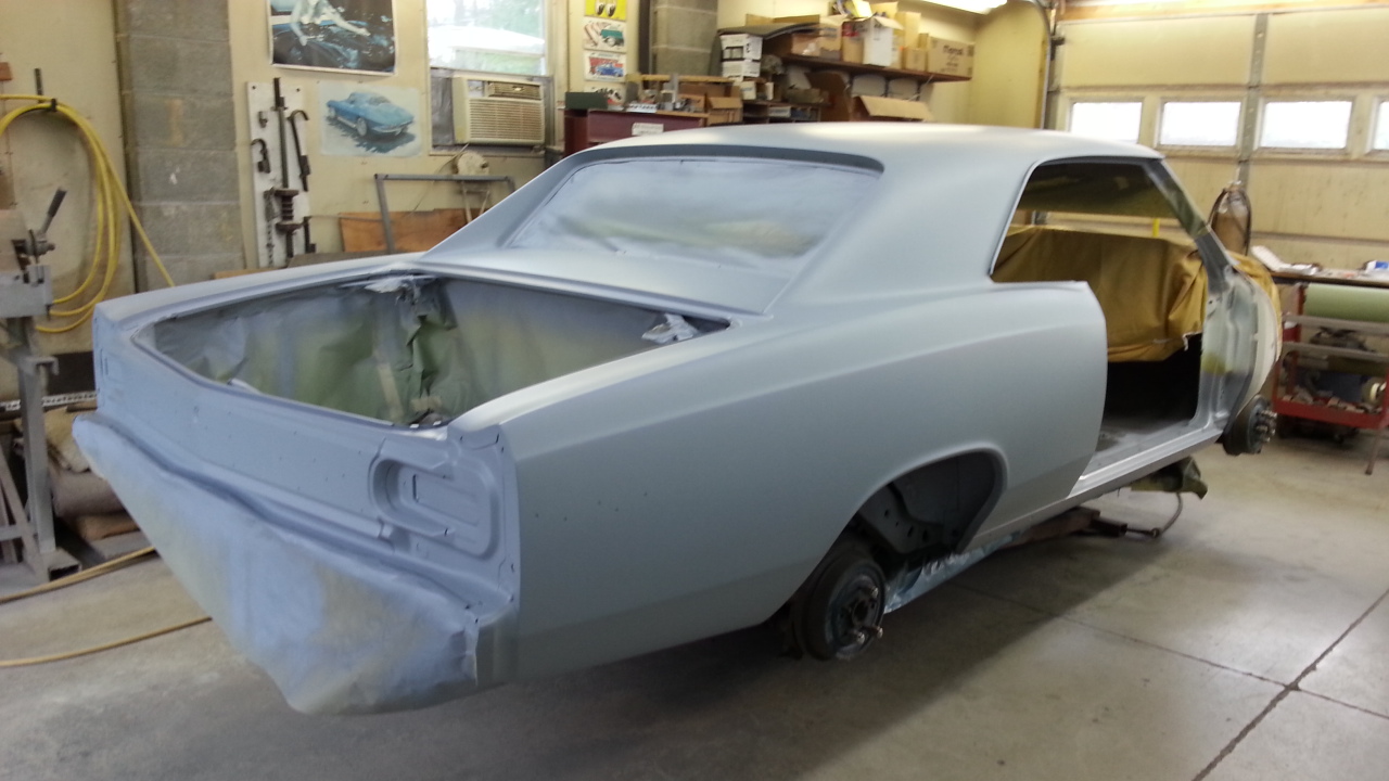

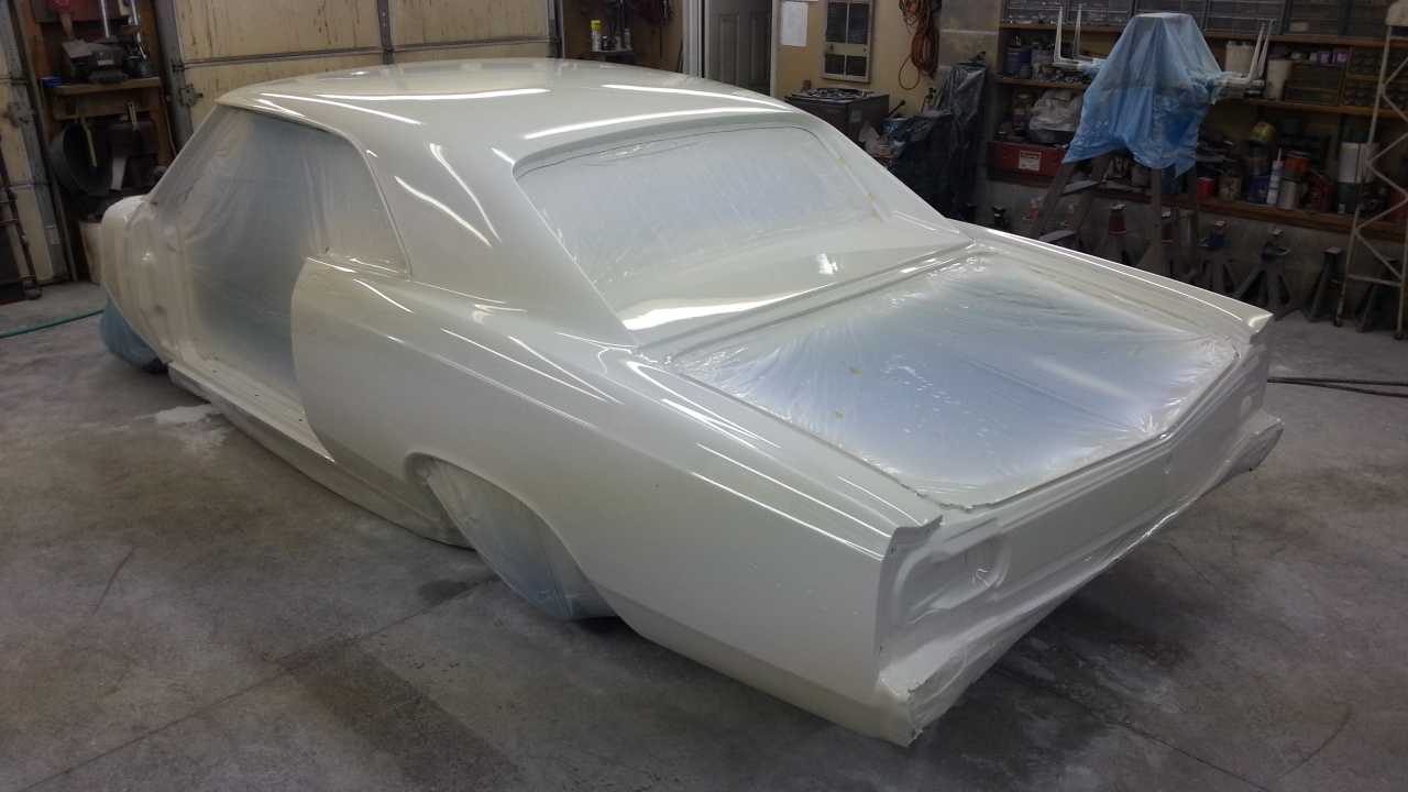

Little update.

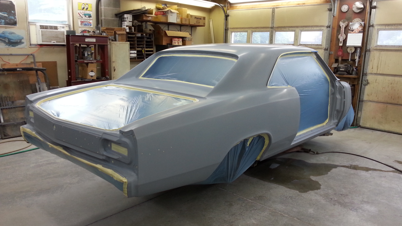

I haven't been taking as many pics along the way as I used to. But we've been moving along pretty good on the 62 bubbletop as well as the chevelle. The chevelle is finally seeing some paint. I still have the front end sheet metal to do. Hopefully it'll all be done in the next week or two. The chassis for it is all finished too, so we should be getting the body back on it in the next couple of days ( sitting on the chassis from a parts car right now).

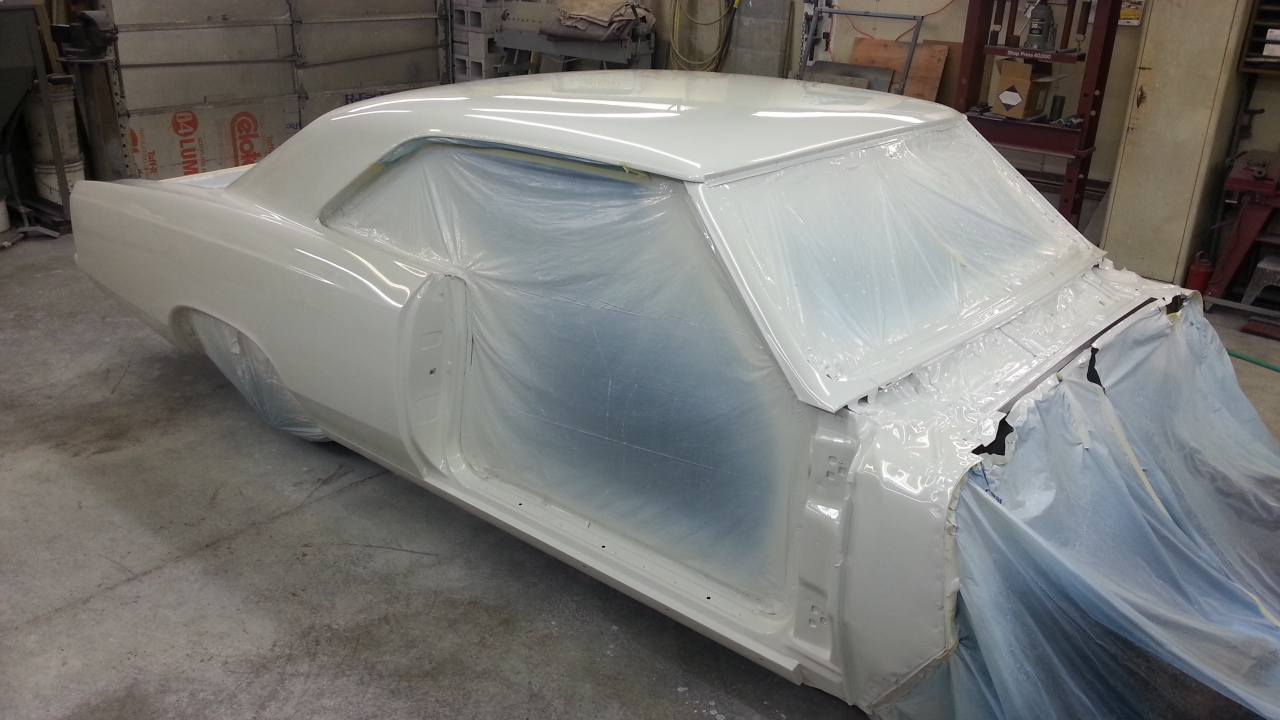

I've been kinda lazy with updating what's going on in the shop. The 66 chevelle is getting close to completion. The 62 bubble top is basically ready for paint, but I'm going to push that off until spring since it sucks trying to paint in the garage in winter. Doing some repair work on a 70 Superbird rear body panel right now. And, our next body off resto was dropped off on Wednesday, a 72 442 convertible.
