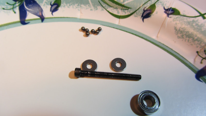

I knew this was inevitable, so I just went ahead and did it last night. I think my diff was slipping on some of those test runs, and when adjusting diff how you are supposed to, it felt gritty, I had to loosen it up more than you're supposed to before it felt got smooth.. It hasn't been apart in several years, maybe 10 or more..
Looks pretty good considering..
Bearing still in excellent shape. This is the second or third rebuild with them.
Kinda dirty but not too bad.
Where's all the diff lube go? I swear when I put it together there was plenty in there!
At least the black grease hung around.
before cleaning-
All cleaned up..
They look fine.. I think I'll just clean and re-lube. I thgink this will be the second time for these rings/ diff balls.
These also look fine.
I'll have enough diff lube this time..
Rings still look good too...
And back together it went, no problem..
I got a new slipper pad too.. the one that guy on ebay makes and sells for $9..
Almost forgot this little guy..
So after tightening diff all the way down, and then backing off a little less than 1/4 turn, it is much smoother than before, so I guess mission accomplished.
