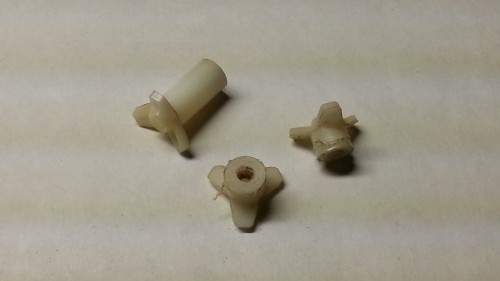

Got these in a lot but don't know how they're supposed to be used. Any good to you?

Those were the optional metal nuts.
I thought I threw them out but I guess I didn't. Missing a rear though.

Are they just longer because they need to cover more axle thread?
The metal ones look like regular 8-32 hex standoffs.

Steel 8-32 nuts work fine up front...I could sure use those steel ones for the rear Phin...Sr8p I will take those also just in case I come across a single rear one...Pm me with what you all want for the goods...

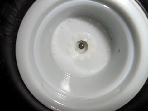

Phin...I will take a picture and post it so you can see why...

the proline rc10 truck rims were kinda offset to allow the rear to become as wide as the front. because of that, the axle threads do not stick out of the rim, it's down in a "tunnel" so to speak. so you need a tall nut to reach the axle and still be able to tighten it.

Exactly what scr8p just said....The front one has a nut on it and it fits fine...The rear one you can barely see the axle and you need a long shank like you have or the correct knock offs...Thanks for the link sr8p...
