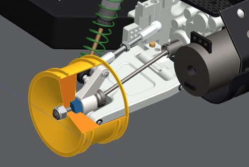

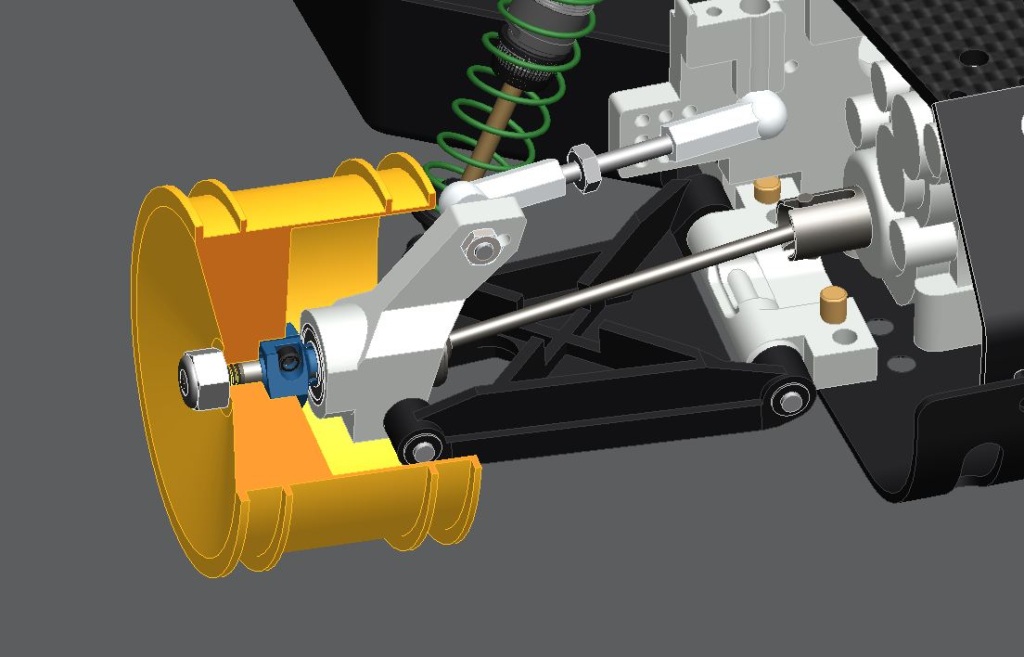

New rear hub NIX63652 for hex wheel conversion. (Hub updated to stronger version 2015-04-27)
B44 CVA bone #9754, SC10 hex adapter (JC2081 or similar).
Can be used on RC10 also.

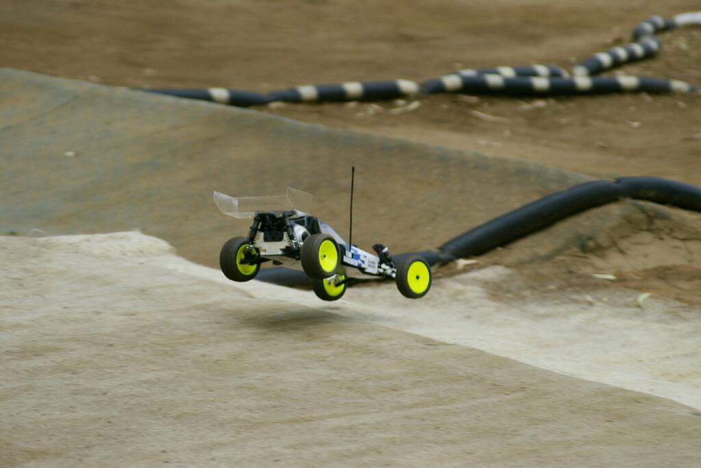

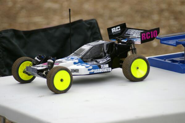

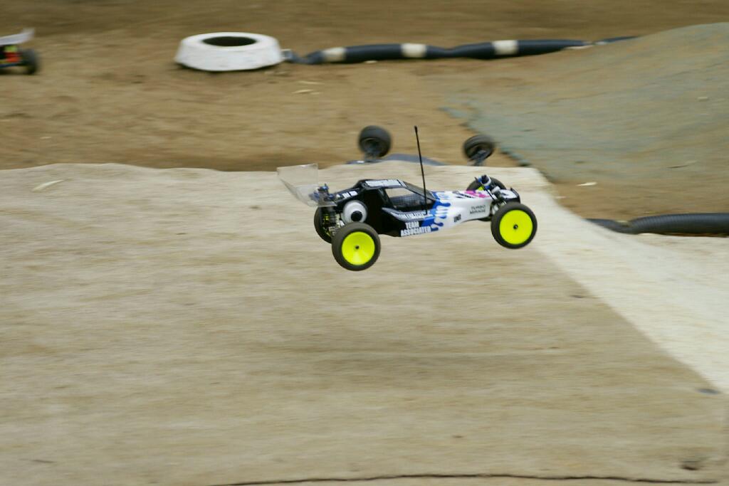

A few pictures from Saturdays race.
The car was absolutely amazing on dirt and had the same pace as the fastest modern cars. The track was low to medium grip and the car far exceeded my expectations.
I think most enjoyed watching a semi-vintage car mix it with the fastest guys. The car also received many compliments.
Thanks again Niki.
Hopefully soon we can offer a chassis kit, sorry for the delay but it's still in the works.

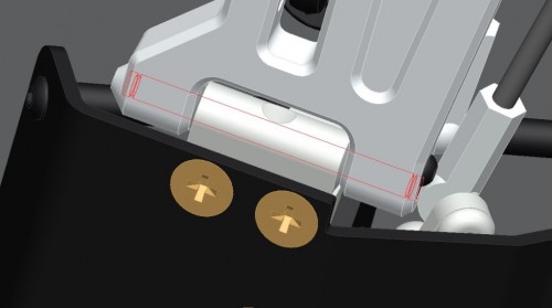

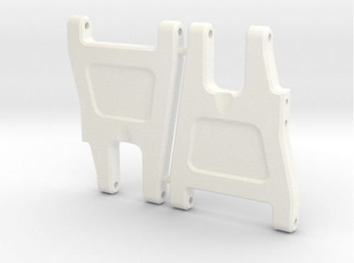

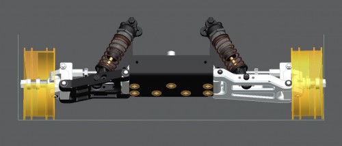

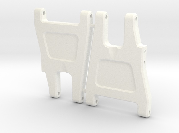

Wide front arm for RC10/NIX10M buggy nose. Leading thought: Racing.
Designed to be used with #6220 wheel axle and B4 front wheel. Uses standard inner hinge pin #6226 but mounted without C-clips. Screw #9645 holds hinge pin in place. One extra shock mounting point.

Such a good design for the arms Niki! It seems like the front arms always eject the e-clips once they are worn down a bit; these should solve that dilemma.

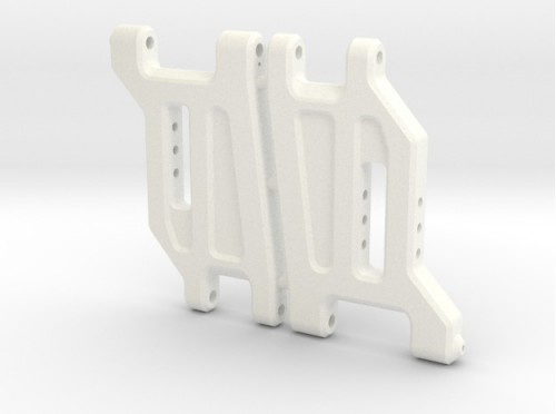

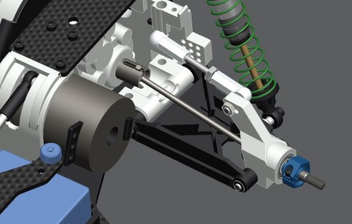

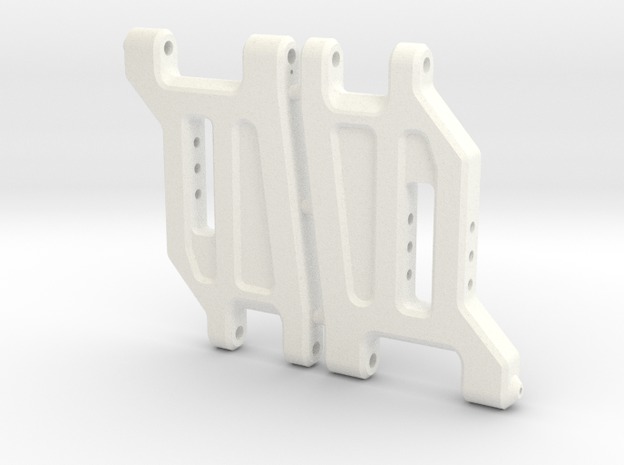

This is new wide rear arm for RC10 and NIX10M.
Designed to be used with B4 CVA bone #9672, B4.2 hex adapter #9890 and B4/B5 hex wheels. Non-hex B4 wheels obviously can be used also with wheel spacer mounted under axle pin. Sample parts feel really strong and solid.

Besides the obvious, why the longer arms on the 10M build? I read about ejecting e-clips... just wondering what was wrong with the original arms?
