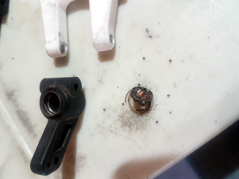

Re: VAE's NIX10M

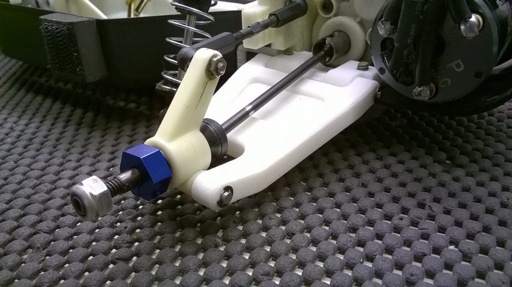

Diff bolt hex for this car should be on the right side. As a rule of thumb, when a ball diff rotates forward it puts tension on the bolt and spring, the bolt should never be able to loosen. Remember the saying "lefty loosey righty tighty". Although, if you have reverse and use it aggressively, you can still loosen the diff!
Not likely though!

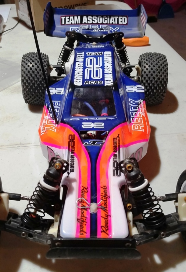

That JC body looks awesome on the mid setup. They really hit the worlds body out of the park!

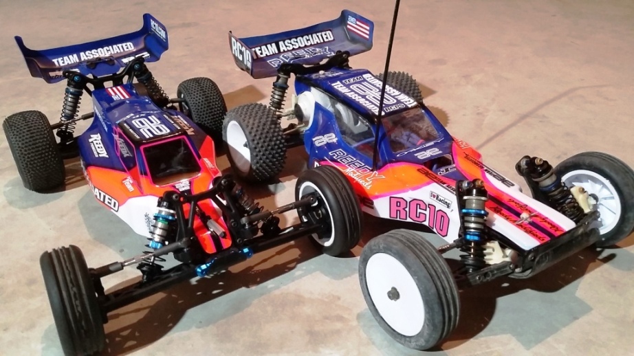

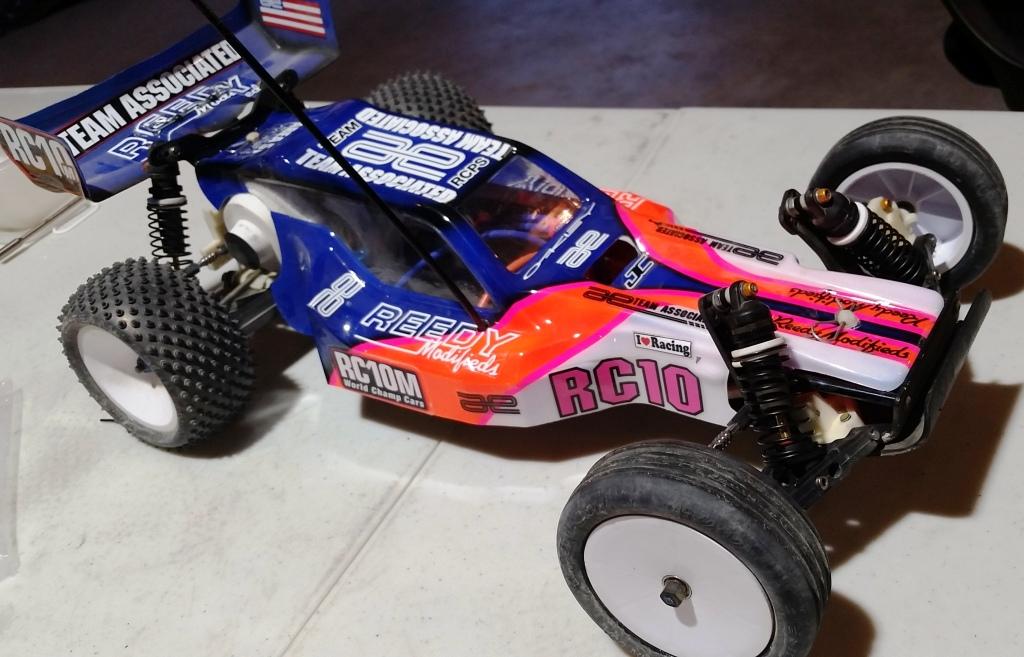

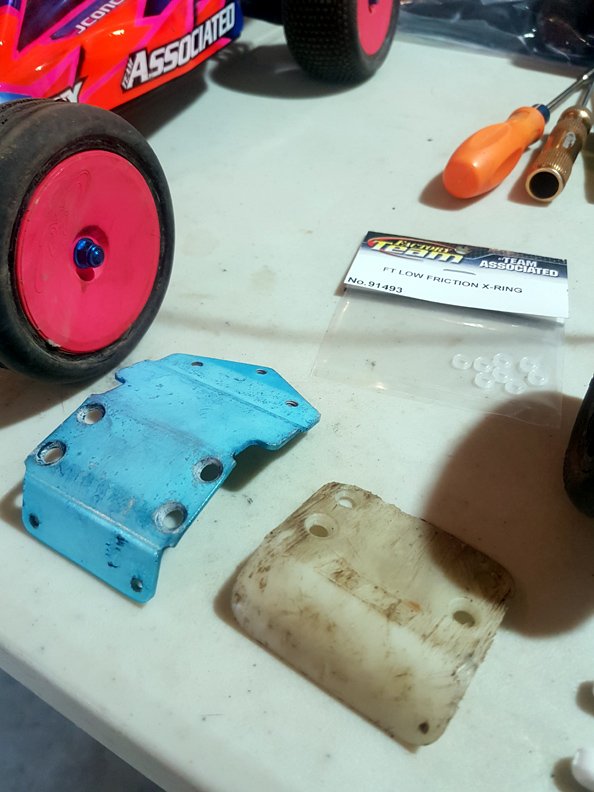

Re: VAE's NIX10M Stage II

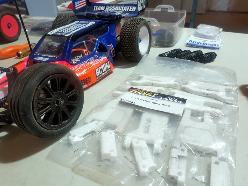

Well, it was a blast competing with the B5Ms and B6Ds with the buggy nose and standard arms. I made consistent top B-Mains and the odd A-Main with it. Now that I have some arms and arm mounts from Niki, it's time to take this car to it's next level.
It needs a shock rebuild too, so this is a good time to rip the arms off and make some changes.
Here's what I got.
Here's what I don't got
A open 10t shock tower that will allow me to us my JC body and a front 10t bulkhead. I suppose I have to use a longer big bore shock on the front too...possibly a set of rear B5 or B6 shocks.
Here's what I got.

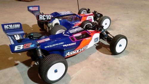

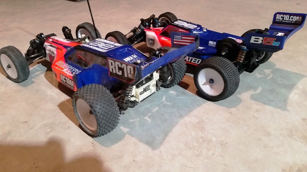

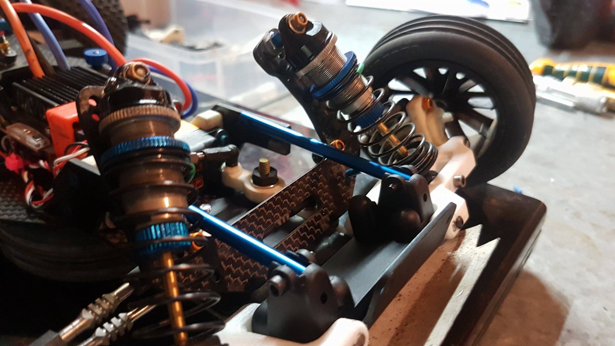

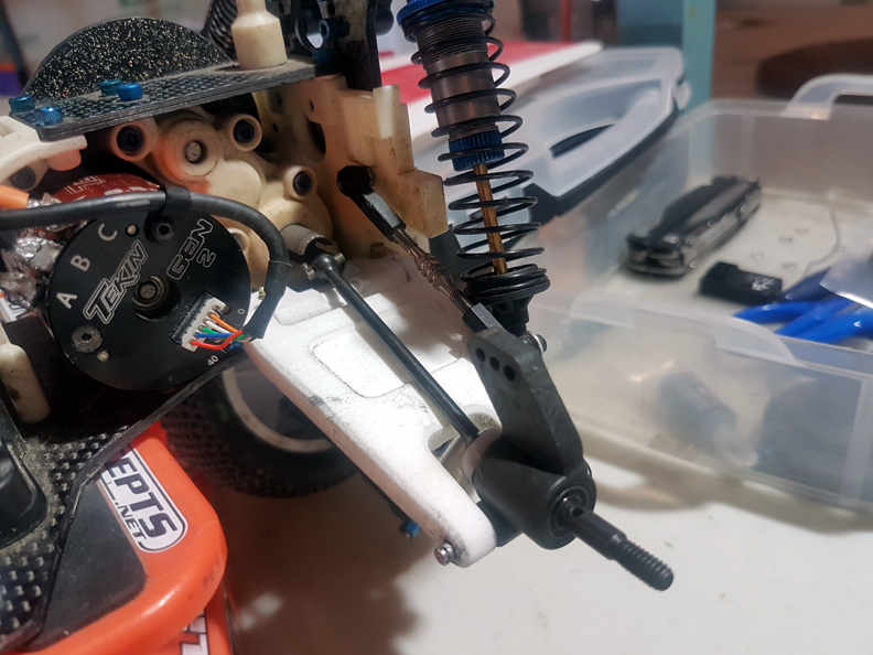

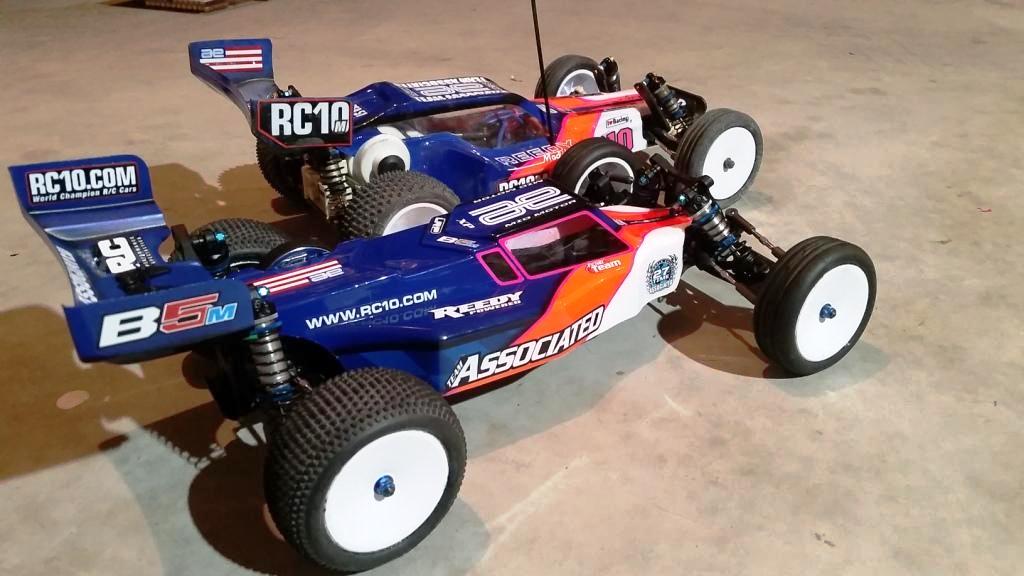

I've got most of the rear suspension done. After swapping the rear arms and mounts I started to fully understand the difference in geometry that would occur.
I'm not 100% sure if I can use the same turnbuckles. The long ball cups were nearly fulling screwed onto the turnbuckle before, now they are unscrewed quite a bit.
The RC10 CVDs
, nope, I only had 1 B4 CVD which worked well, so I'm in need of another one.

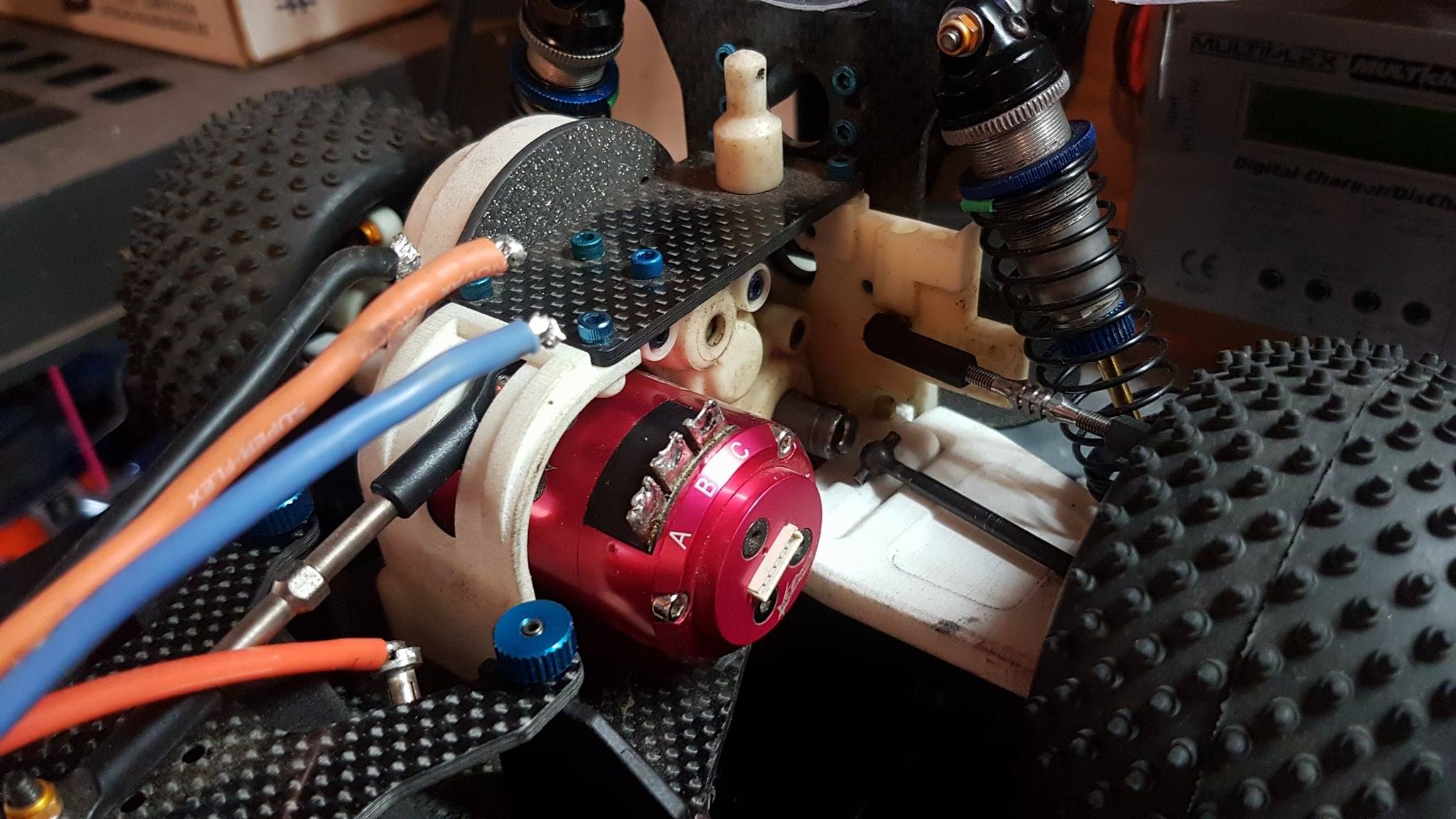

Where I wanted to mount the shocks didn't work out. The dog bone didn't line up to the out drive. I played around with different rear hubs and the B4 ones were a bit higher, but I only had one of those too. After looking at the angle of the shocks when mounted on the rear of the tower and compressing the suspension a bit, I realized that there was too much stress on the shock shafts while in motion. I decided to move the shock to the front of the tower, which helped a lot. I also moved the top and bottom shock mounts out one hole. which gave me clearance of the bulkhead ball stud holes. I suppose I can just trim those off if it comes to that.
I tried reusing some bearings, I guess this one is done

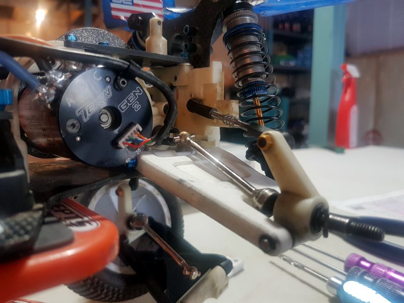

B4 hub and B4 CVD. With the shock mounted further out, it raised up the arm and I no longer had the dogbone rubbing on the arm. This photo was from the prior shock location.

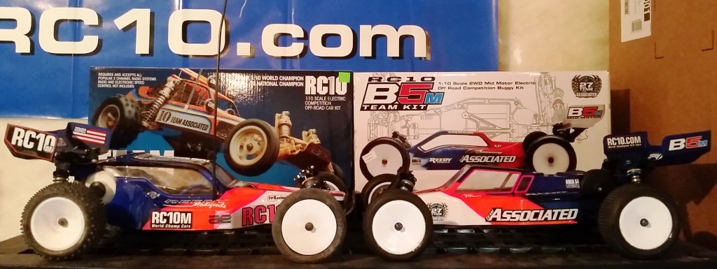

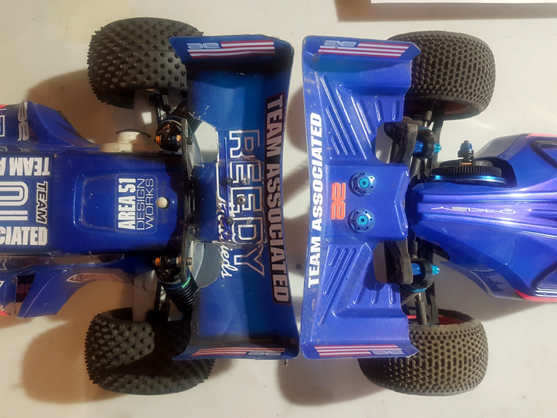

After all said and done, I kept the Worlds rere hubs and used B4 CVDs and B4 wheels. The Worlds rere wheels were offset too much and ended up being wider than the B6. Here's a comparison backed up with a B5M
The RC10 CVDs

Quadra arm design was based on rere hubs, B4 bones and B4 wheels. Just what you have in there now. "V2" version of Quadra arms will give you more dogbone clearance and much stronger design both arm and mount. Hex adapter and wheels can be used also.

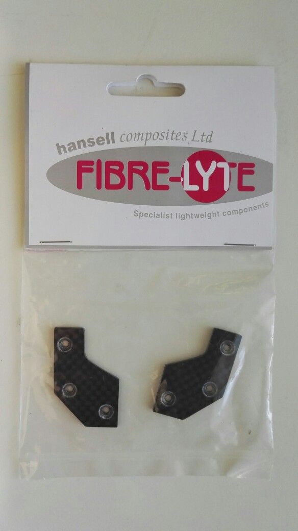

Slowly but surely it's getting done. I've found time to get a 10T bulkhead and nose tubes from Rod, thanks so much. I need to get the short nose tube braces or drill the tubes. Looks like I'll need to get a CF 10T tower too. The B4 CVD is sourced locally, but haven't got it yet. Should be any month now lol.

I have one extra set of nose tube braces laying around. Do you want it?
-Niki-

That's awesome Niki! The rest of the CF parts are Fibre-Lyte too, so it's pretty fitting. It would be nice to get a front tower that would fit both the car body and the truck bulkhead. Maybe I'll trim the tower I have so it'll fit...
