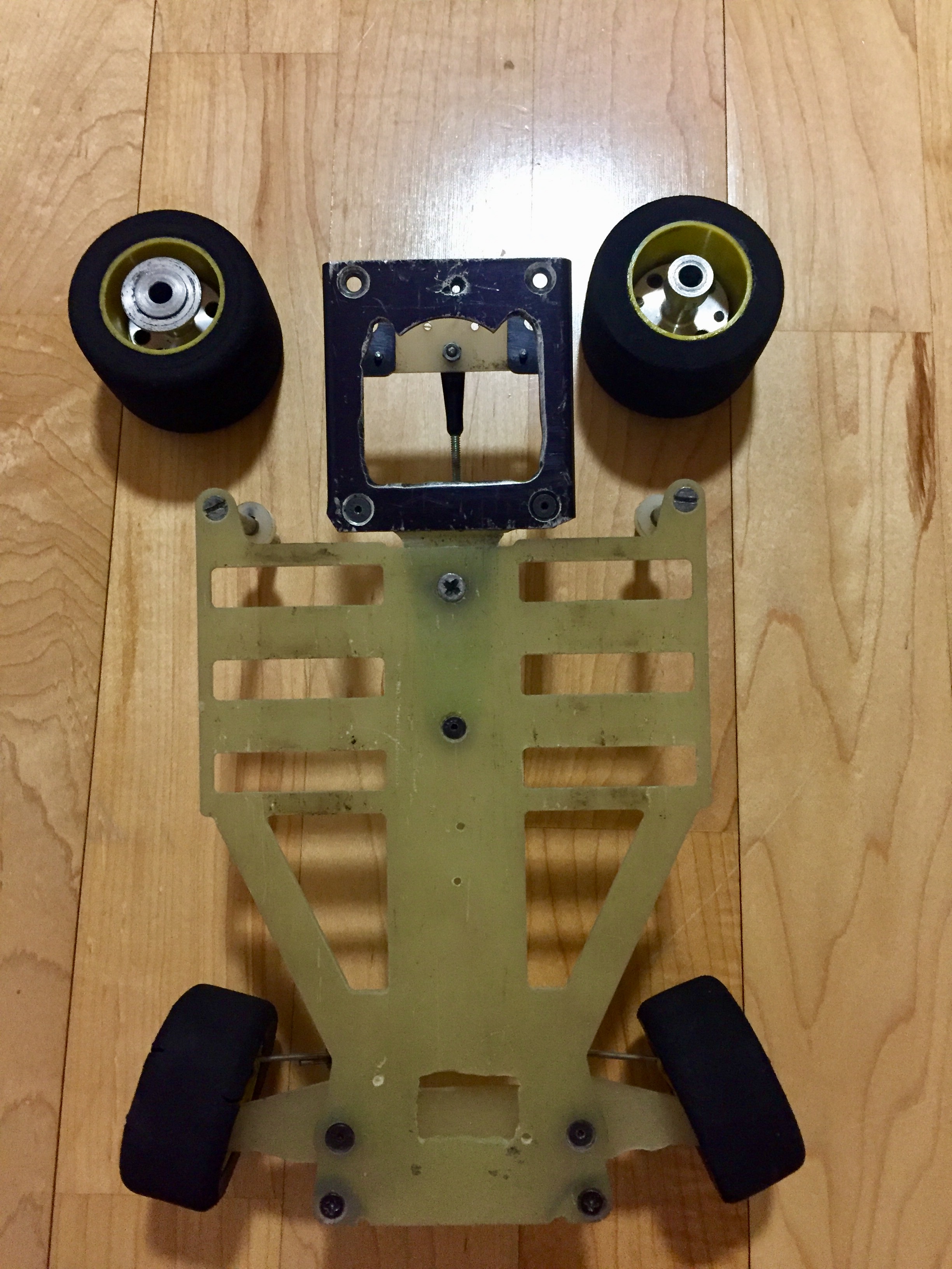

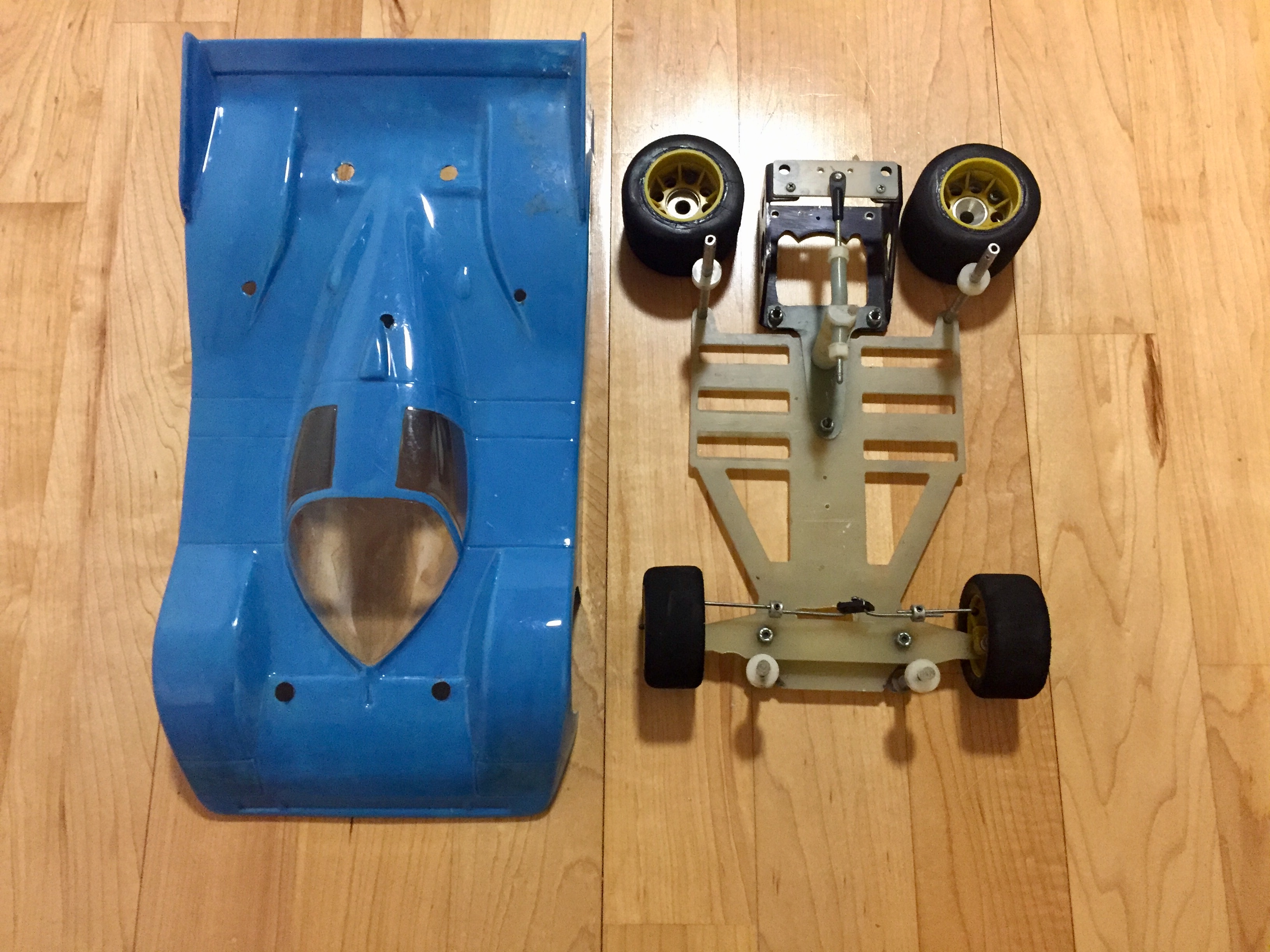

Seems that I have lost the rear axle completely. So everything including the diff is missing. I suppose there is no point for me trying to restore it. Any interest in parts here? Here’s all that is left.
