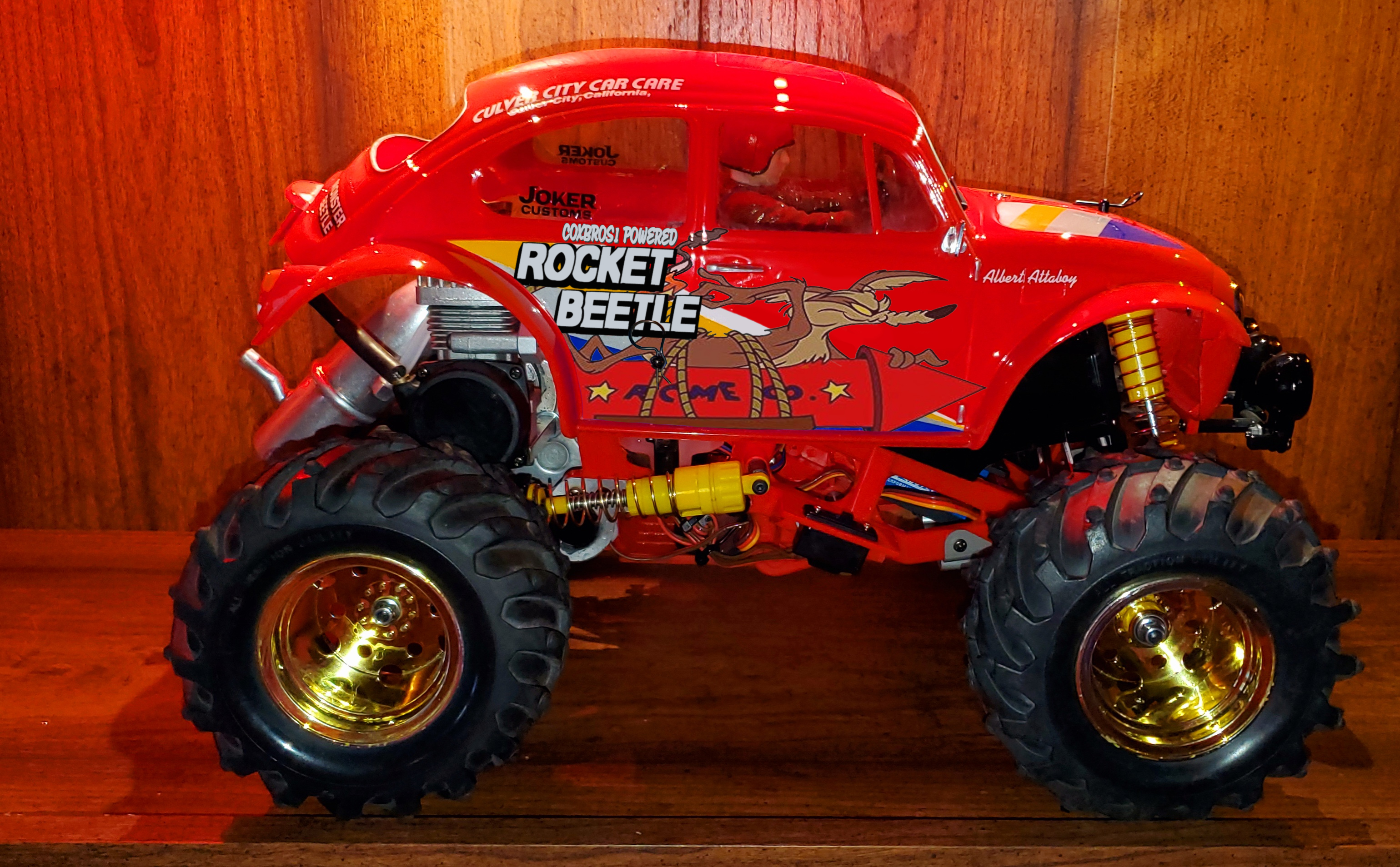

The Coyote decal is perfectly suited to this project. Awesome!
Helper spring?
coxbros1
Posts: 2495
Location: Energy, Illinois
Has thanked: 2758 times
Been thanked: 2407 times
Re: Nitro Monster Beetle
Post by coxbros1 »
1911Colt wrote: Wed Mar 20, 2024 8:05 am The Coyote decal is perfectly suited to this project. Awesome!
Helper spring?
The reason for that spring, is I had to relocate the rear shock mount to clear the engine...so that shock only has about 3mm movement on the shaft..it was real soft on that location..this evened up the resistance now both sides feel the same...cool u noticed!

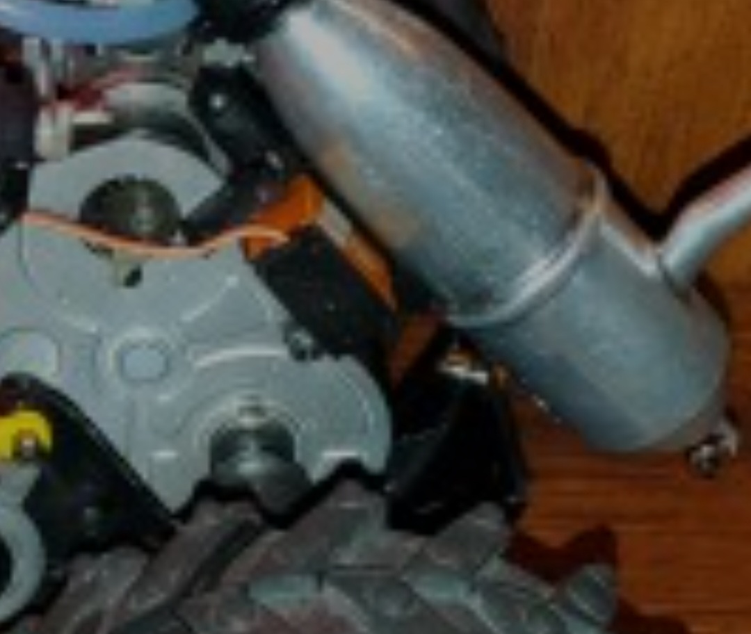

Thoughts on how this servo will deal with the heat from the pipe?
coxbros1
Posts: 2495
Post by coxbros1 »
Elkcycles wrote: Wed Mar 20, 2024 5:35 pm Thoughts on how this servo will deal with the heat from the pipe?
Don't think is gonna be an issue..if it is 500 degree heat tape can be applied
