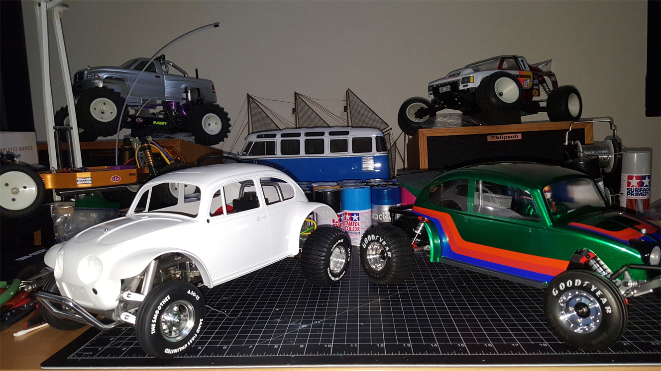

I think I may have finally lost it, I don't know what a Tamiyosho is, but this is starting to look correct to me somehow, it can't be. Blitzer Beetle/Kyosho Beetle.
Not sure if I'm going to be able to stop going down this path, really like the scale look these days, and that Blitzer body on the Kyosho won't leave me alone.

GreenBar0n wrote: Sun May 26, 2024 2:03 pm Going to decide on the tire writing for the Kyosho, leaning towards yes.
At first I was thinking no, I wouldn't...
...but it makes a really impressive difference with the tires painted:
Though... 1/10th Goodyear decals/waterslides would look soooo good:

Dangeruss wrote: Sun May 26, 2024 10:13 pm
Nice work!
The tire writing really does it for me on a set of shelf tires, wish the paint were more durable, would love to drive around like that.
Still deciding what to do on this one. Took another look at it today and thought about putting the stock chrome wheels back on - leaving it all Kyosho, and finding another place for those Centerline wheels.

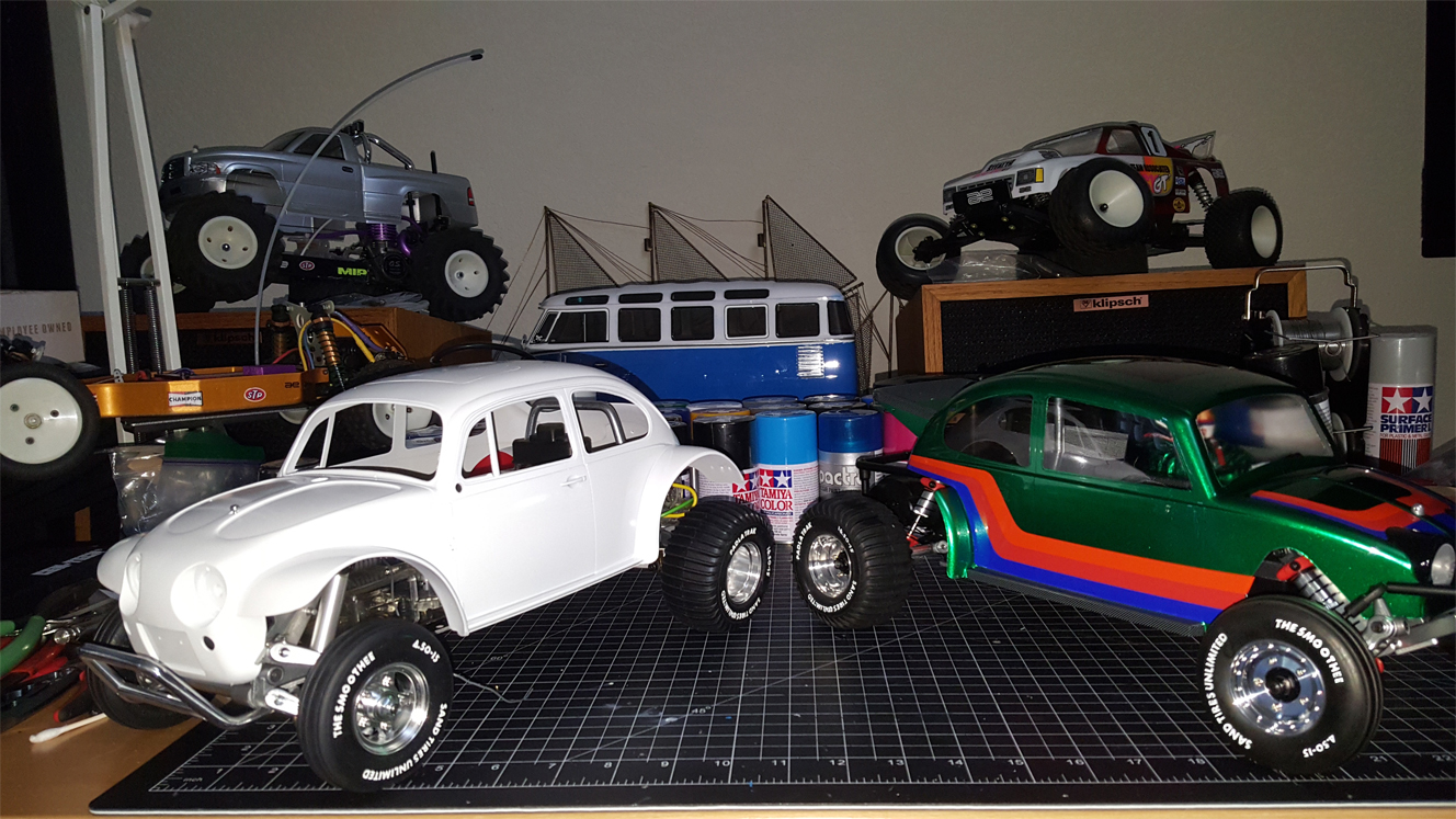

Decided to get rid of the silver stainless wheel screws.
Added black M2 hex cap screws, for the lug bolt look, and built the other five star wheel kit I had. Centerline look on the left, Jackman look on the right - the very best of the Baja Bug wheel choices for back then.
Now that this Kyosho can run Tamiya rims, I've got more than a few inexpensive choices for wheels and tires.
Going to get the decals on this one, and then figure out what wheels to run.

Decided to keep this all stock, or close to it.
This one is now completed. Thanks to all who participated!
