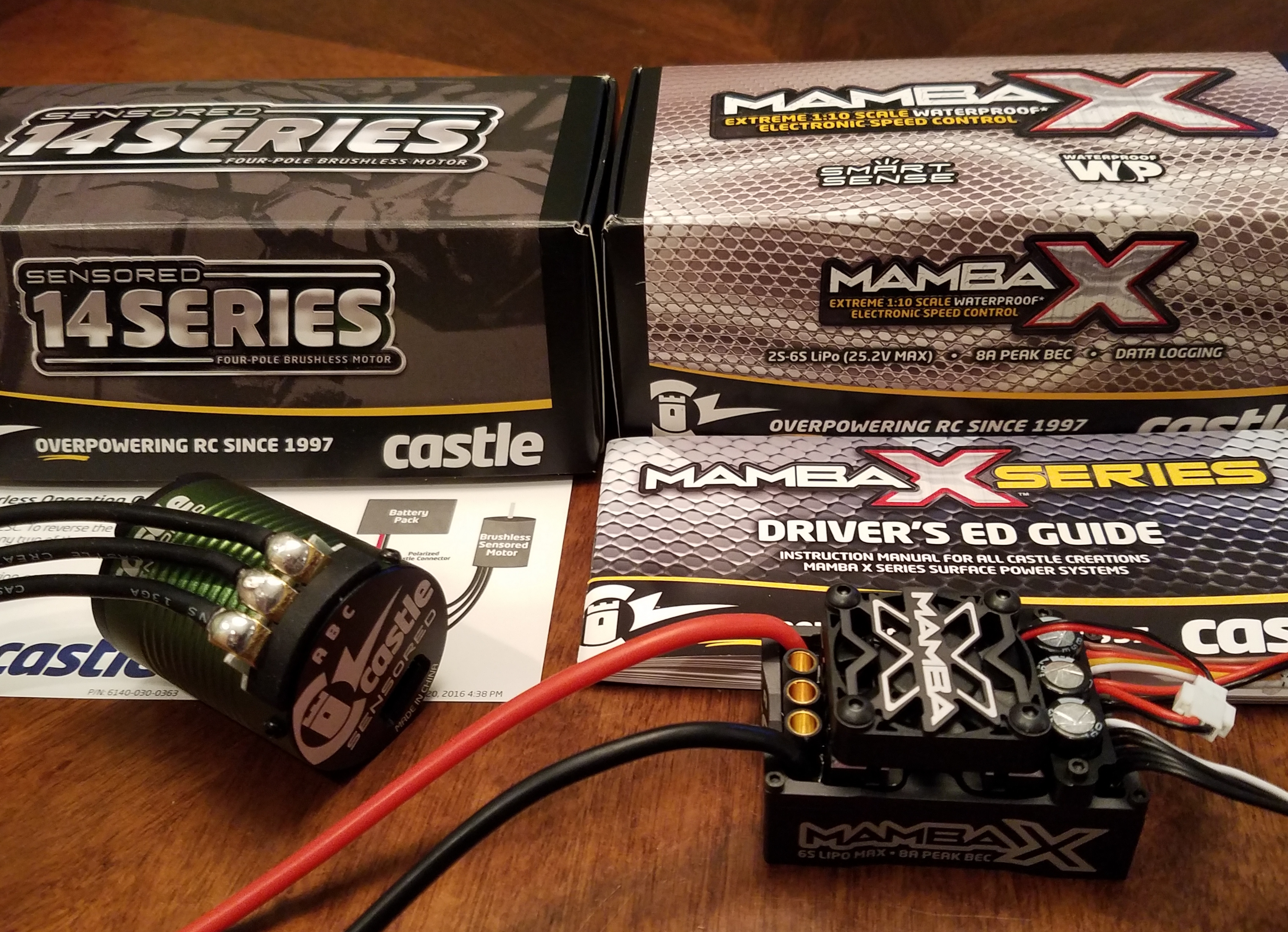

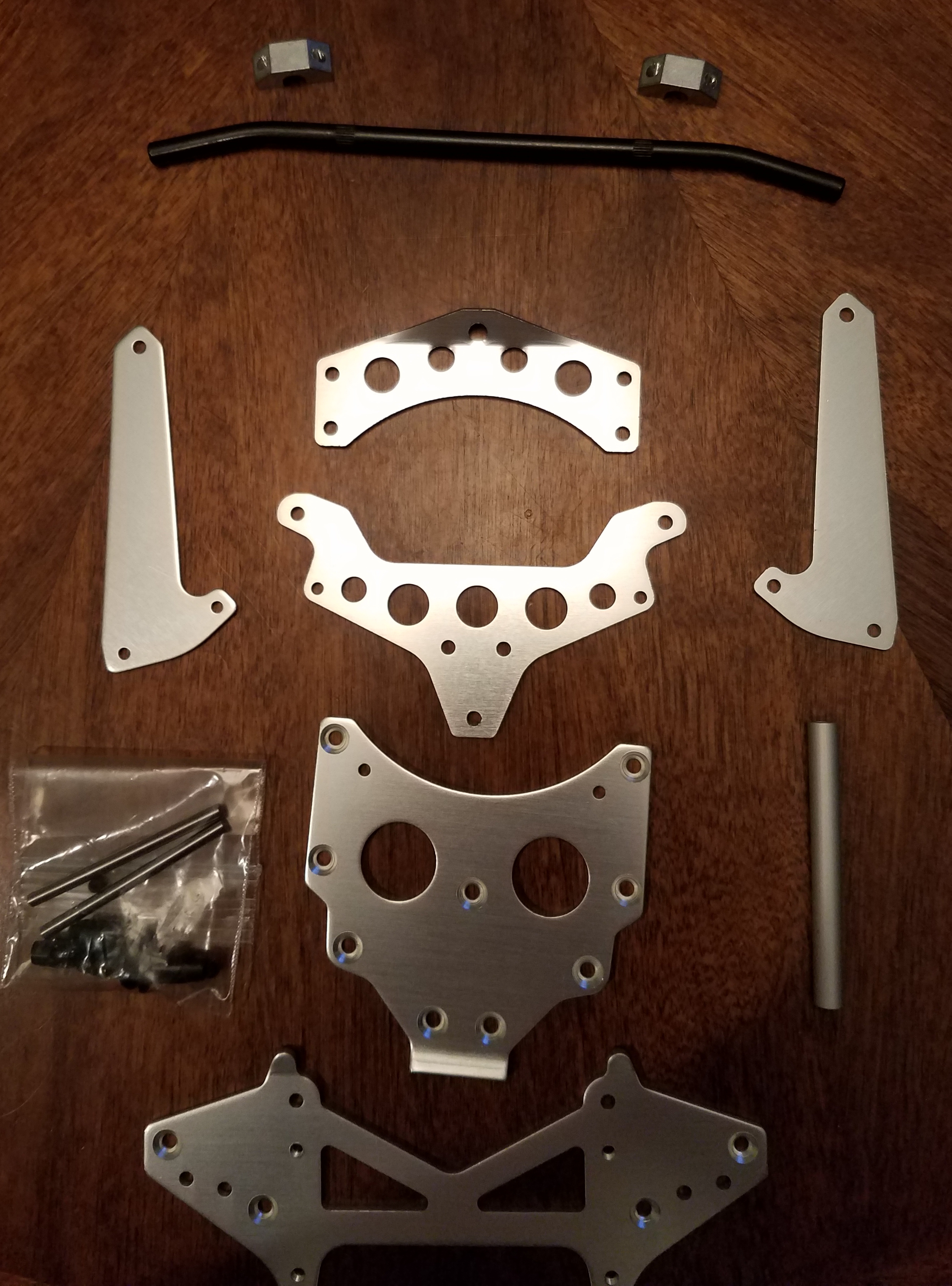

Parts started coming in this weekend. I'm waiting on my stainless screw kit (which should be here today) to start building the kit. I decided to wait on the stainless screws b/c this buggy will be a dedicated sand/beach toy.
The Mamba X ESC is a little large, but it will just fit inside the tub with the lid in place. There is room above the fan to circulate air onto the esc, but if it were any larger I would probably have to remove the fan. I know sand gets into everything, but I dig that the way the electronics are somewhat enclosed on the Beetle. The esc & motor are advertised as waterproof so they should make a good combo for beach running.
I decided to for forgo the yellow wheels that came in the kit. The satin aluminum, to me, looks a lot more scale correct. The kidney-beans in the rear and Centerlines in the front scream 1970's sand beetle. Gotta love the huge Good Year lettering on the tires...especially the rear.
These are the re-re Turbo Scorpion pieces that will allow use of the longer Turbos Scorpion or option HG shocks as well as the chassis extension pieces, hard rear trailing arm pivots, etc. I don't know if I'll use the wide Turbo Scorpion front arm shaft pictured. It would require longer tie rods which isn't a big deal, however the extra width may make the front track look too wide on a Beetle and I don't want to ruin the scale appearance. If it doesn't look bad I'll use it. Every little bit of extra width should help b/c this thing should be a screamer on packed hard sand. The esc & 5700 kv motor are 3s capable, but I don't know if a 30 year old design is up to that...even with a few built-in improvements. I'll start with 2s which is probably still way more that its capabilities and dial it back if necessary. I'm thinking sand-running should be a little more forgiving anyway...even if it is more damaging from a corrosive standpoint.
Adam

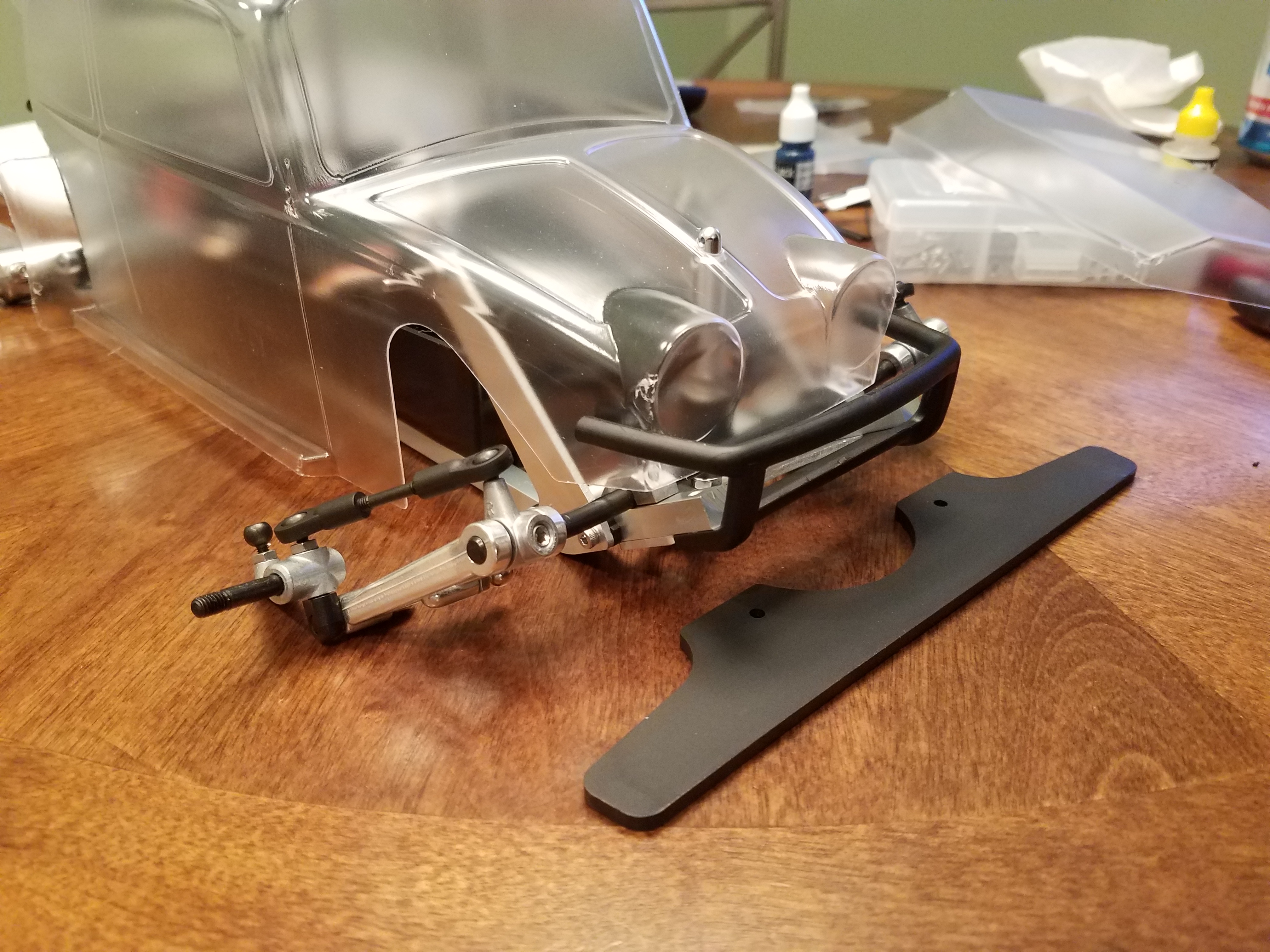

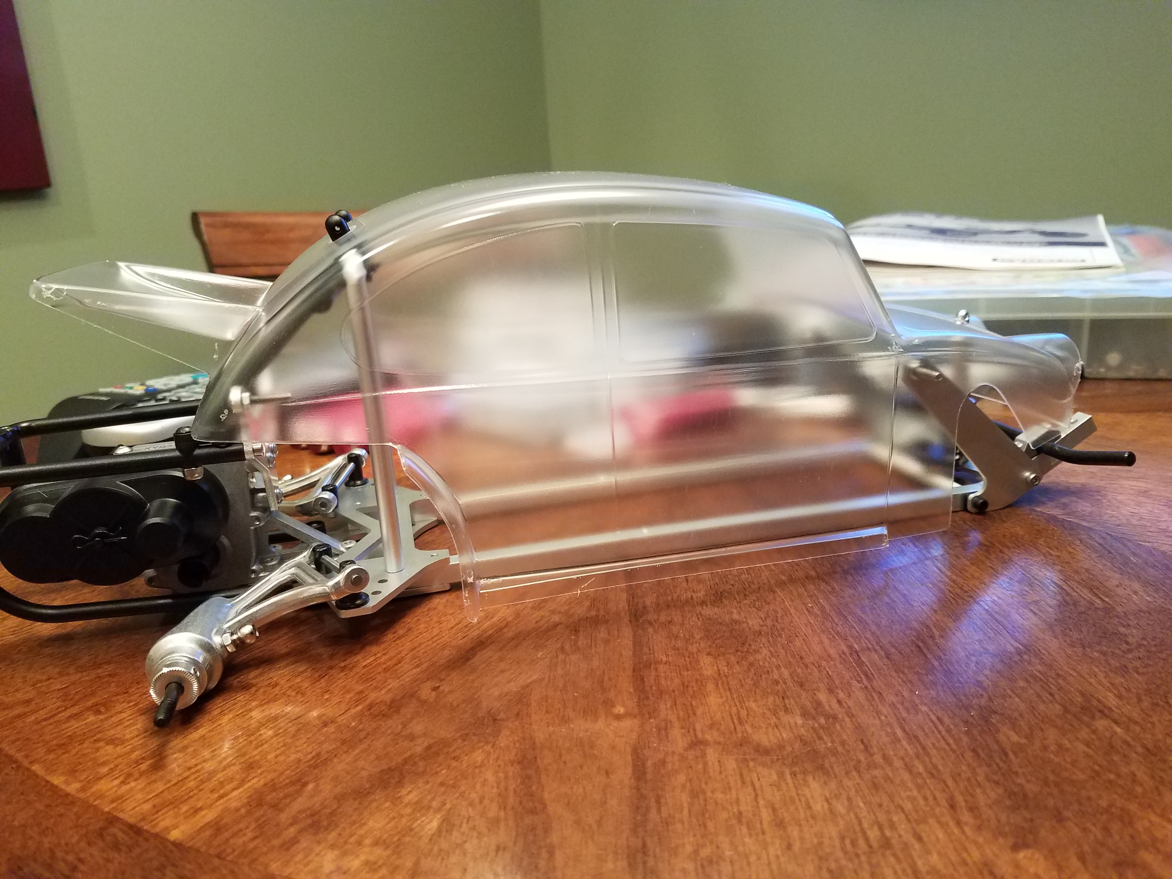

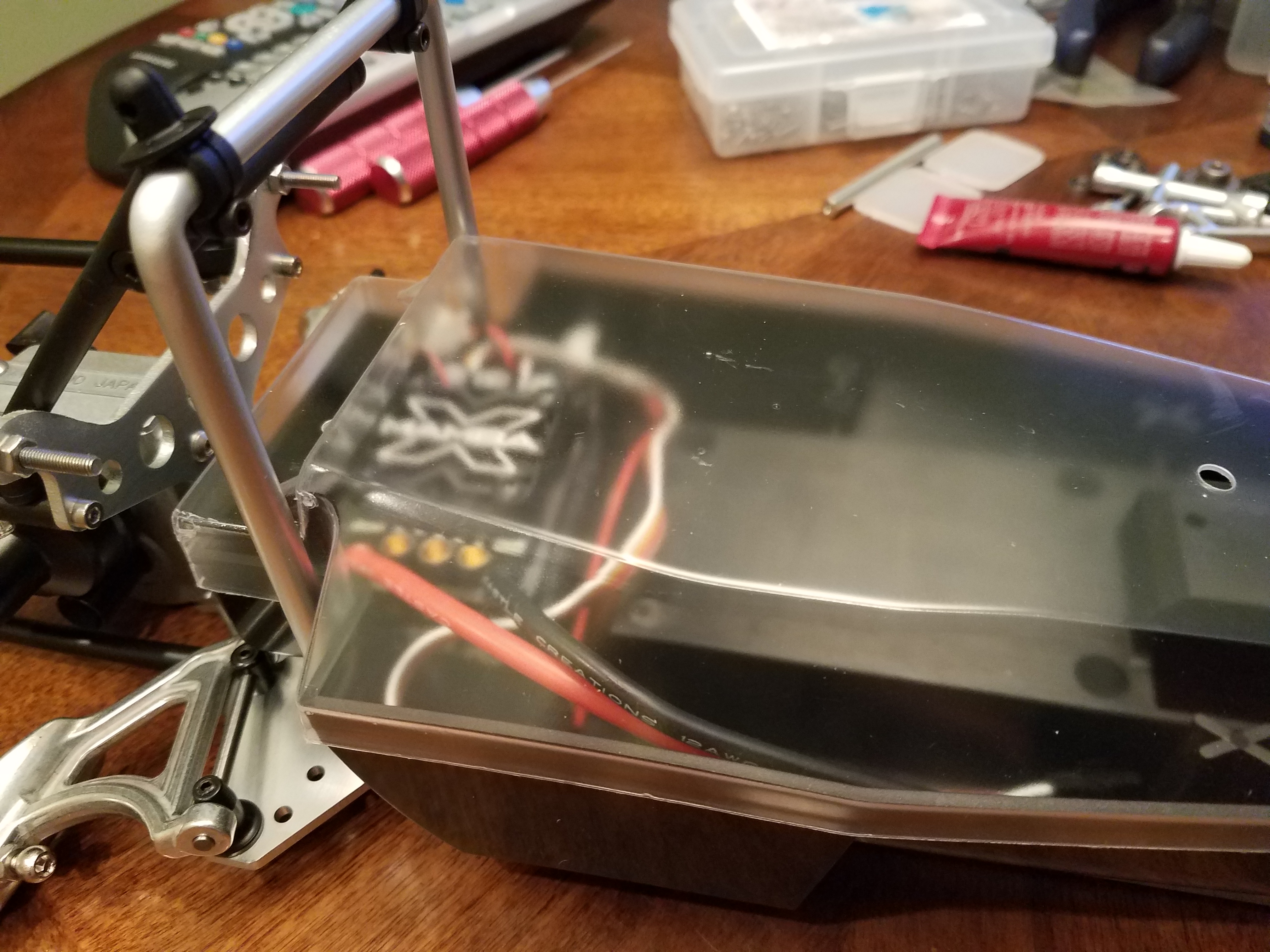

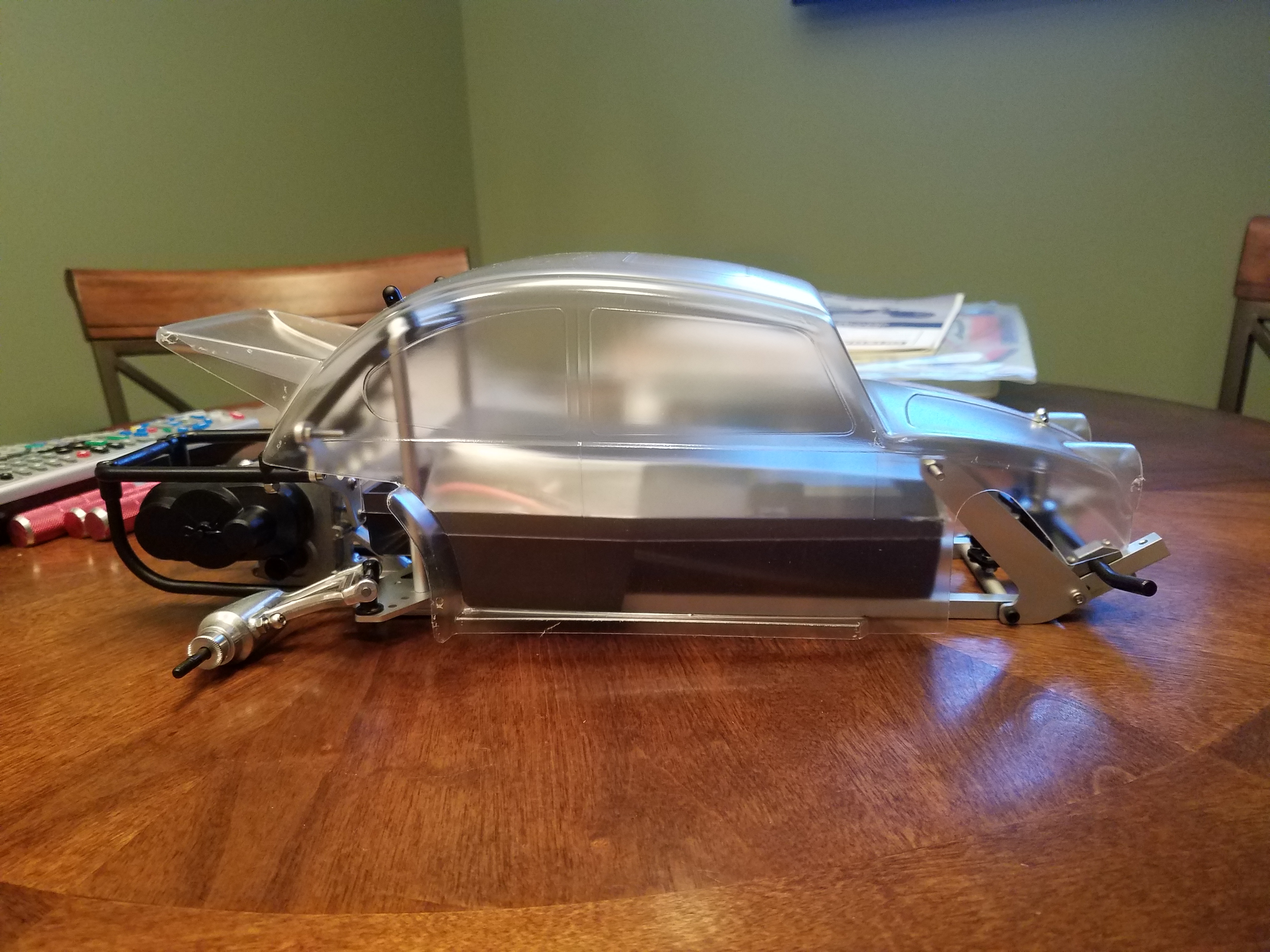

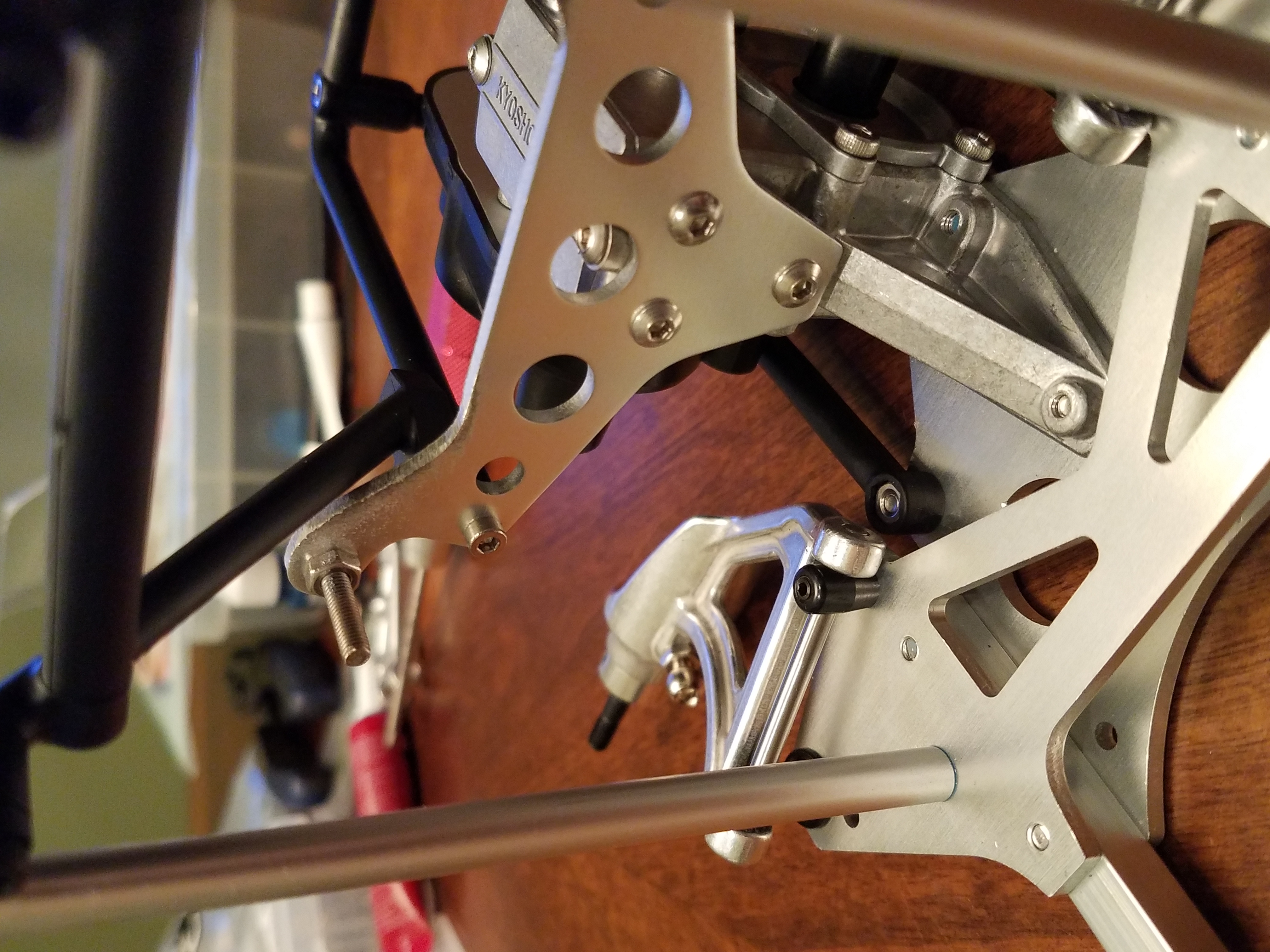

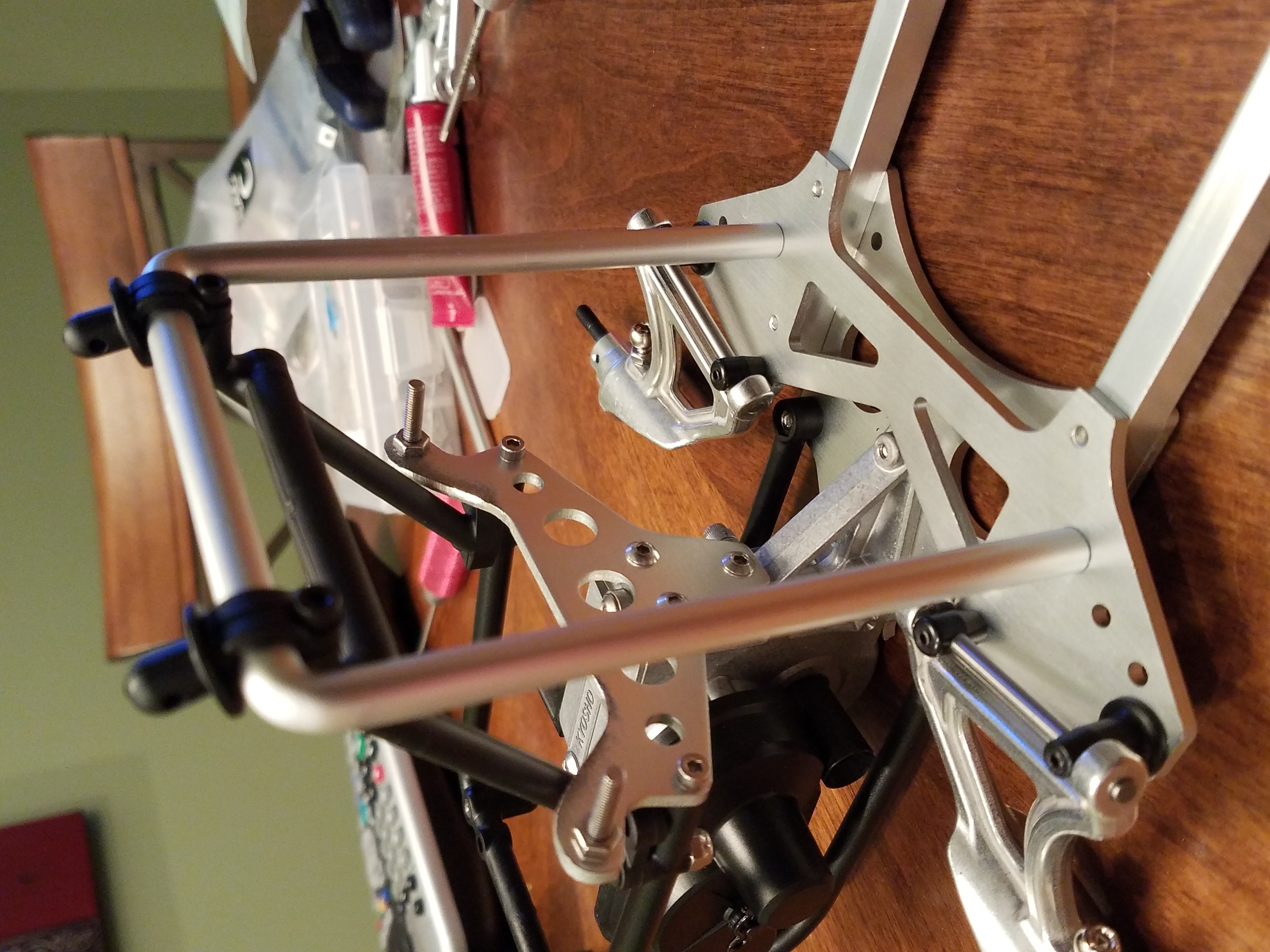

Got started last night...
The taller Turbo Scorpion rear shock towers were making contact with the body mount brace, so I had to remove a bit of material to get the brace to clear the tower. This probably would not have been necessary if you use the stock Beetle towers with the extended chassis pieces or if you use the tall shock towers and do not extend the chassis, however, if you do both the tower has to be ground or filed down a bit. I don't know why but these two pics are rotated 90 degrees in this post even though they appear normal on my computer when I attach them.
I'll also have to trim the body a bit in the front to make room for the longer HG shocks. They are still in transit so that will have to wait until they get here.
In this last pic you can see where the Mamba X has to be mounted inside the tub. It's not taped in place yet, but it just barely fits with space above the fan. You can't really see in the pic, but the rear two screws on the corner of the fan sit right up against the underside of the lid at the back where it steps down. If the esc or fan were any taller it would not fit with removing the fan.
Adam

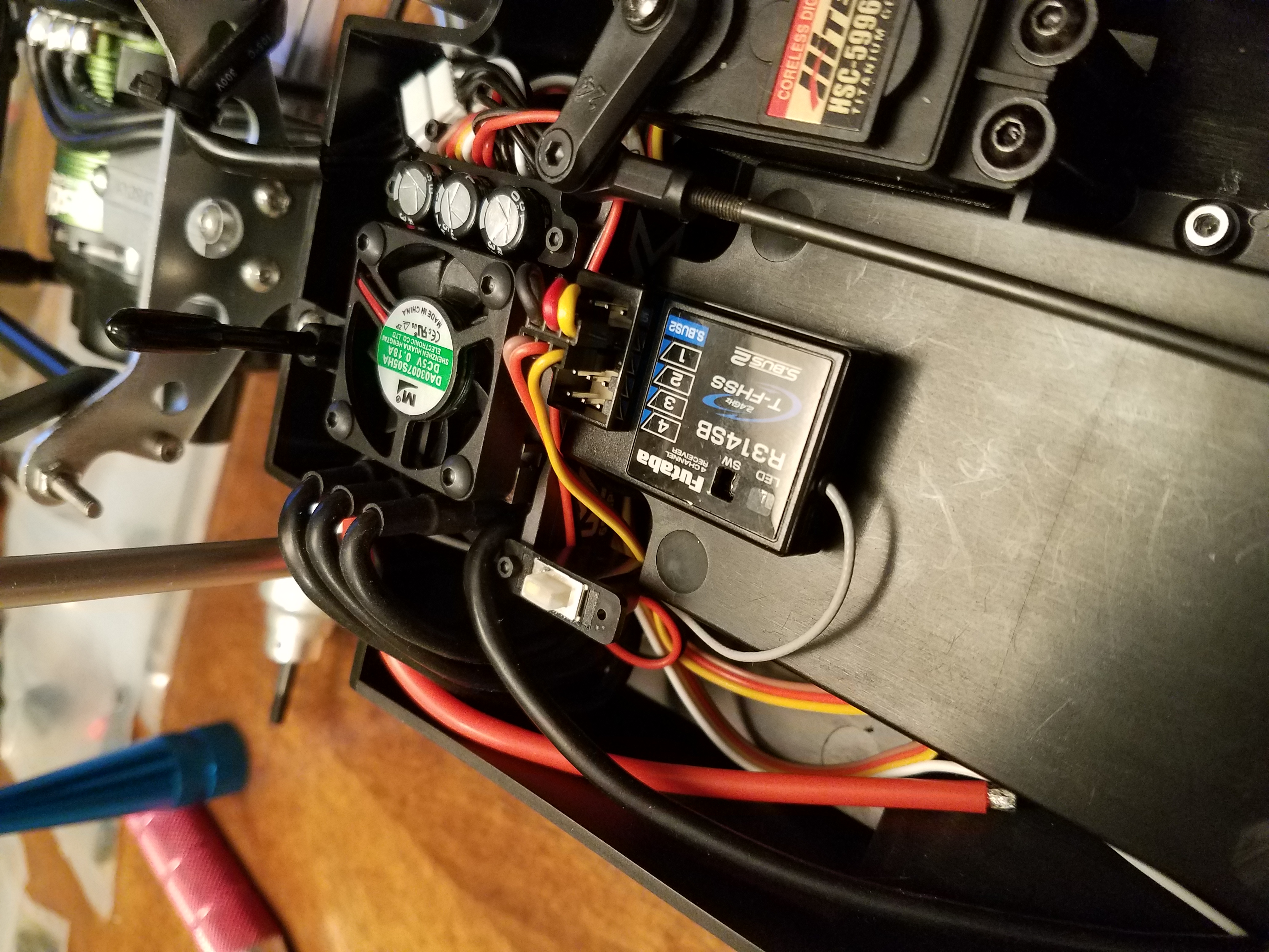

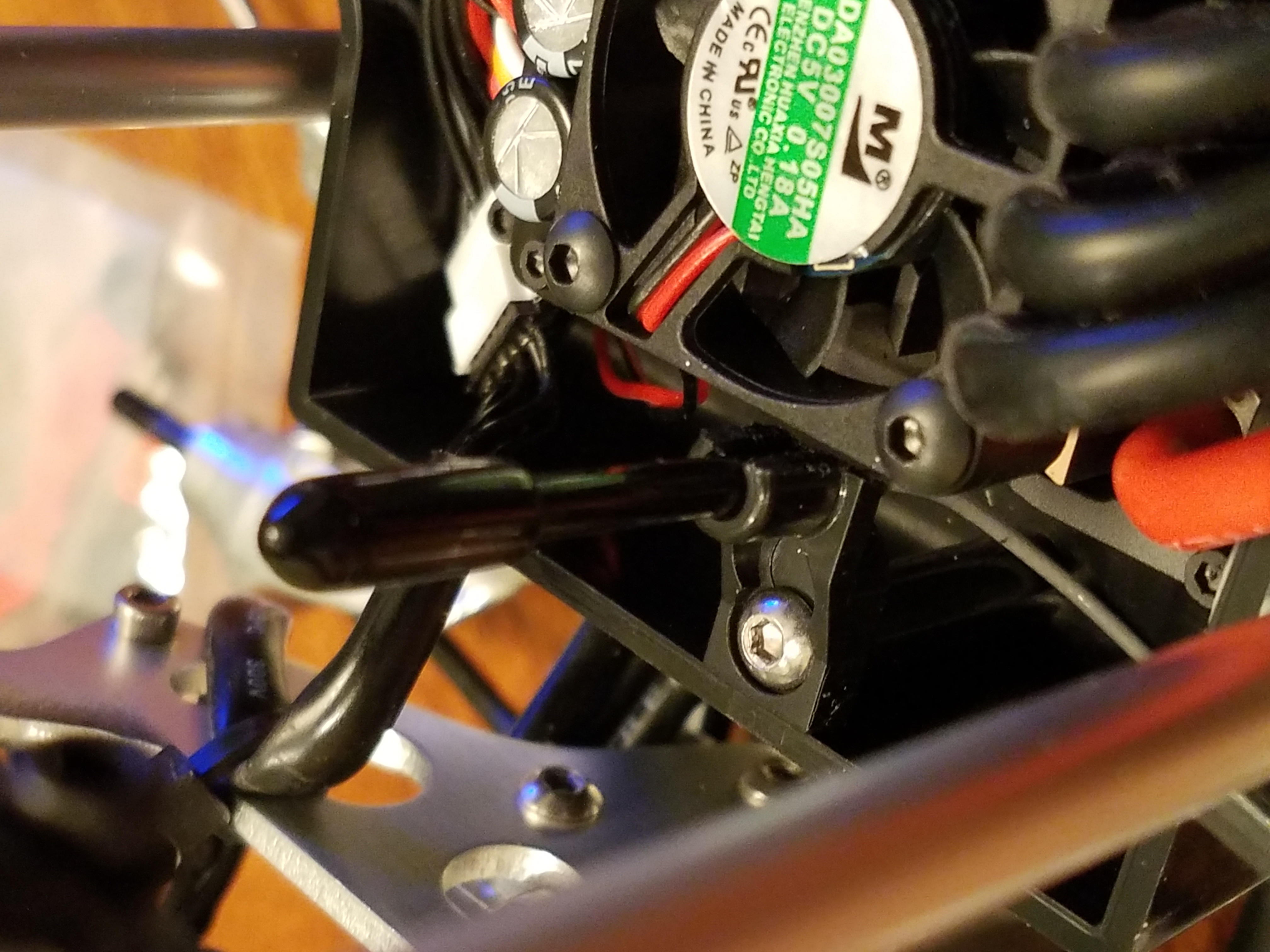

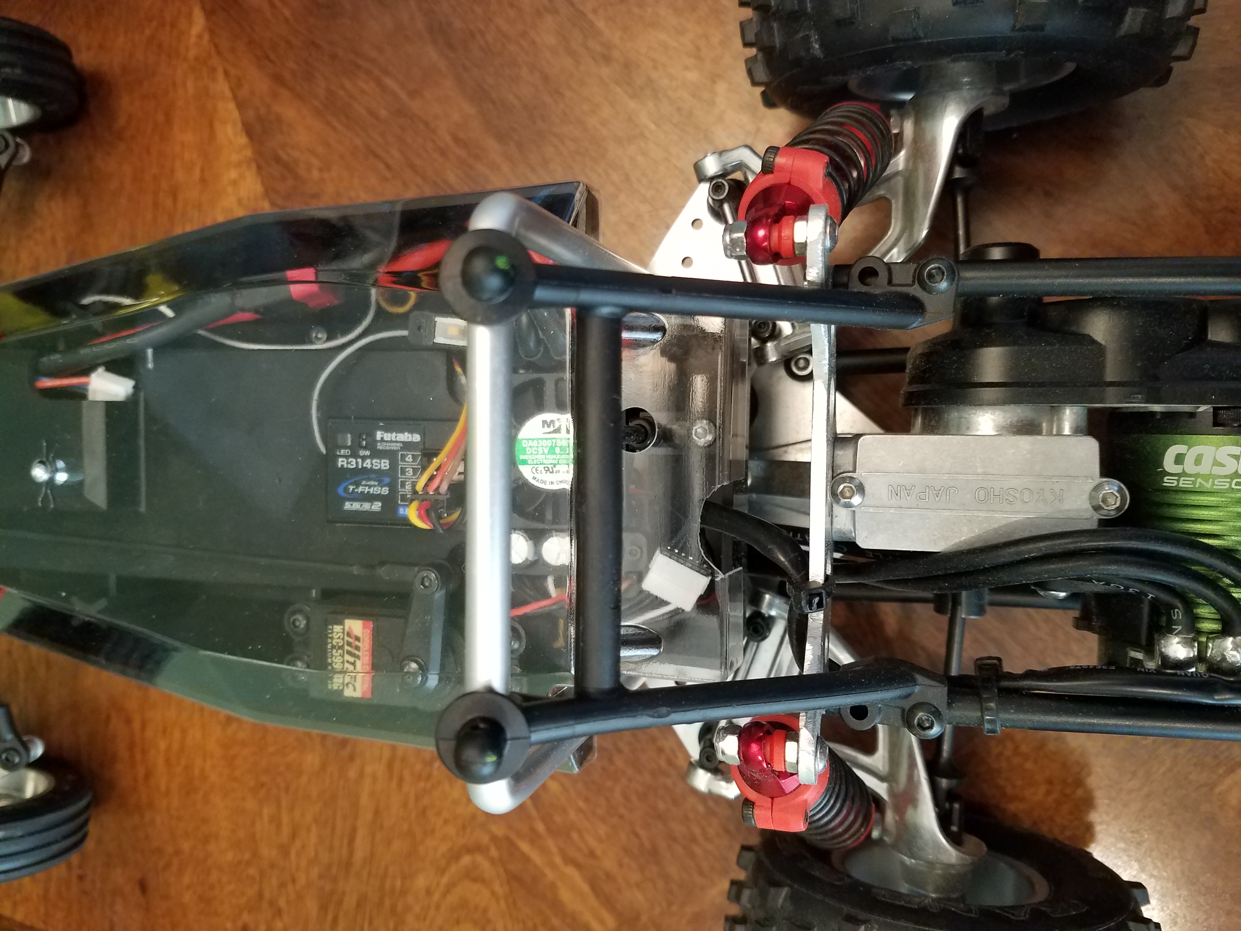

A couple of nights ago I was able to get the electronics all sorted out.
Because of the height and overall size of the Mamba esc, I had to cut the antenna support. Originally, it had a platform extending forward to which you are supposed to tape the esc switch. With the switch mounted on the platform, you can cut an opening in the tub cover and switch the esc on and off without removing the cover. This ended up not being an issue because my esc battery leads are so short that the connector had to be located inside the tub anyway, so I'll have to remove the cover to disconnect the battery. I ended up using one of the esc corner screws to hard mount the switch...I don't like using tape for the switch.
I ran the three motor leads through the opening in the bottom of the tub. There wasn't enough room to route the sensored lead through the same opening so I had to trim an opening in the tub cover. In the following pics you can see the opening I cut in the lid and the routing of the wires. Also, I decided to leave the lid clear. With it clear I can easily see if the fan is operating or not as well as any indicator lights flashing on the esc without having to remove it.
The kit came with two front bumpers. The wide bumper may provide more protection, but the tube-style bumper looked a little more scale correct so I went that route.

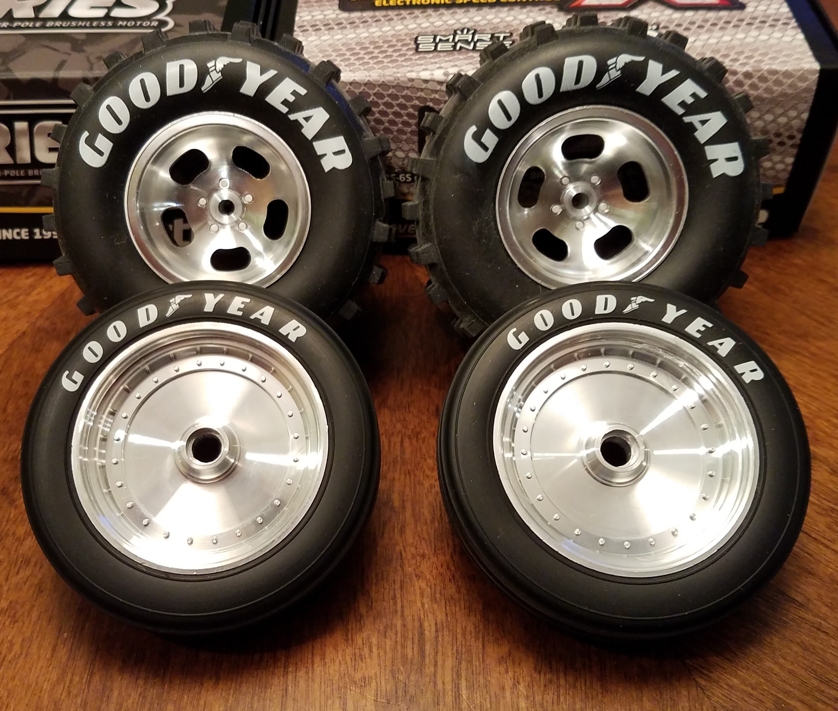

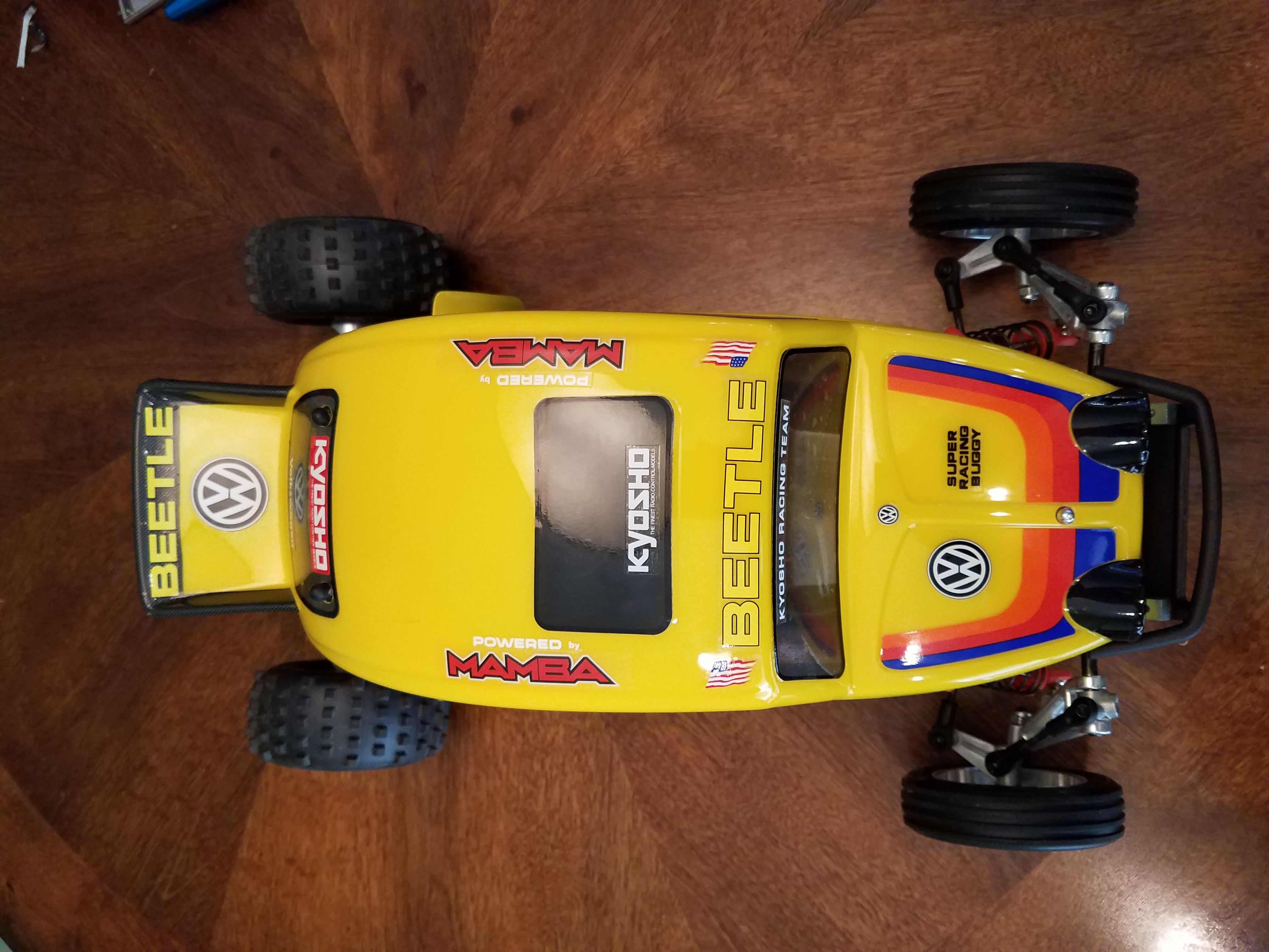

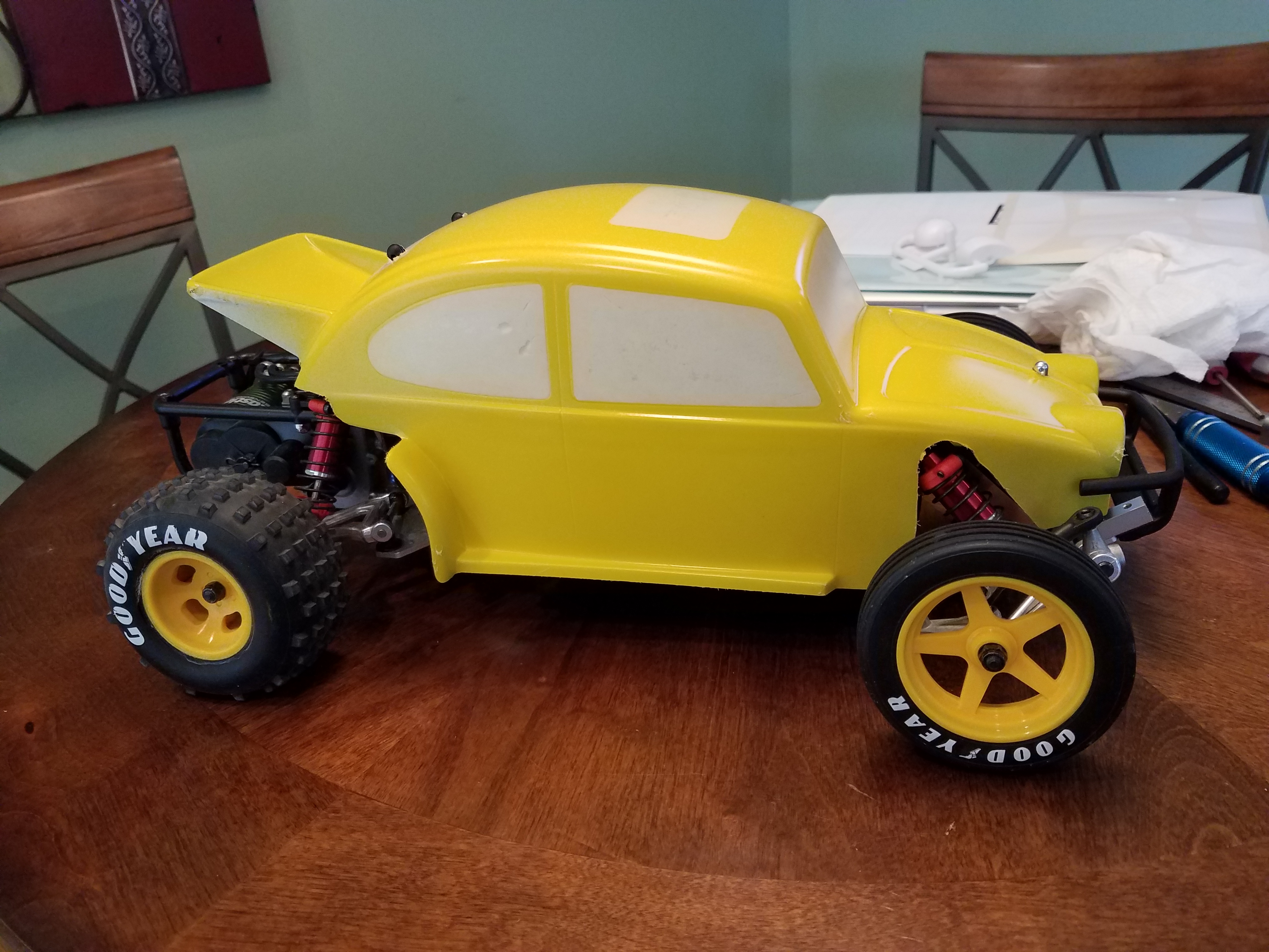

Painted the body yesterday. I used Tamiya PS-06 yellow, backed with Pactra florescent racing yellow backed with sprint white. It's a little brighter than the box art, but it's not quite fluorescent either. You can see that the yellow is a bit brighter than the yellow wheels that came with the kit.
Before painting the body, I decided to run the car bodiless. I can say that without a doubt, that the front tires are pretty much useless on hard concrete or asphalt. They are just way too hard. Even with the 5700 Mamba cut back to 50% with the controller you just couldn't steer. I have soft and medium compound tires on the way, but I wanted to see just how quick the car was and it was a futile effort to try to drive it at all. I ended up swapping the front tires from my re-re Turbo Scorpion onto the Beetle and they made all the difference in the world. Even on my concrete driveway (which is slightly textured), I was able to increase the power back up to 75% and could steer moderately well. That's with the 1.5" Beetle wheels and tires that came in the kit still on the rear.
I'm getting short on time before we go to the beach and am unsure of whether the inability to control the Beetle was because of the tire compound or the wheel diameter, or most likely a combination of both. So, yesterday I ordered a set of 2.2" front medium compound & rear soft compound tires for the Beetle. To mount the tires, I ordered a set of Turbo Scorpion wheels but in stain chrome. To me the satin chrome just has a much more realistic look.
We'll try both the softer compounds in stock size as well as the 2.2's and see what happens. Regardless, I don't see why Kyosho includes such hard front tires in the kit. Even with a very mild motor they are just too hard to get any grip on a hard surface. Medium compound tires would be a better all-around tire.
Adam

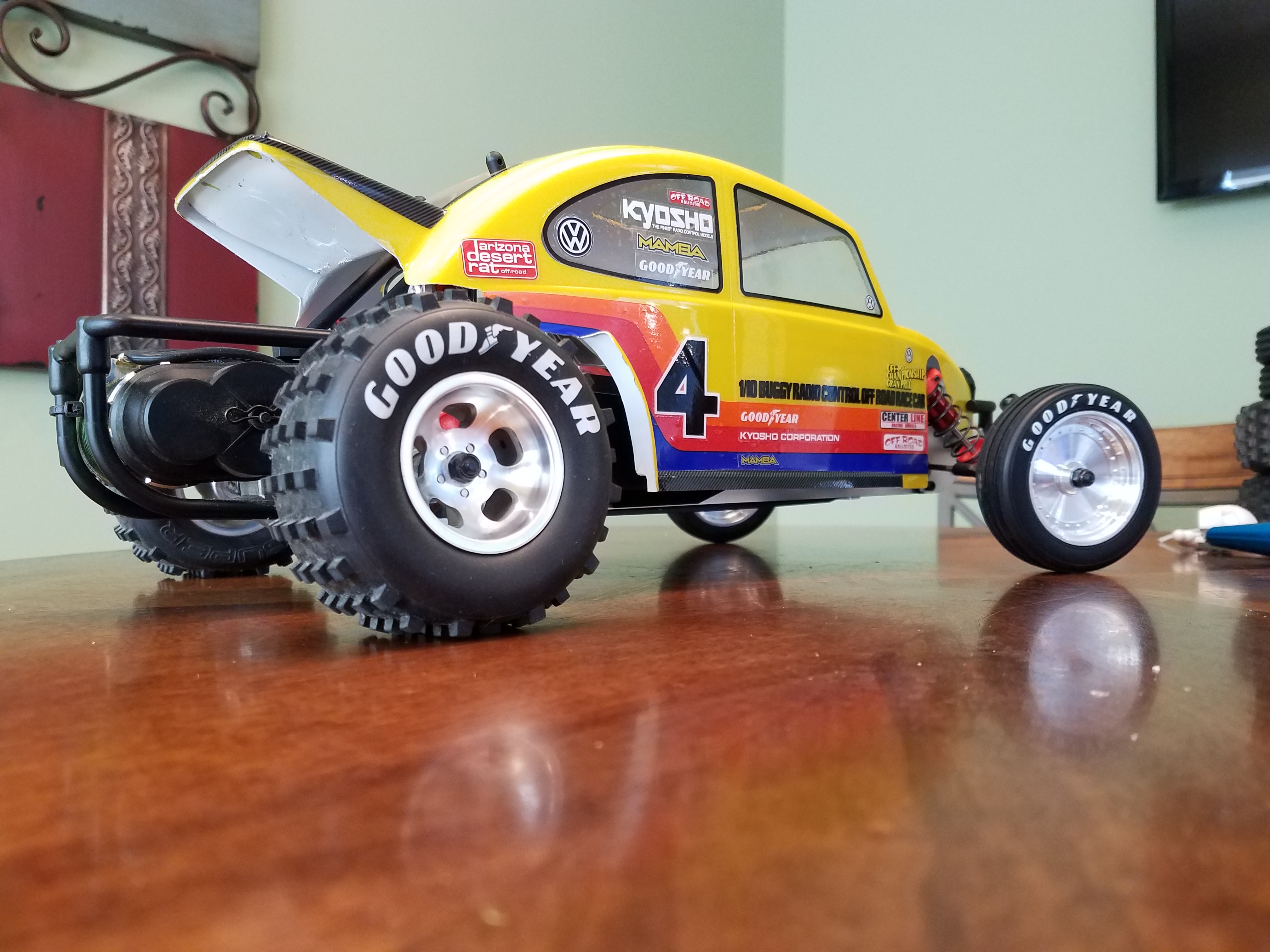

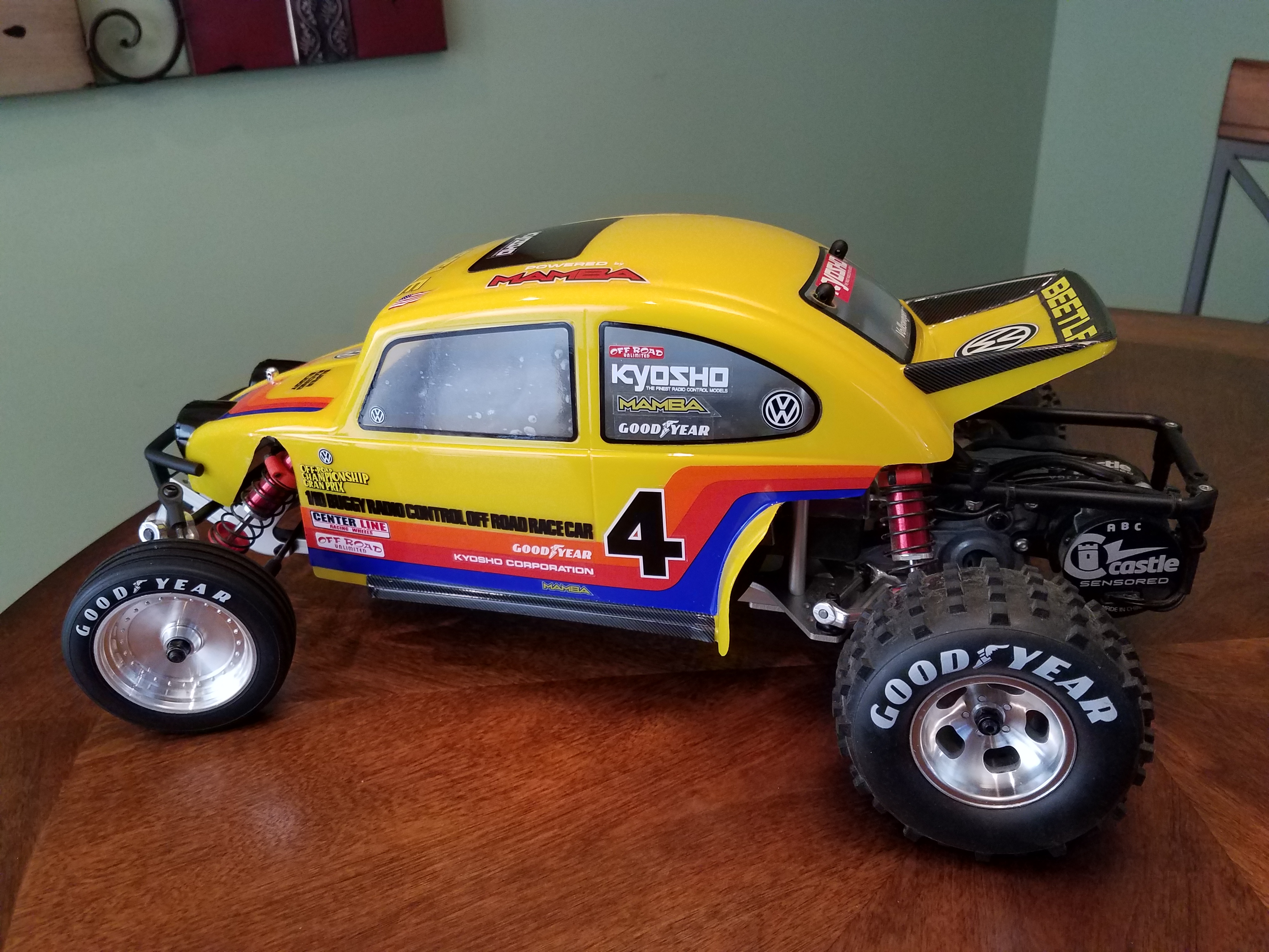

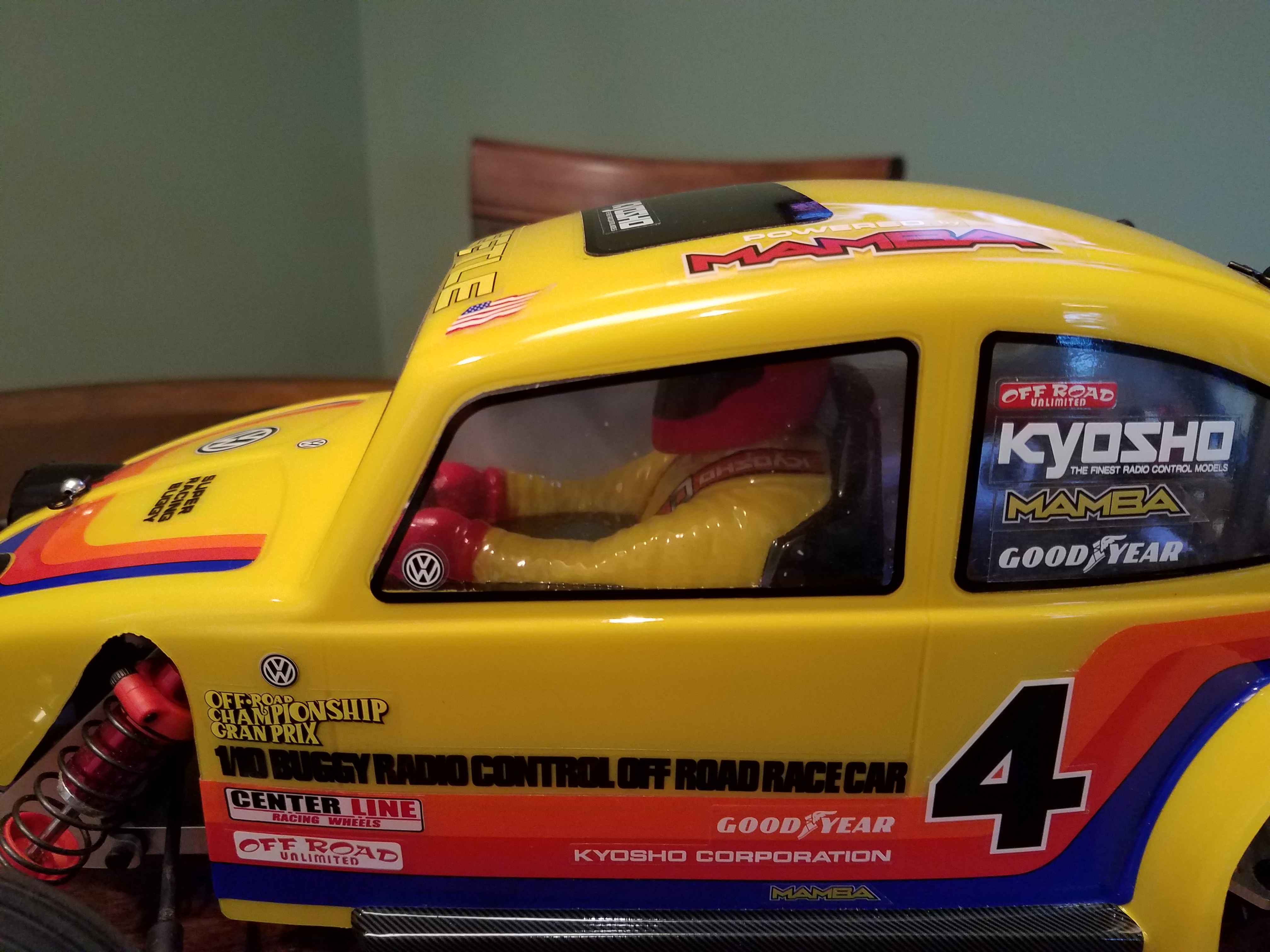

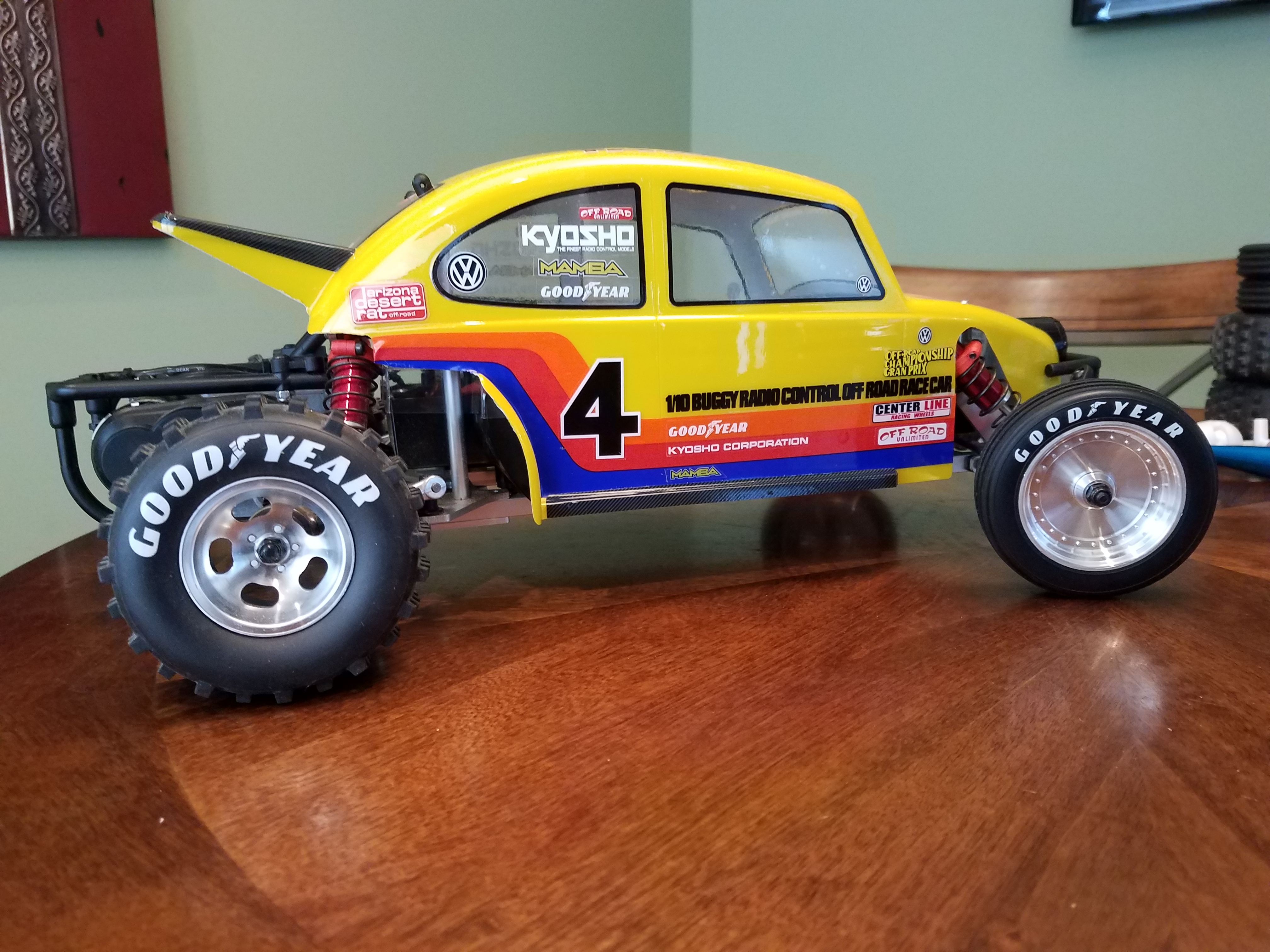

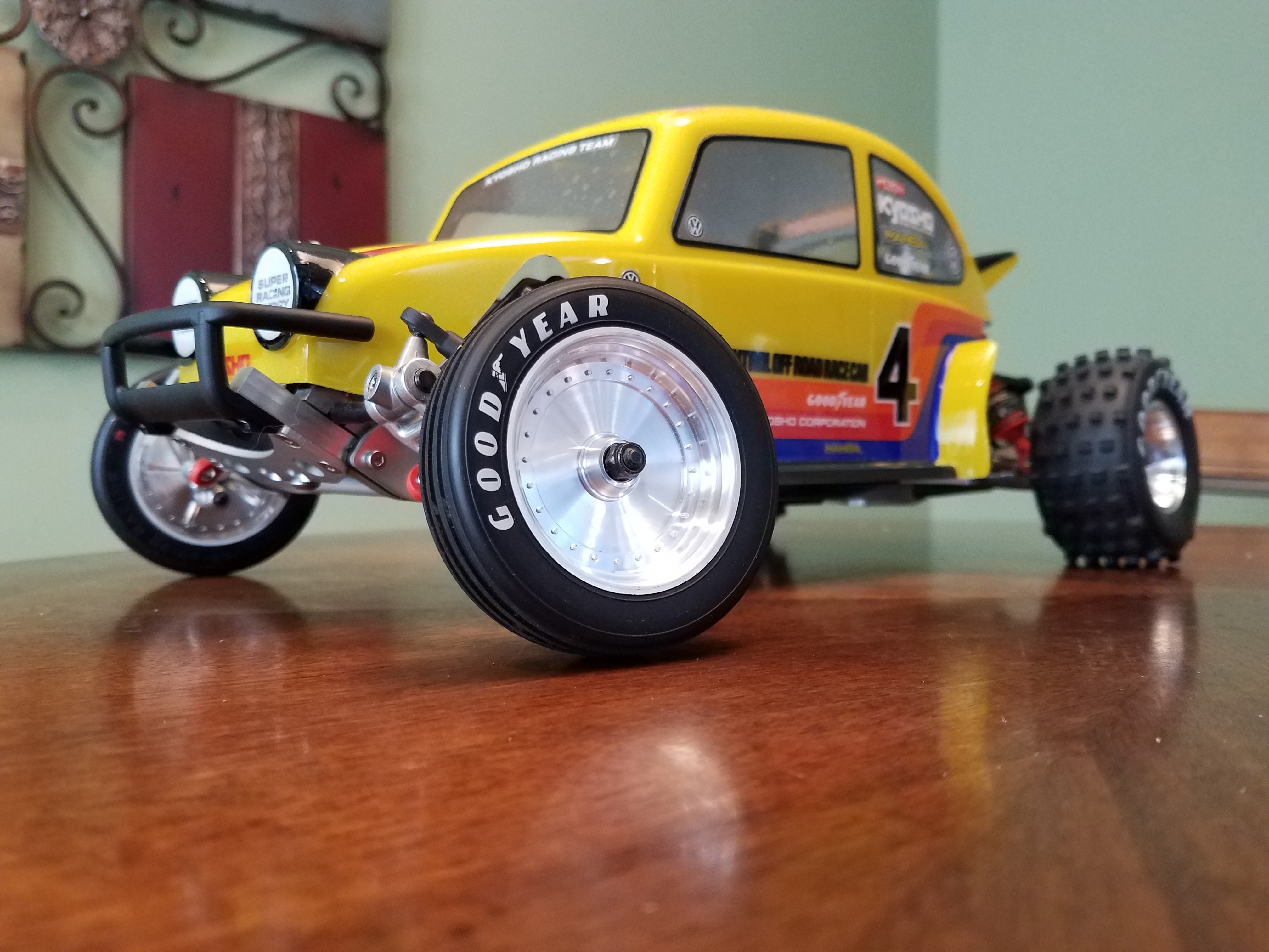

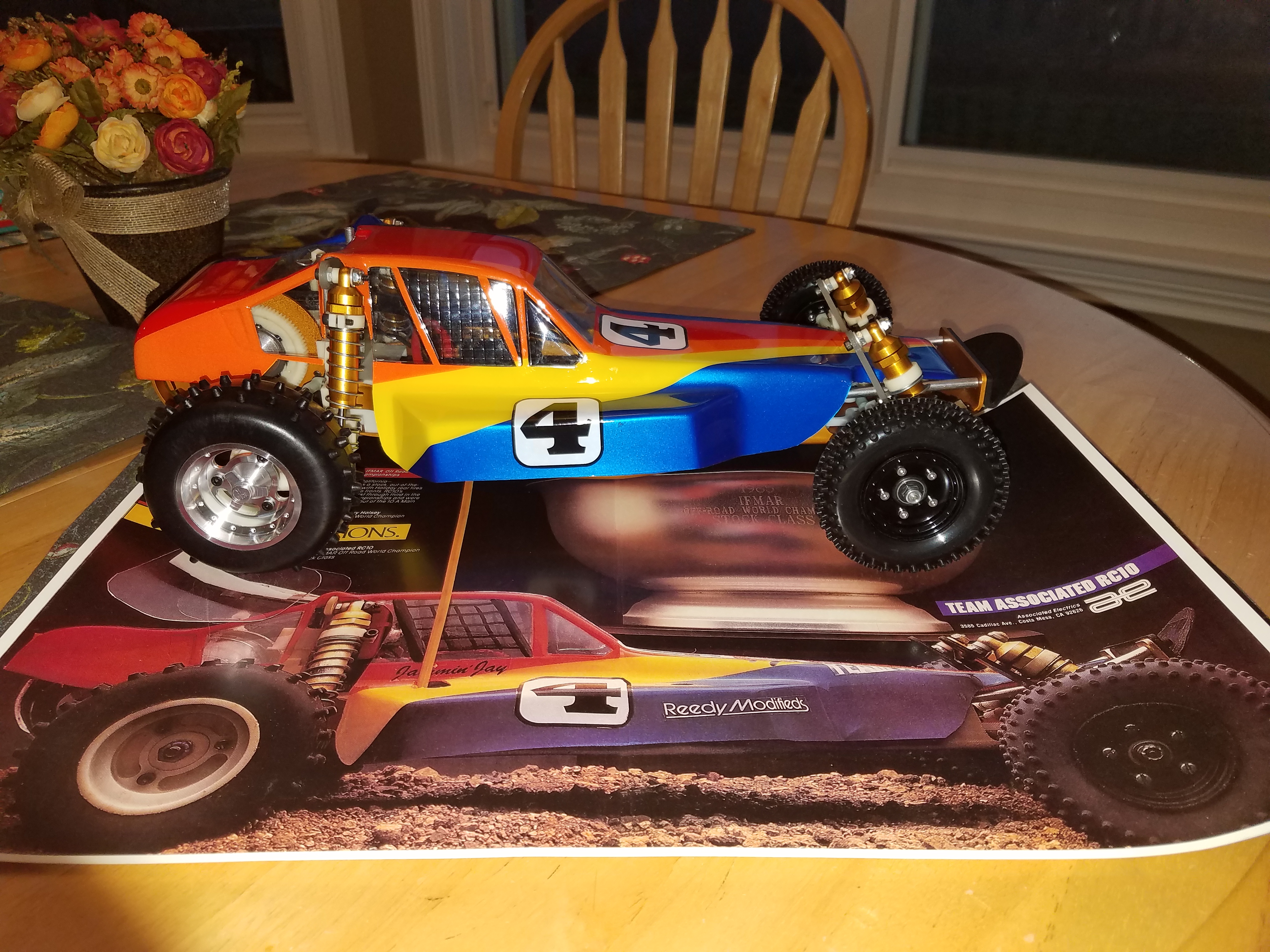

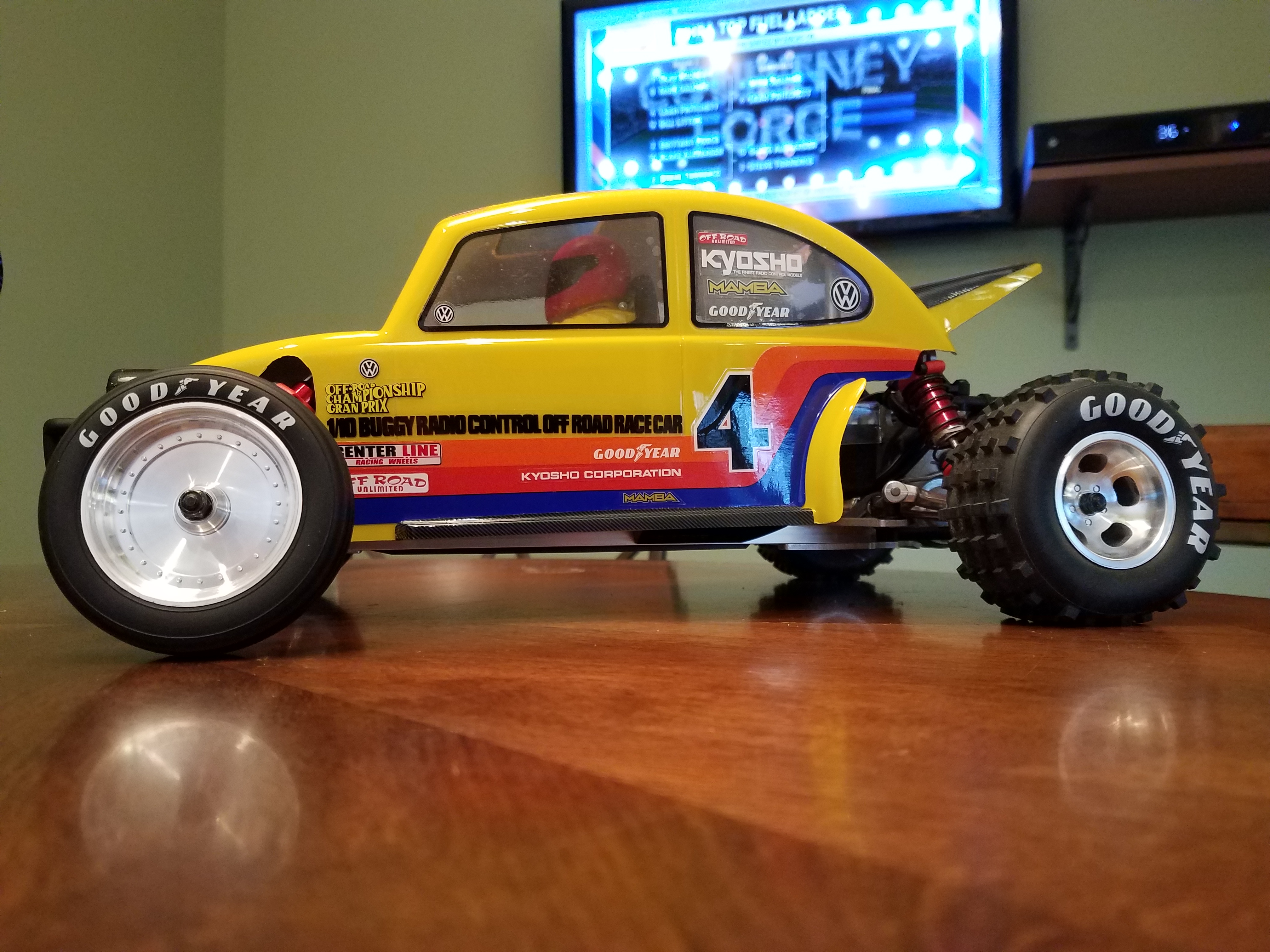

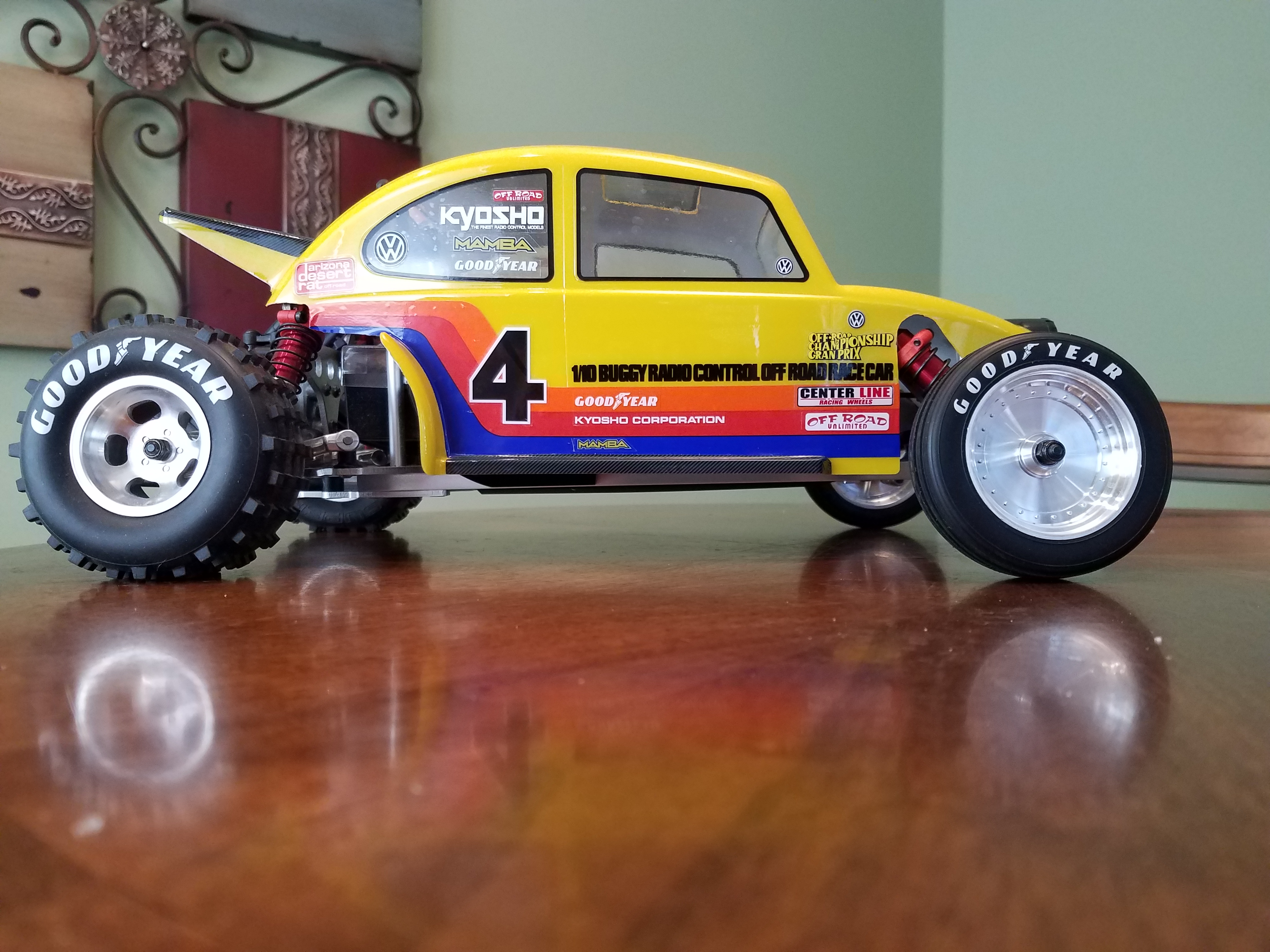

Here are some (mostly) finished pics...still painting driver figure.
I kind of went mostly box-art and then dug through all of my old decal sheets to add a few more. I was stoked to find the Centerline wheel decals in a repo Javelin decal set I bought a decade ago. It seemed a necessary addition with the Centerline-style solid front wheels.
