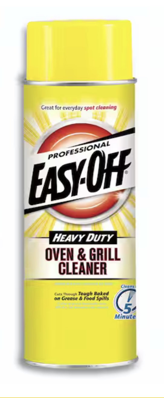

Same.
I usually get the cheap stuff at Dollar Tree. It isn't quite as strong as the more expensive ones but still works.

I’m thinking that’s probably just a degreaser…..

It has the same Sodium Hydroxide (lye) in it, that the aerosol does.MarkyDents wrote: ↑Wed Jan 15, 2025 7:51 pm I’m thinking that’s probably just a degreaser…..IMG_1550.jpeg
Here's the proof
I did want the inside of the shocks left orange.

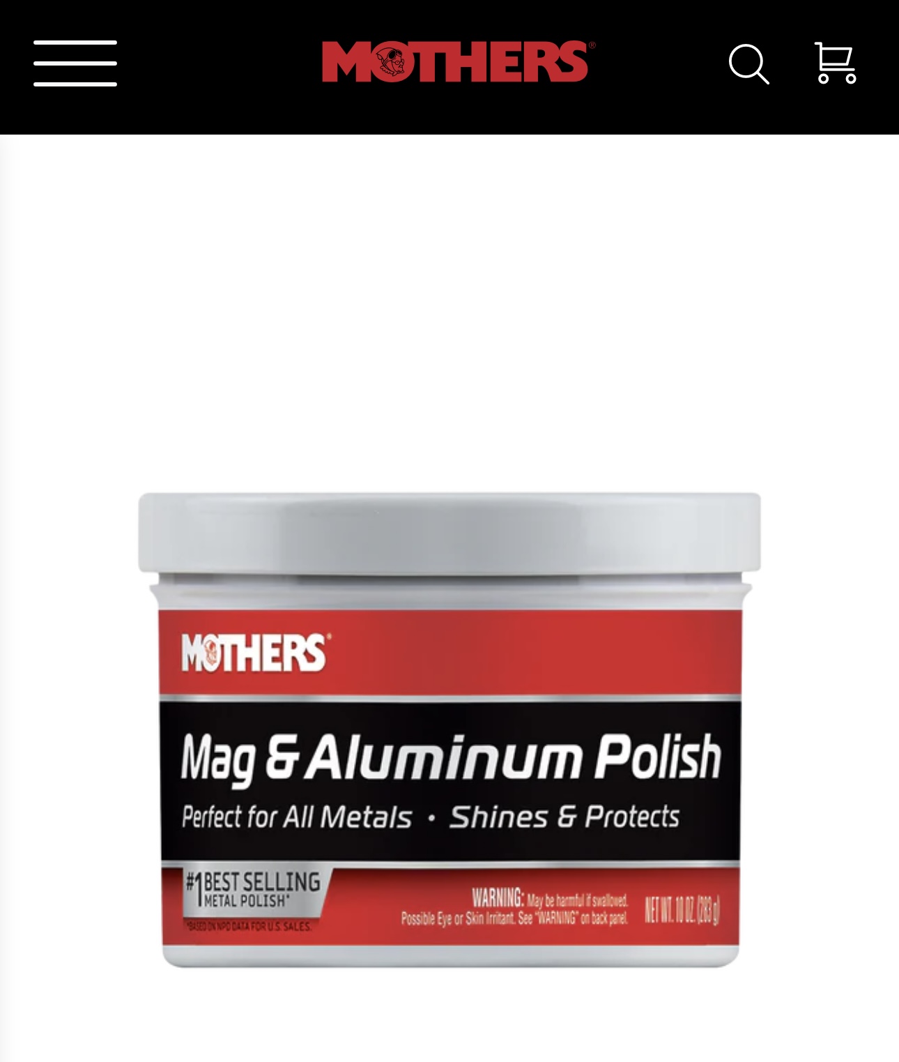

What's everybody using to polish these back to a shine again? Mother's?

Nice! I had the same thoughts/concerns about removing the anodizing from the bores/interior.GreenBar0n wrote: ↑Wed Jan 15, 2025 8:33 pmIt has the same Sodium Hydroxide (lye) in it, that the aerosol does.MarkyDents wrote: ↑Wed Jan 15, 2025 7:51 pm I’m thinking that’s probably just a degreaser…..IMG_1550.jpeg
Here's the proof![]()

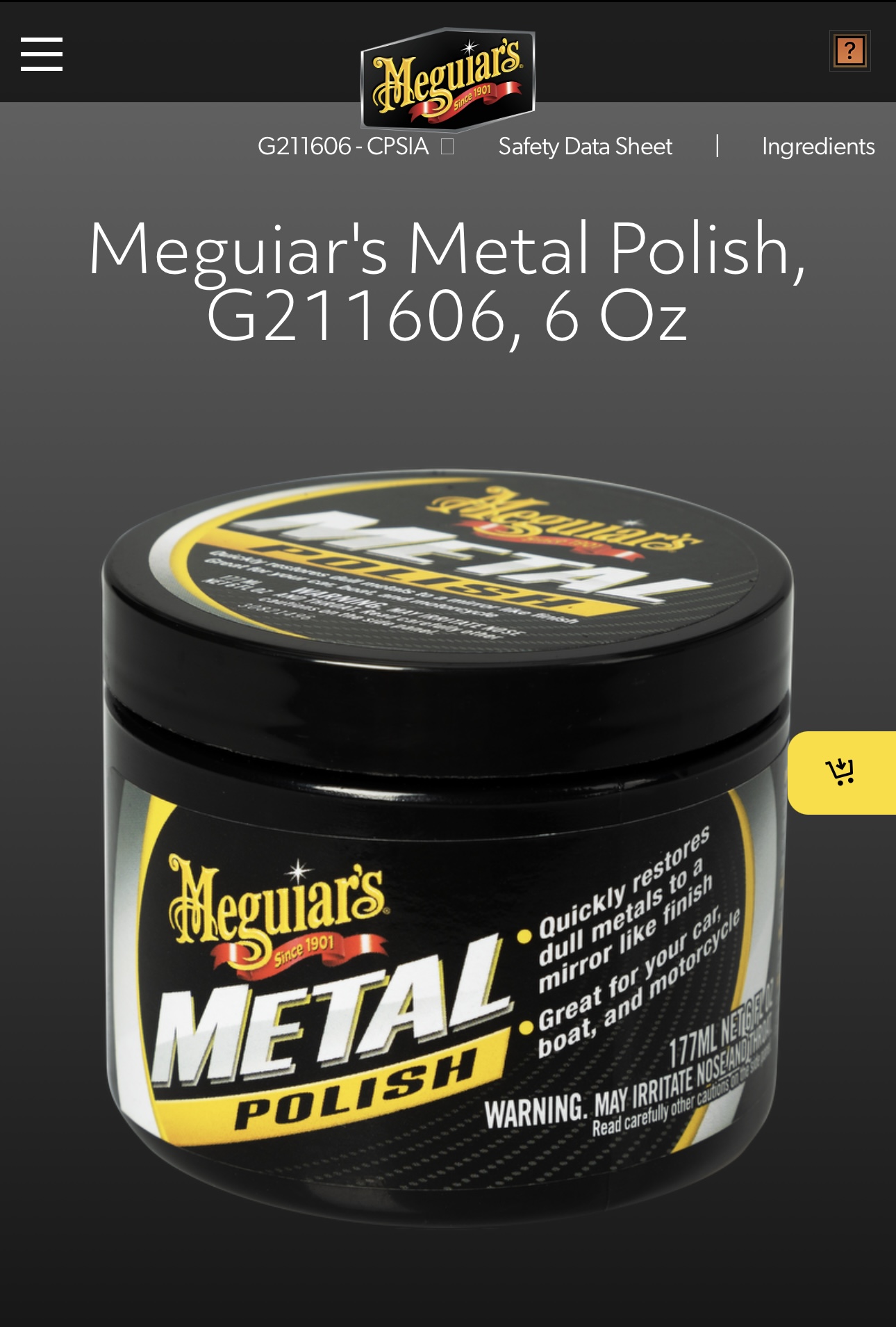

I myself really like working with a cream polish like these…

I start with white polishing compound from Harbor Freight, with a polishing wheel on a Dremel.
Instead of the screw on mandrel, I use the ones made for a cutoff wheel.
Then I use Mothers wheel polish with a buffing wheel on the Dremel.

I went ahead and ordered some Mother's and a Dremel buffing bit kit. Should all be here tomorrow.
I was worried I may have left the shocks in too long when I was doing this. I did (4) soakings, (3) at 5 minutes, followed with a complete rinse each time, and then a ten minute soak to finish things off.
Used toothpicks with electrical tape wrapped around them to seal the hole, to agitate them in the foam, and to check the parts during the process. No damage that I can see. Will begin the polishing tomorrow.
