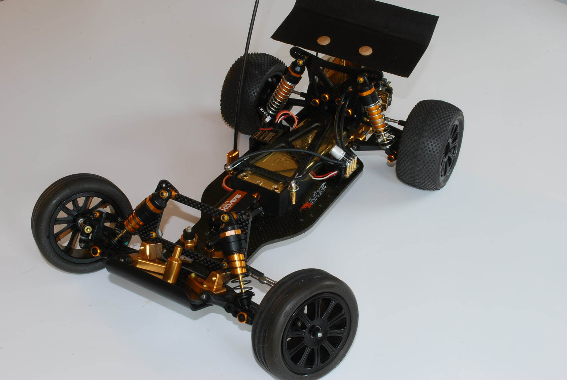

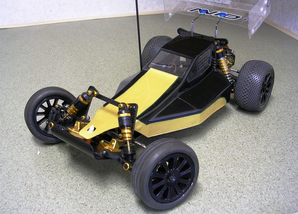

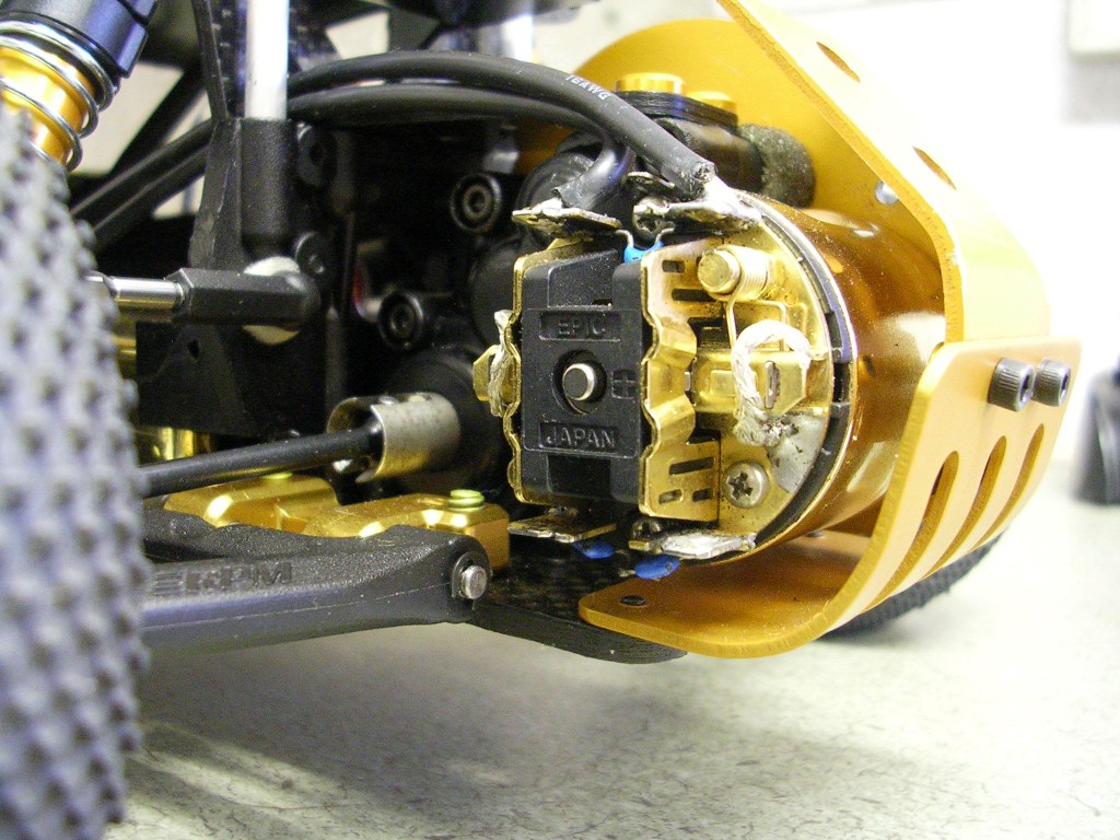

finally got myself a gold can, an Epic 14x2 turn thanks to Rod, who also gave me a donor shell until I get a Viper body for it. He trimmed it for another buggy, which is why there is a narrow nose and just a tab in the back for the post to go through. I was talking to Rod about the body and since the Viper body originally came on the graphite car, I figured I would use one on this build...and it is still available at the stores :D . I just cant bring myself to get Eau Rouge to paint a nice JPS scheme on a Turbo Mirage body with a runner. I don't need to go running onto the track crying when it rolls over.

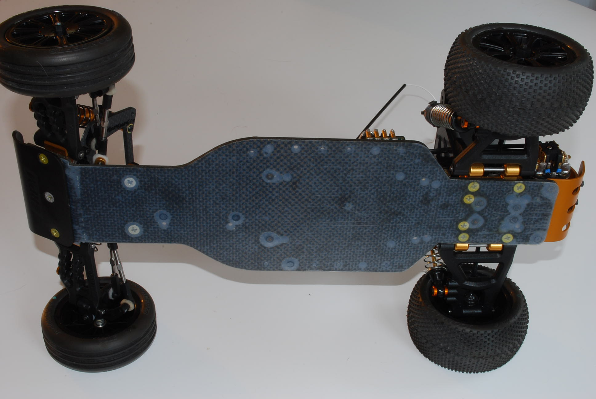

I still need to trim the wing tubes and get home to install my Atlas gold body posts, and apply some chassis protector but that will come

It really does deserve a custom paint job. We'll see once I get the new shell. I wouldn't mind getting a RPM gear cover for it too, but they are pretty rare.

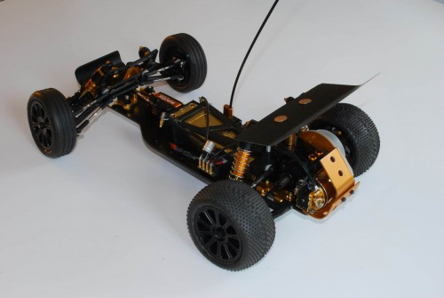

I got a graphite wing from dw911 and my gold posts from Altas on today, thanks guys!
also got the chassis protector on too, nearly ready to go, but with all the rain and crappy weather we are having on the east coast of canada I may have to wait til spring. That will give me time to get a body together anyway.
